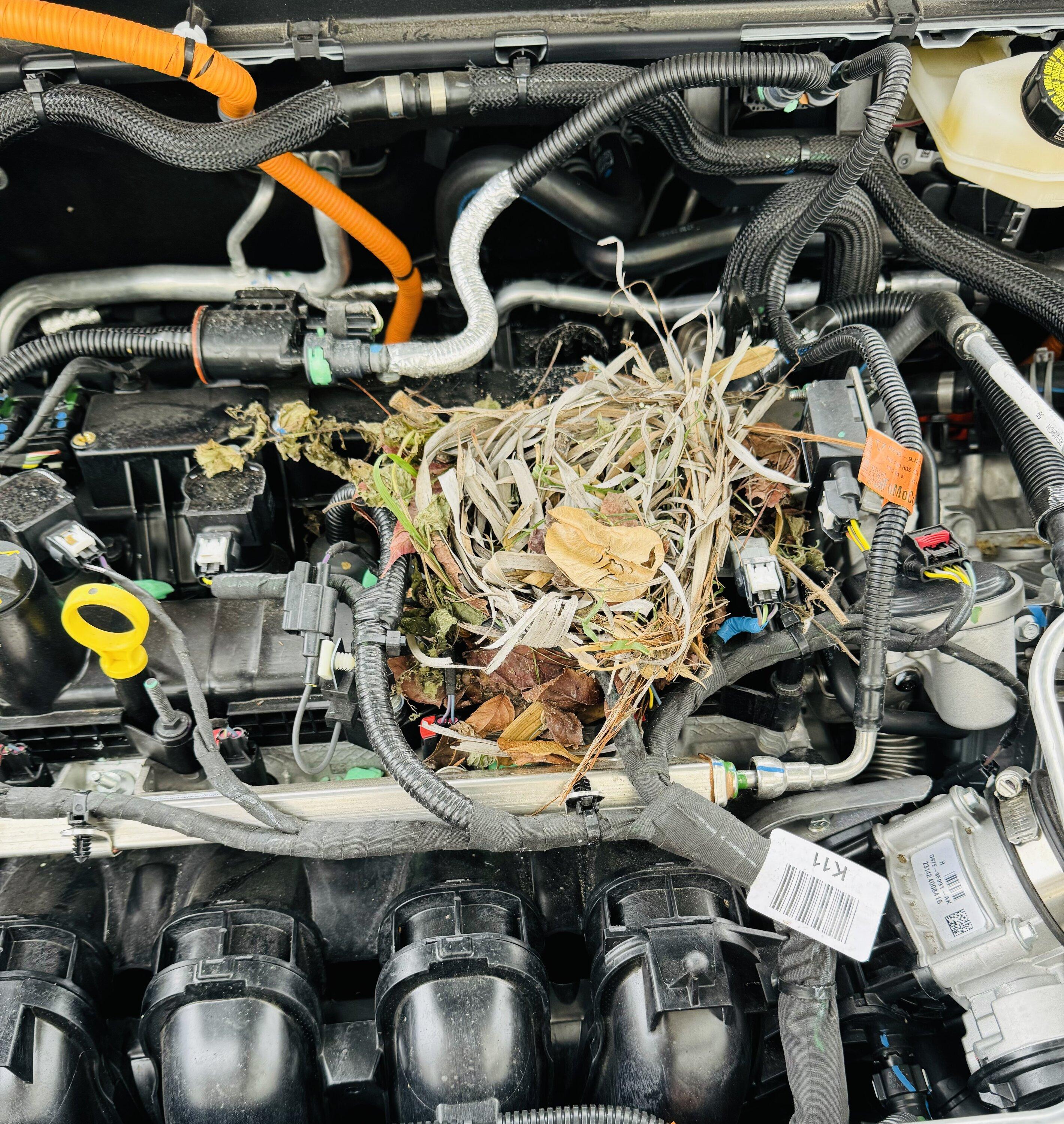

Ford Maverick Dang squirrels chewed through wires! IMG_8632
We had few days of rain and sure enough a rat move in under the hood 😖
Irish Spring soap didn’t work. Neighbor recommends spaying peppermint essential oils. We’ll see 🤞🏻

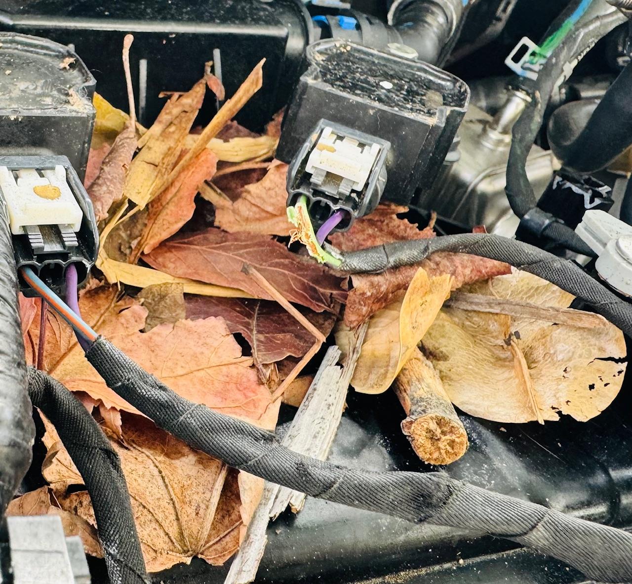

Ford Maverick Dang squirrels chewed through wires! IMG_8638
Next day, the rat built another nest and chewed a wire 😖
I sprayed the engine compartment with diluted peppermint essential oils. I’m also parking the car farther away from the house and facing the street. No visitors since.
This may have been a female rat looking for a spot to raise her young. Who knows.
