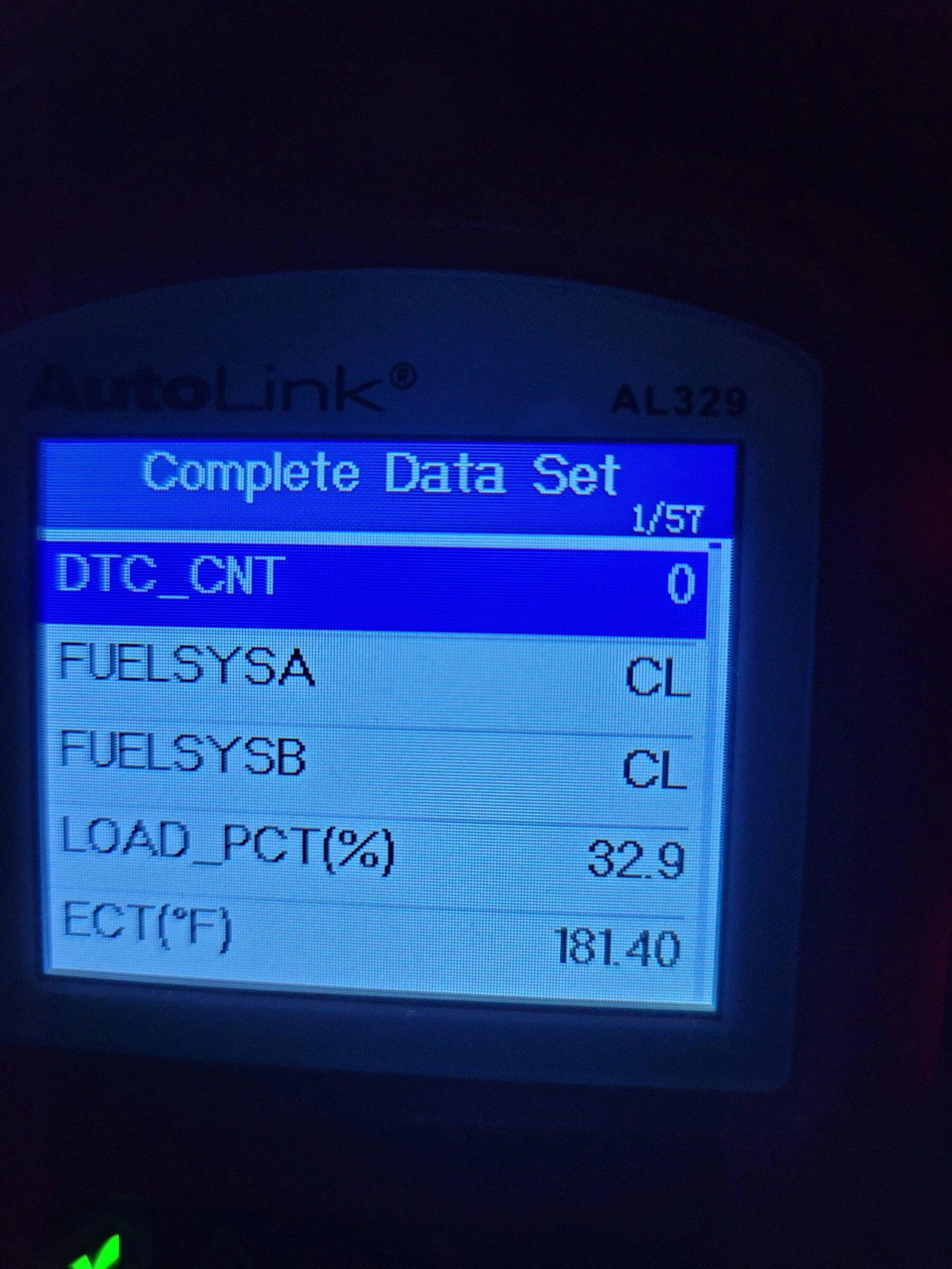

Thats what it looks like, i just bought and odm at wal mart and went for a drive.It also might be that the normal engine temp just naturally straddles the point between the bars on the gauge. But I'd call the dealer.
Huh, didn't really expect that. 4 degrees variation isn't a lot and 181 seems like a reasonable idling coolant temp.Thats what it looks like, i just bought and odm at wal mart and went for a drive.
When there are 3 sticks temperature is 177.80 or below, 4 sticks 179.60, and temperature bounces between 177.80 to 179.60 t0 181.40 while driving, stays steady at 181.40 at idle, now the questions is, whats the engine

Stand alone, it is 17F outside.Huh, didn't really expect that. 4 degrees variation isn't a lot and 181 seems like a reasonable idling coolant temp.
