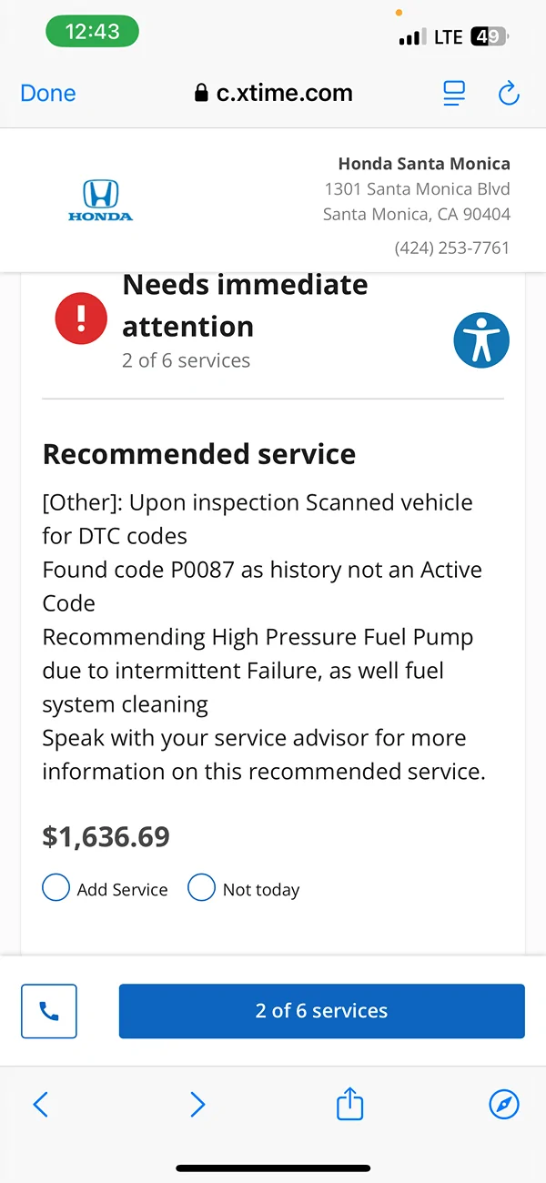

Daughter in Socal had a 'somewhat' similar issue with her 2019 Honda Fit. It quit suddenly on her. Couldn't get it to stay running. She told me she hadn't gotten a dash code (I was skeptical but chose to believe her). Took to Honda dealer. While she was being towed I asked her - "shows there is a low pressure fuel pump recall for your car, did you ever get that done?" I got the expected answer ("yeah I remember getting something in the mail about that, sort of forgot about that...").
At the dealer they did find a P0087 code in memory (in history, not active, so I guess that can happen). But sadly tried to sell her a HP fuel pump replacement (and infamous "induction cleaning service") before even mentioning the need to do the LP fuel pump recall.
Ford Maverick Ecoboost runs 5 seconds and shuts down - rodents chewed through wires Fit1
I advised her - tell them to do the friggin' recall first, and then see how (or if) it runs, any new codes, etc. They did that (could be accessed/replaced by dismantling the center console, didn't have to drop the gas tank, took a couple hours). Seemed to fix things.
You do have to be real careful these days that you're not flagged as someone being gullible in the ways of the auto repair world. Other advice to daughter was, in Socal must be a gazillion independent Honda repair places, ask your friends and find one and go there next time.
