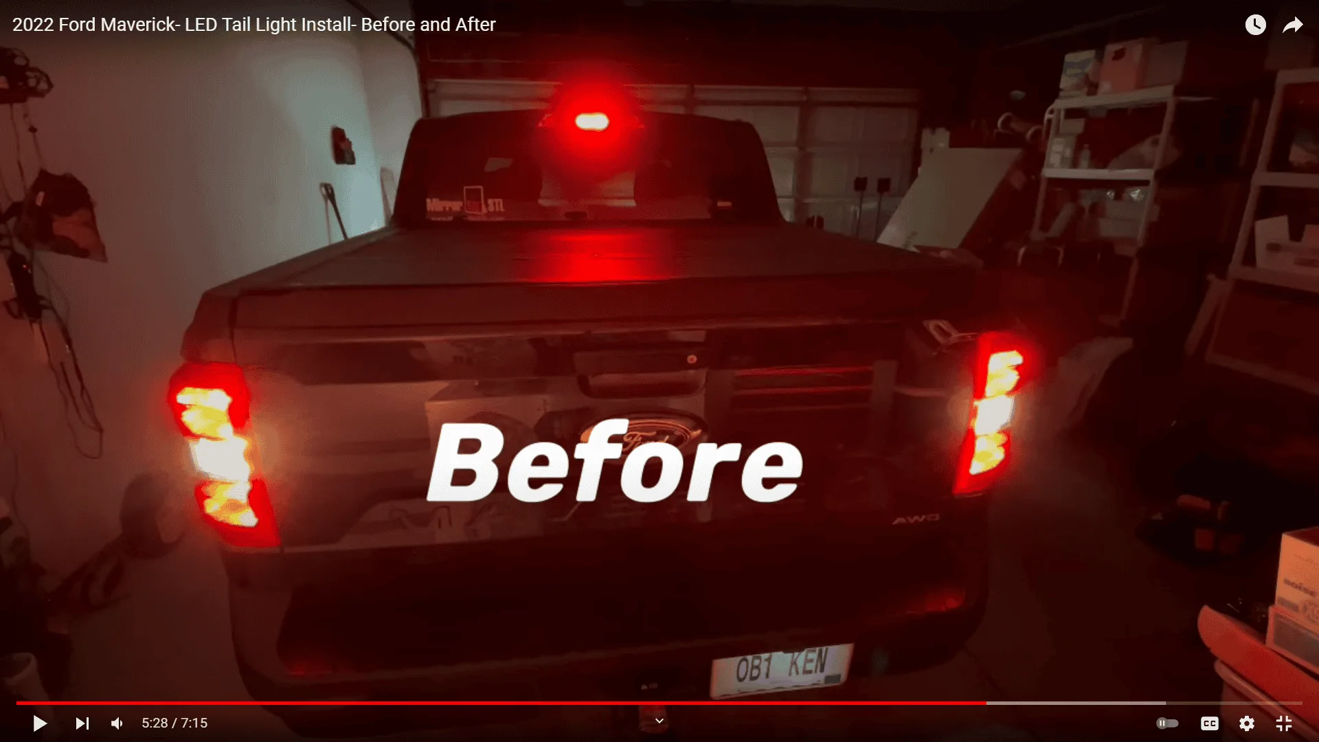

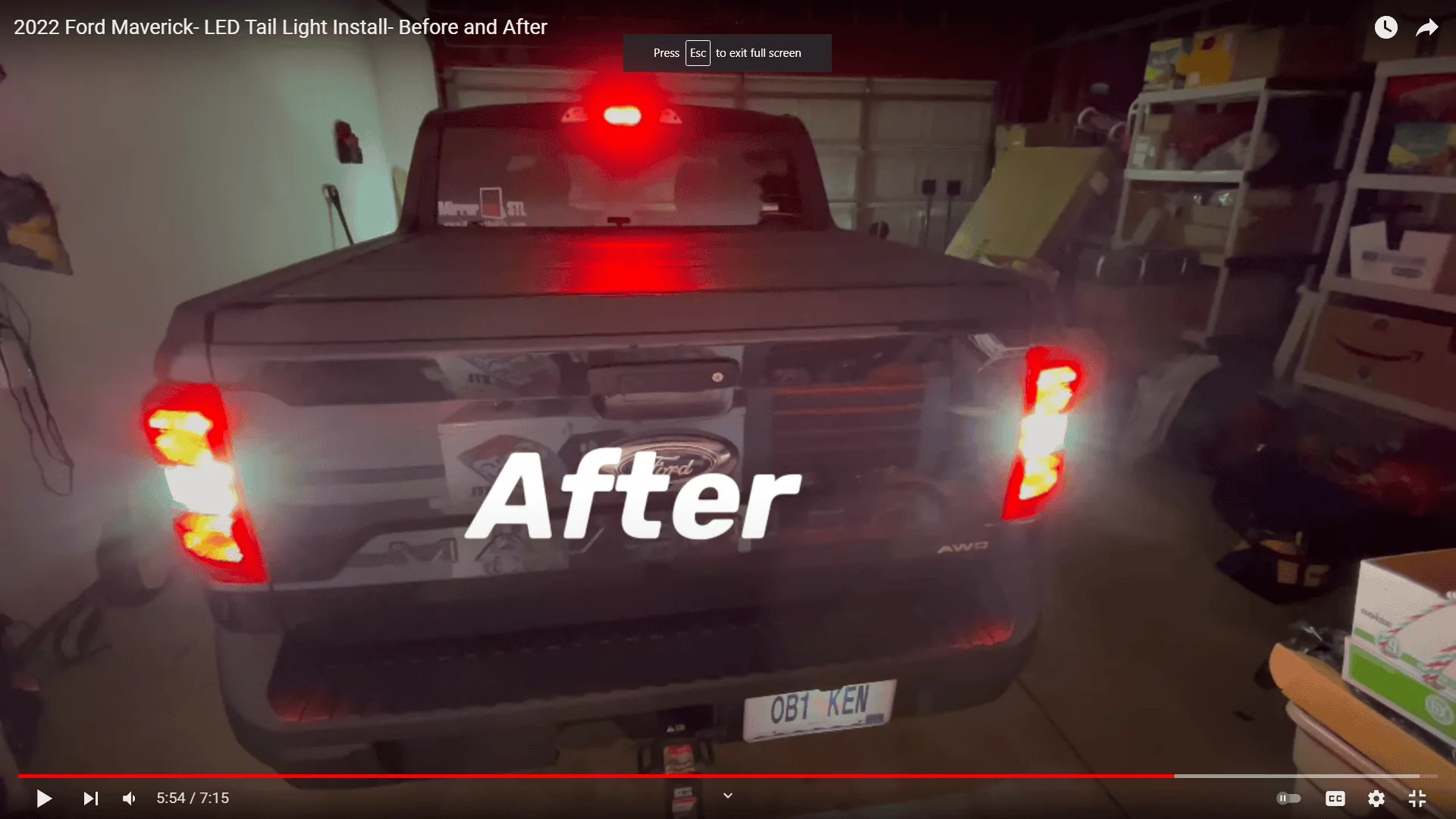

I did this no difference in the camera at all that was disappointing
Has anyone else done this and seen a difference in the reverse camera at night? Since that is kind of the point of this mod, right?
Also here's screenshots that may help for comparing how much more lit the surrounding garage area gets:
Ford Maverick DIY - Maverick LED tail lights upgrade. Before and After Video 1638564083485
Ford Maverick DIY - Maverick LED tail lights upgrade. Before and After Video 1638564108119
