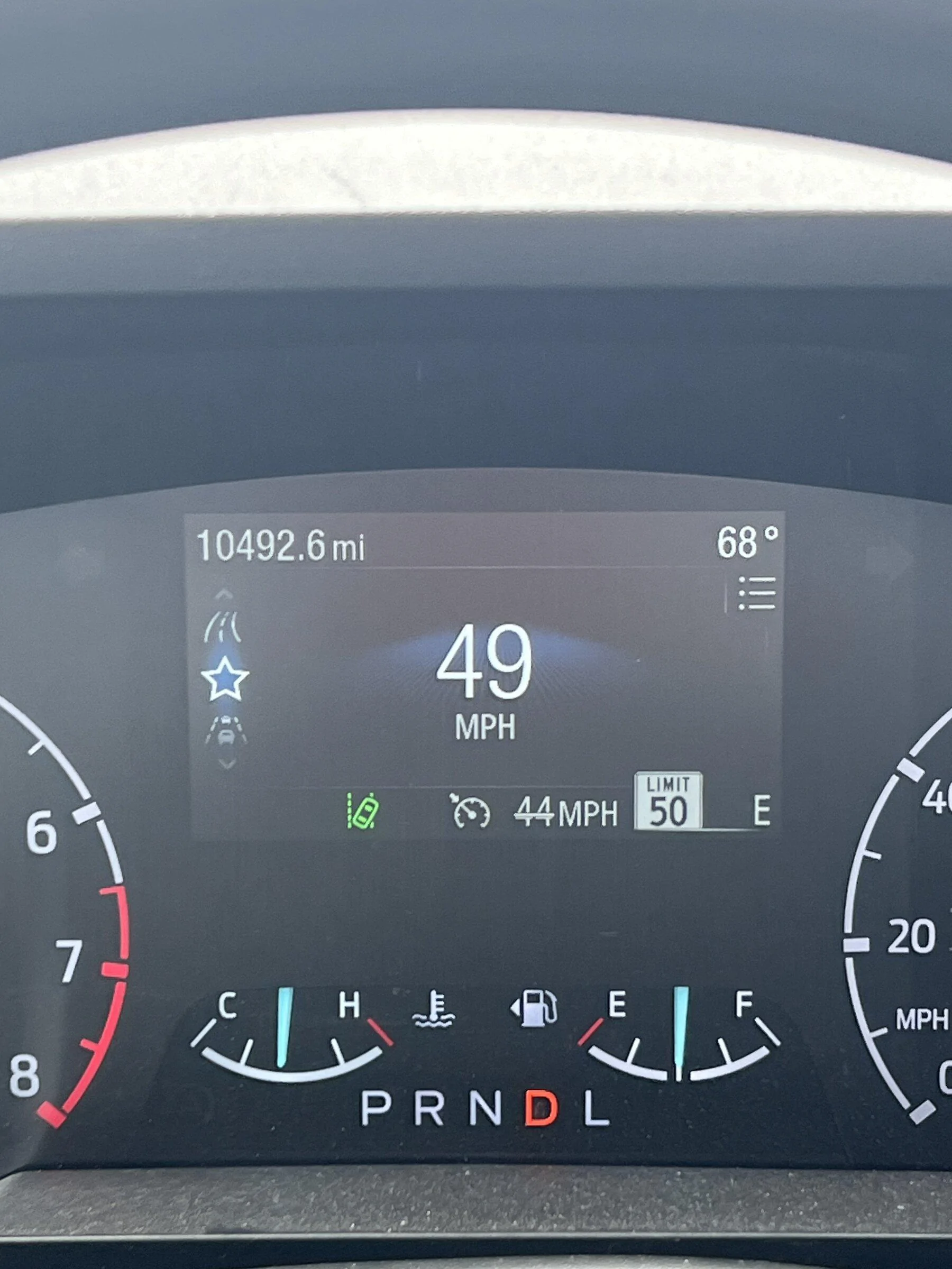

MW_. How did you get the speed limit sign on your dash next to 44mph?

Just finished installing this and worked like a charm. Just wanted to say thank you to all those who wrote up the instructions and the pioneers who discovered this mod. Really appreciate it guys. Cheers.
@mw_maeve - How did you get the little speed limit sign next to your CC info to display? I've tried to find info about it in the manual and on the net, but had no luck. Inquiring minds want to know...
It's another Forscan mod. Search the forum.

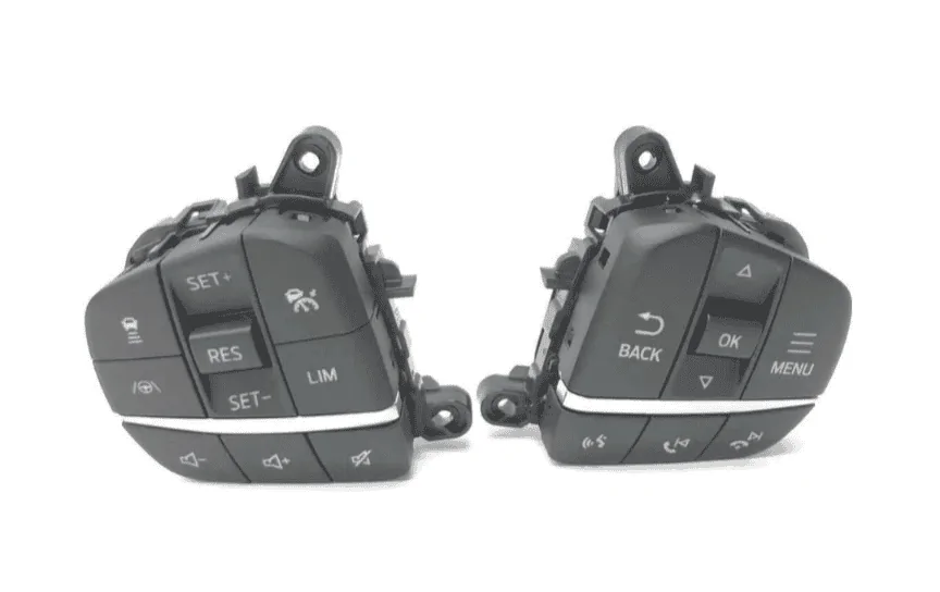

I think I need some help with my XL. I've used forscan multiple times with past Ford vehicles, as built, but I'm having trouble getting anything working on my Maverick.
It's an XL EB FWD with the factory tow package. I've purchased the Lane assist turn signal stock as well as theses ACC buttons from an upper trim level 2020 explorer. Read through all of the threads for activating CC, lane assist and even TSR but nothing is working. The left steering wheel button lights up but none of the buttons are functioning, including the volume controls. Any assistance would be greatly appreciated. Here is my VIN if needed: 3FTTW8E91NRA52696

I am no expert but I think the switches are the problem. I added switches for CC only, not ACC or lane assist. I am not sure either are possible on an XL. TSR should be unrelated to the switches and should be a simple enable in Forscan.
