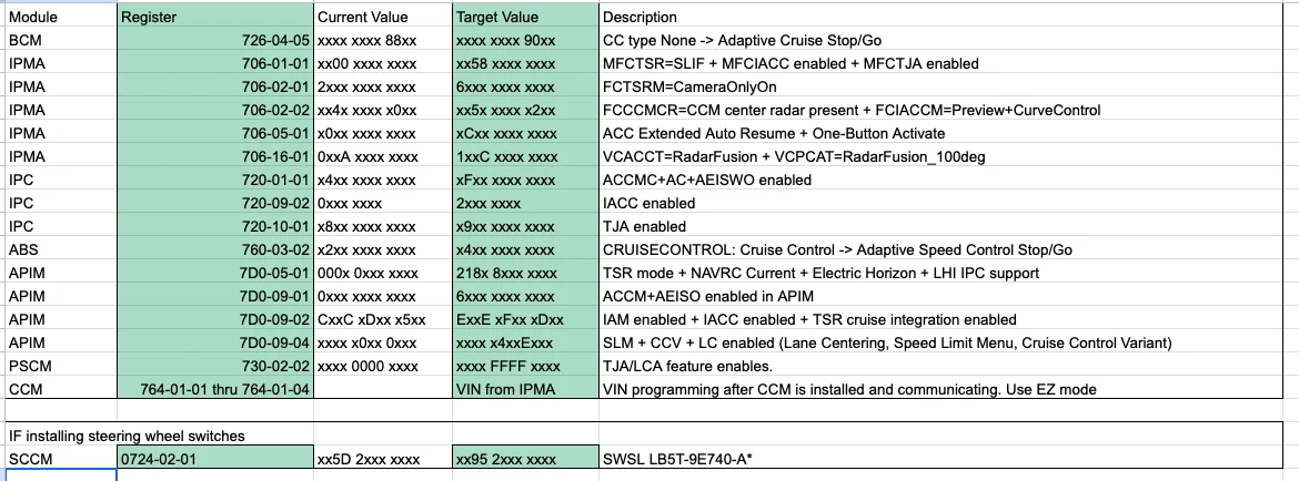

Right, only a handful of us have attempted. If anyone can send me saved XLT asbuilts from the modules in my list, or the full file from the motorcraft website, as well as XLs with other options than mine I can take a crack at solving this.

The module list is on the left column of this table.

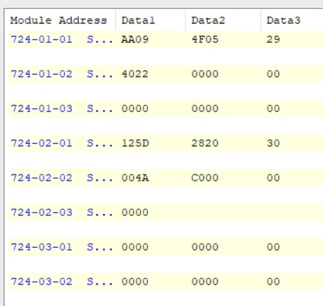

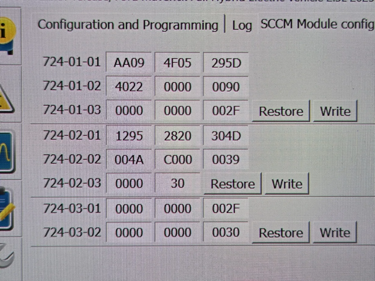

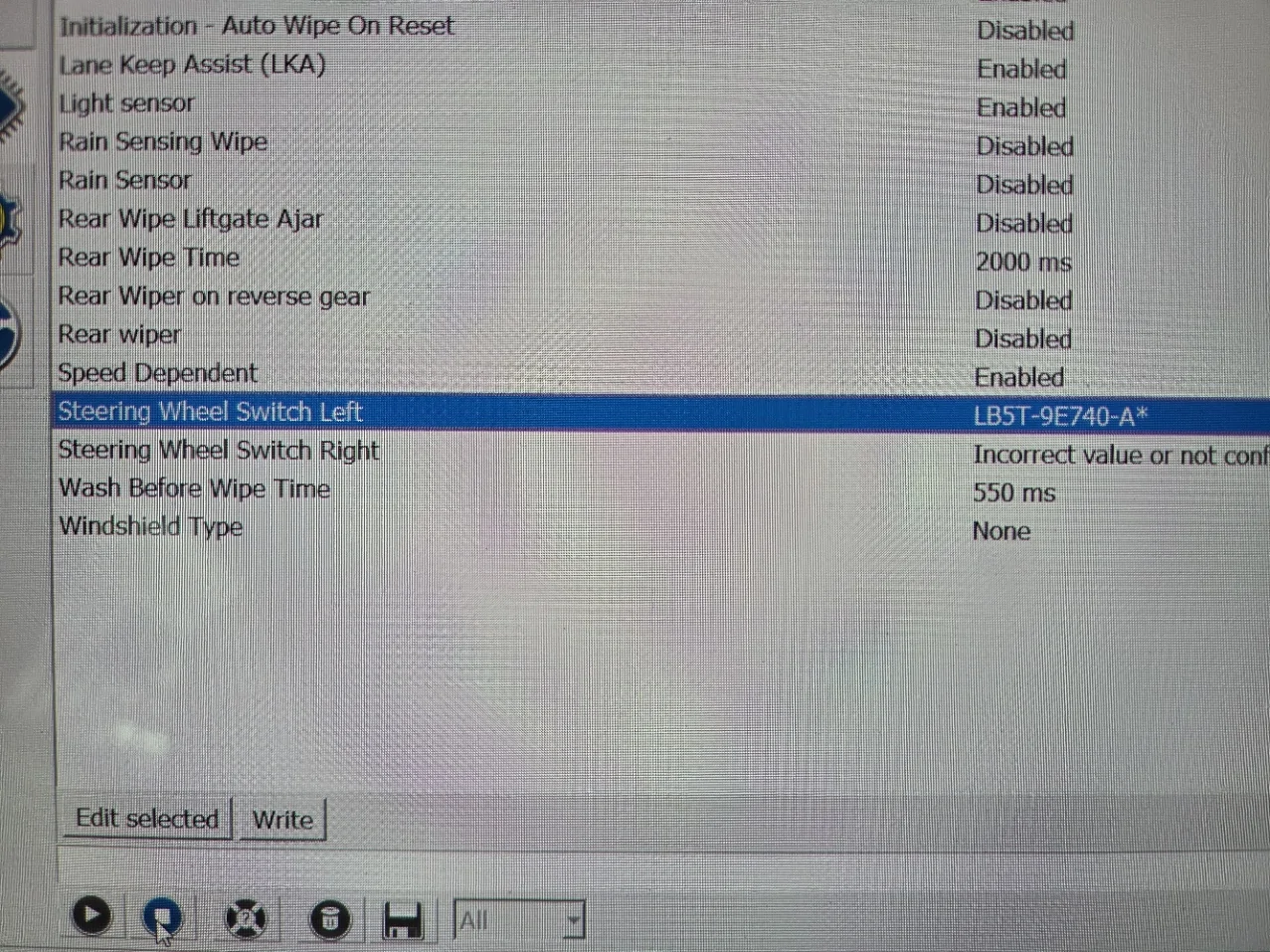

I just tried this, and it doesn't work on mine. I get a code for LH switch pack failure, and none of the LH switches work.
Strange enough that is the same config that I chose a while back, so it should have been the correct one.
If you dont mind, may I see your SCCM save? Current and old one as well if you have it.

Old/stock =
Adjusted =

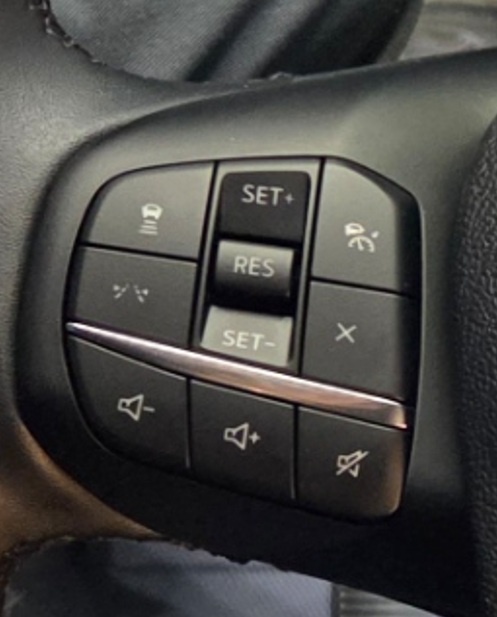

Thanks. Without knowing anything else, I gotta ask are you sure you have the same steering wheel switch as I do?
If so, I’m stumped. Your before and after on the whole pic matches mine. When I get a Chance I’ll look into EZ mode of mine and see if that also matches. I also wonder if there’s another change from my list you haven’t performed? Wouldn’t make much sense but this whole process was kind of a headache lol.
