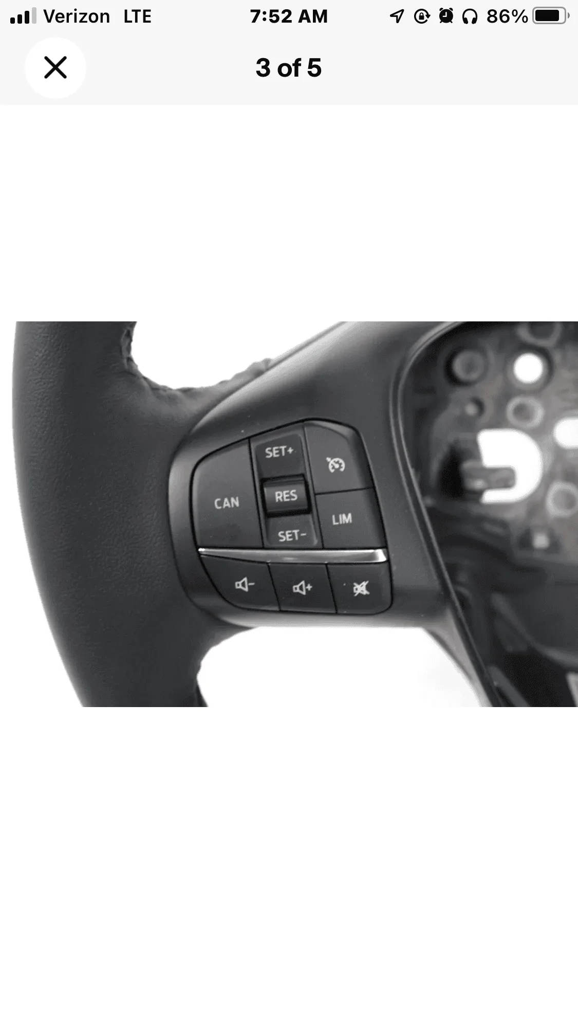

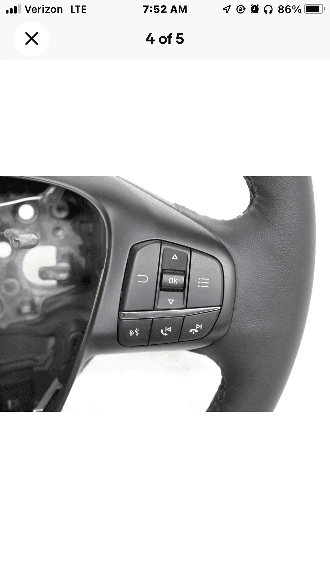

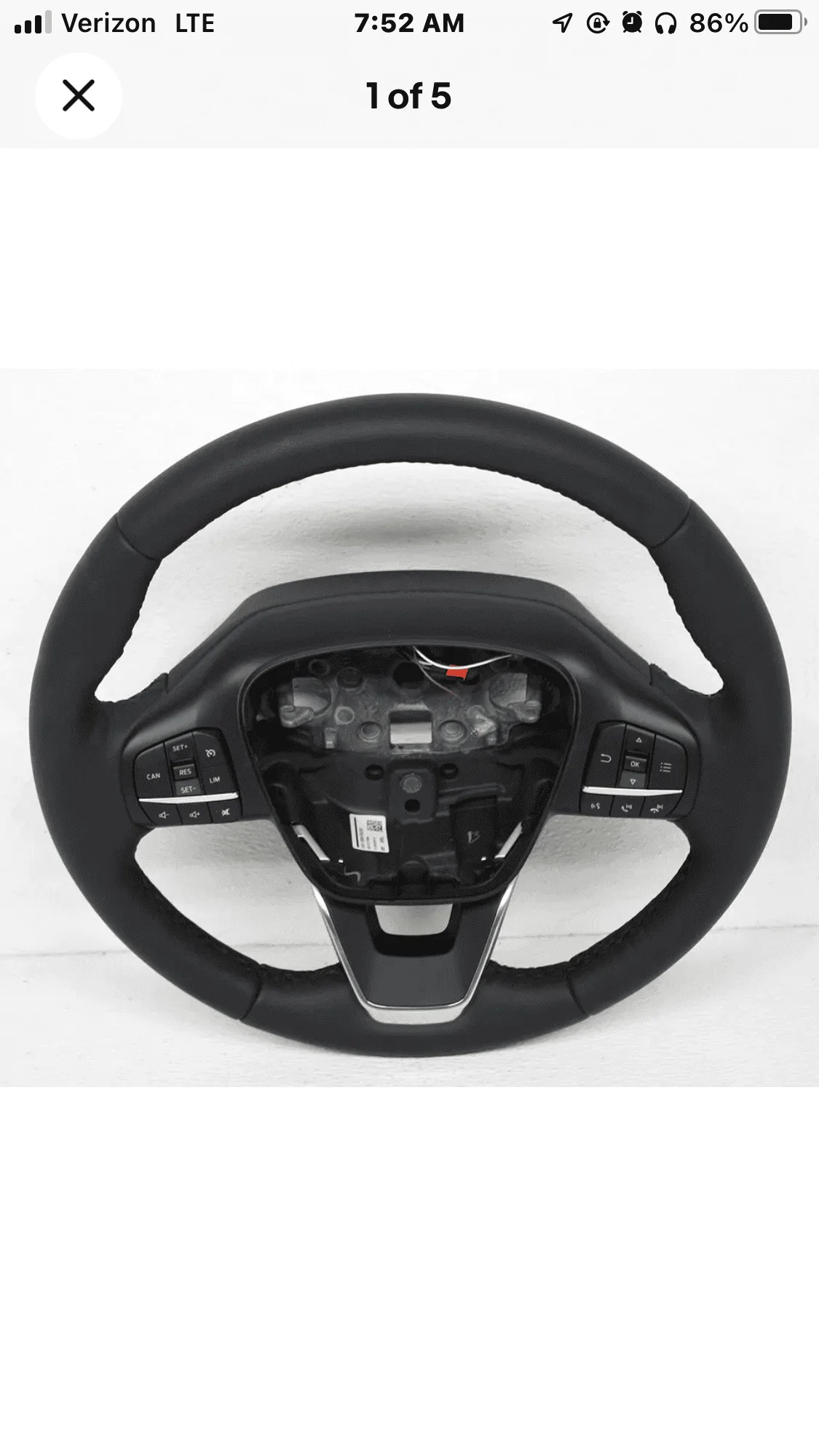

Can someone tell me the codes that I need to get the limiter to work with these switches? If not, can someone please tell me what the best ones are for it to work the cruise without it? I have a XL plan, the only add was the hitch. Thank you in advance!
