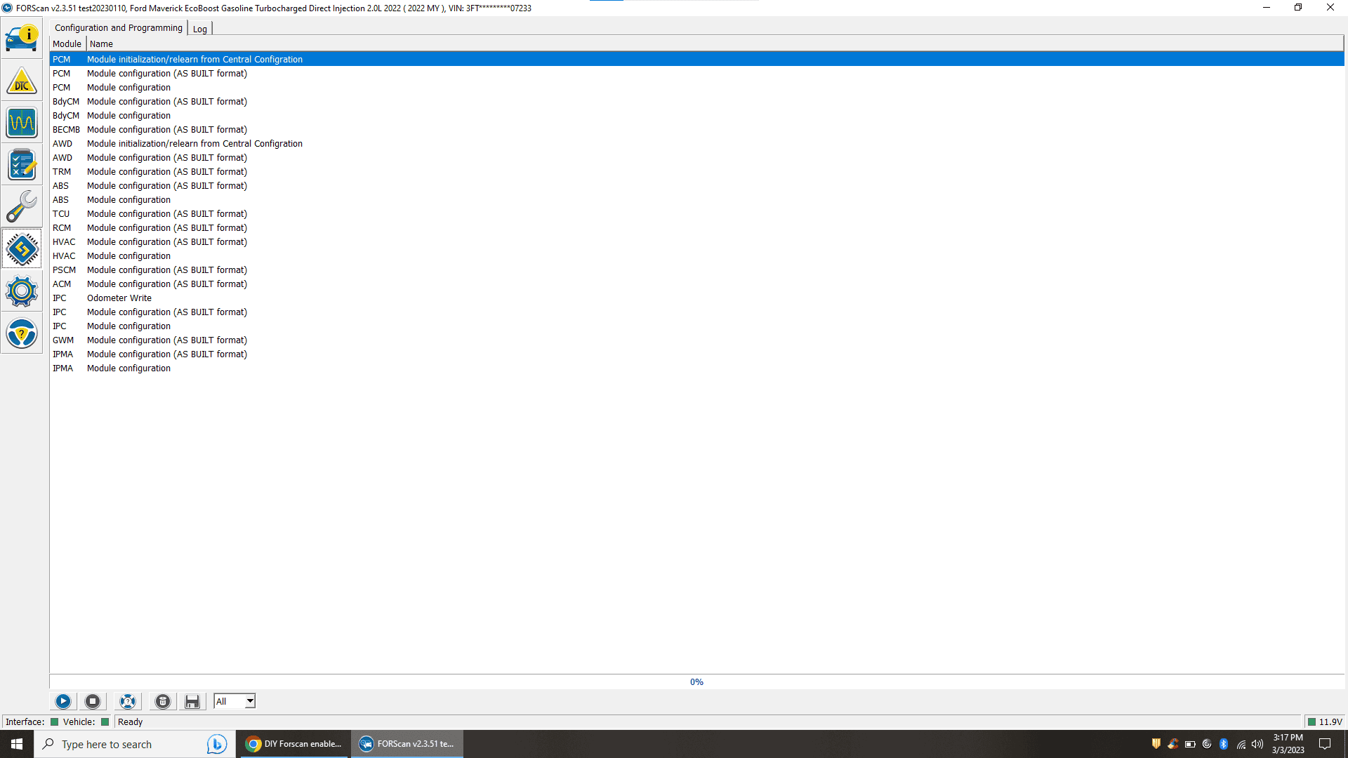

My SCCM modules are not showing up in Forscan. Has anyone had this issue? Any ideas how to fix it? Thanks

I have not tried that....just tried it, no change.

Ford Maverick DIY Forscan enabled Cruise control XL models only 1677874706520

Trying to use the free trial. Should I purchase a license?

Update: I was able to figure out why the SCCM module was not showing up. I was using the newest version of Forscan, 2.3.51 released on February 21st, 2023. After some research, I uninstalled this version and went back to 2.3.49 released on October 19th, 2022. It instantly populated the SCCM module so I was able to complete the cruise control installation on my 2022 XL.
