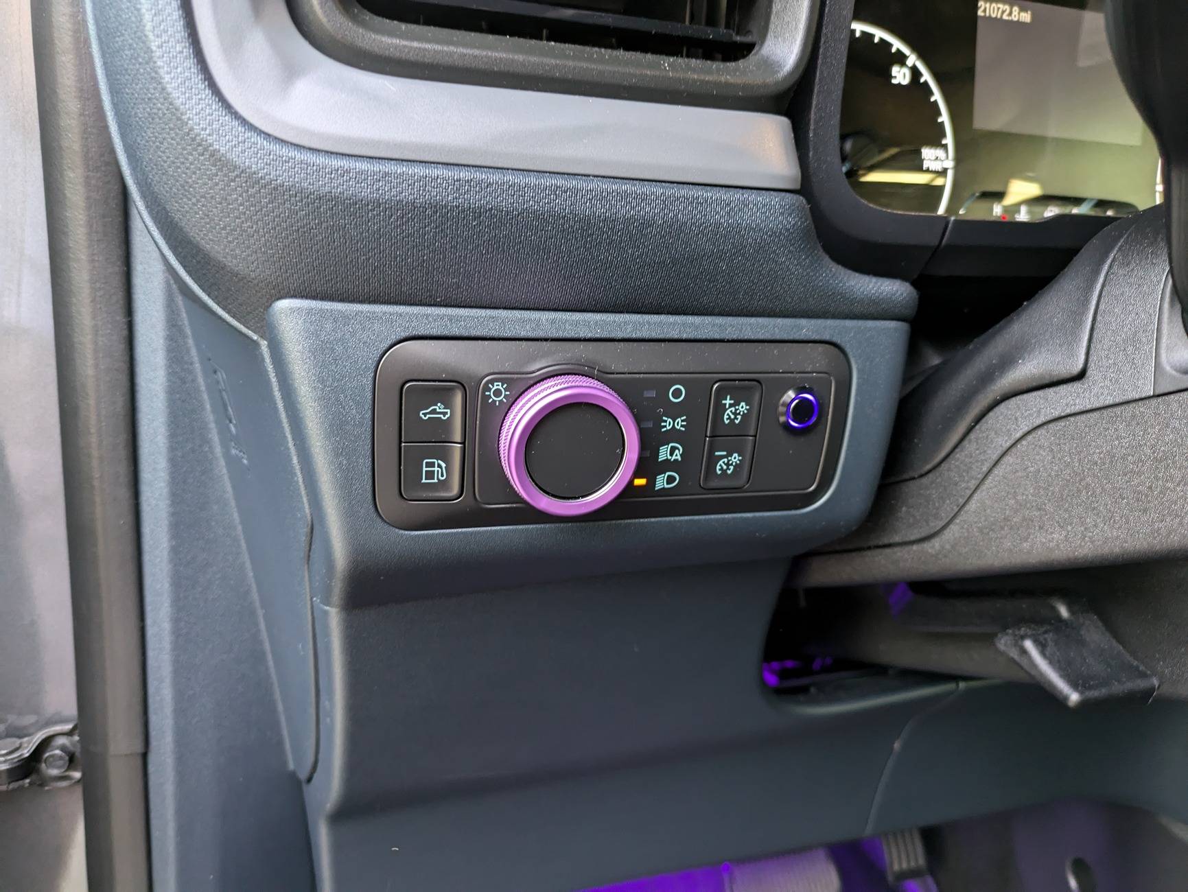

Nice job with the switches! I added a lighted push button in the headlight panel.  I also left room to add a second switch.
As a person who has used and has to continue to use FORSCAN to add cruise control to his 22-XL, I too was apprehensive to add the F150 switch. Every time there is a recall done, I have to renew my FORSCAN license just to re-enable cruise (three times this year!) For me, it is easy (now!) but I also didn't want to have to "enable" one other thing when an update is done.
I think this push button setup is exactly the way I want to go, though I’ll probably throw the second switch in at the same time just to make sure I space things out right for more lights later. That looks clean. Nice work!
