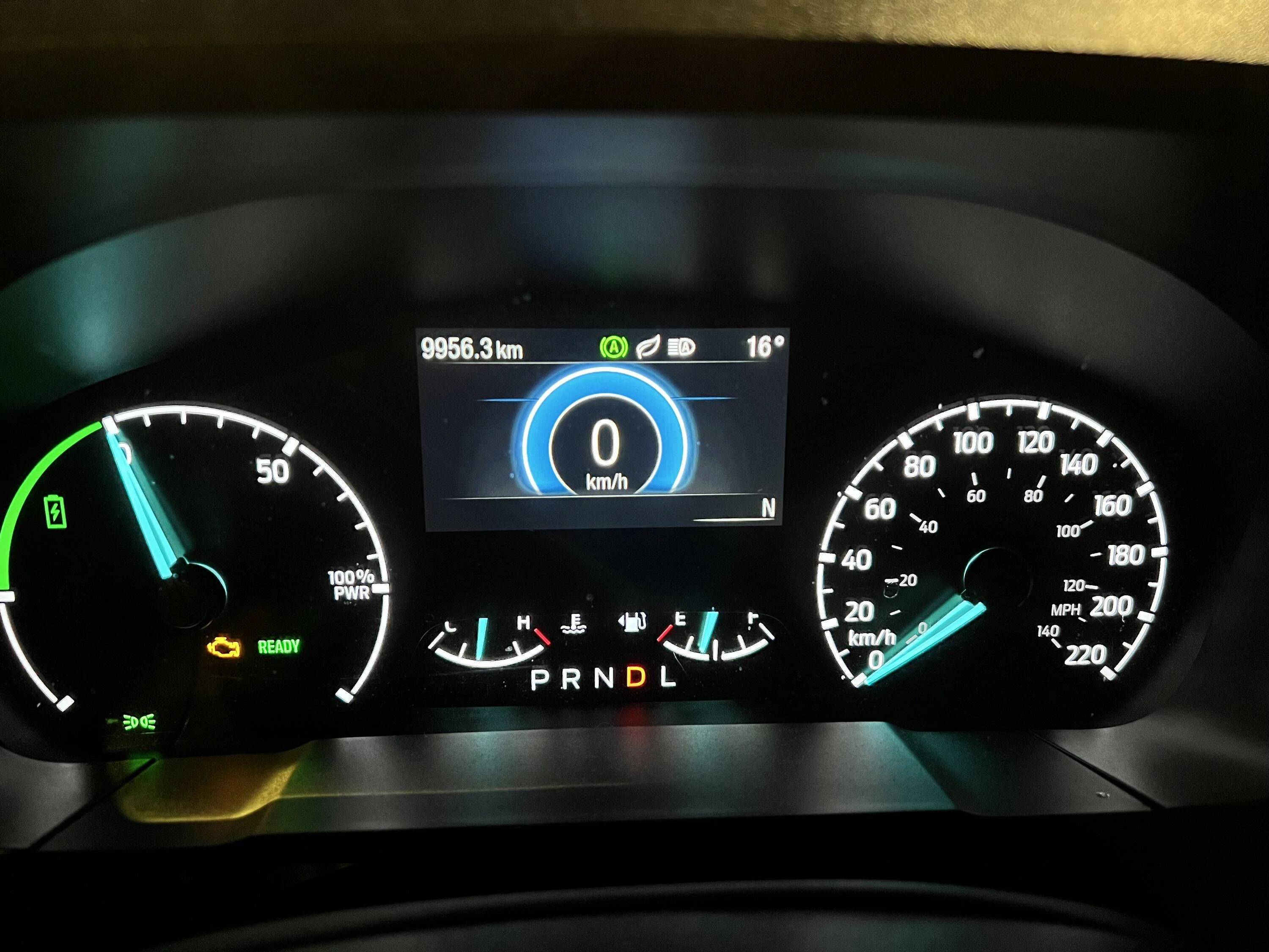

Looks like you were right. I realized after you mentioned it that the drive mode indicator wasn’t showing for any of the drive modes. Just like in normal.
Now that I’ve returned it to factory it shows again.
I wasn’t able to locate any of the drive modes in IPC.
So for now back to button select. Let me know if you find a way to make it work.

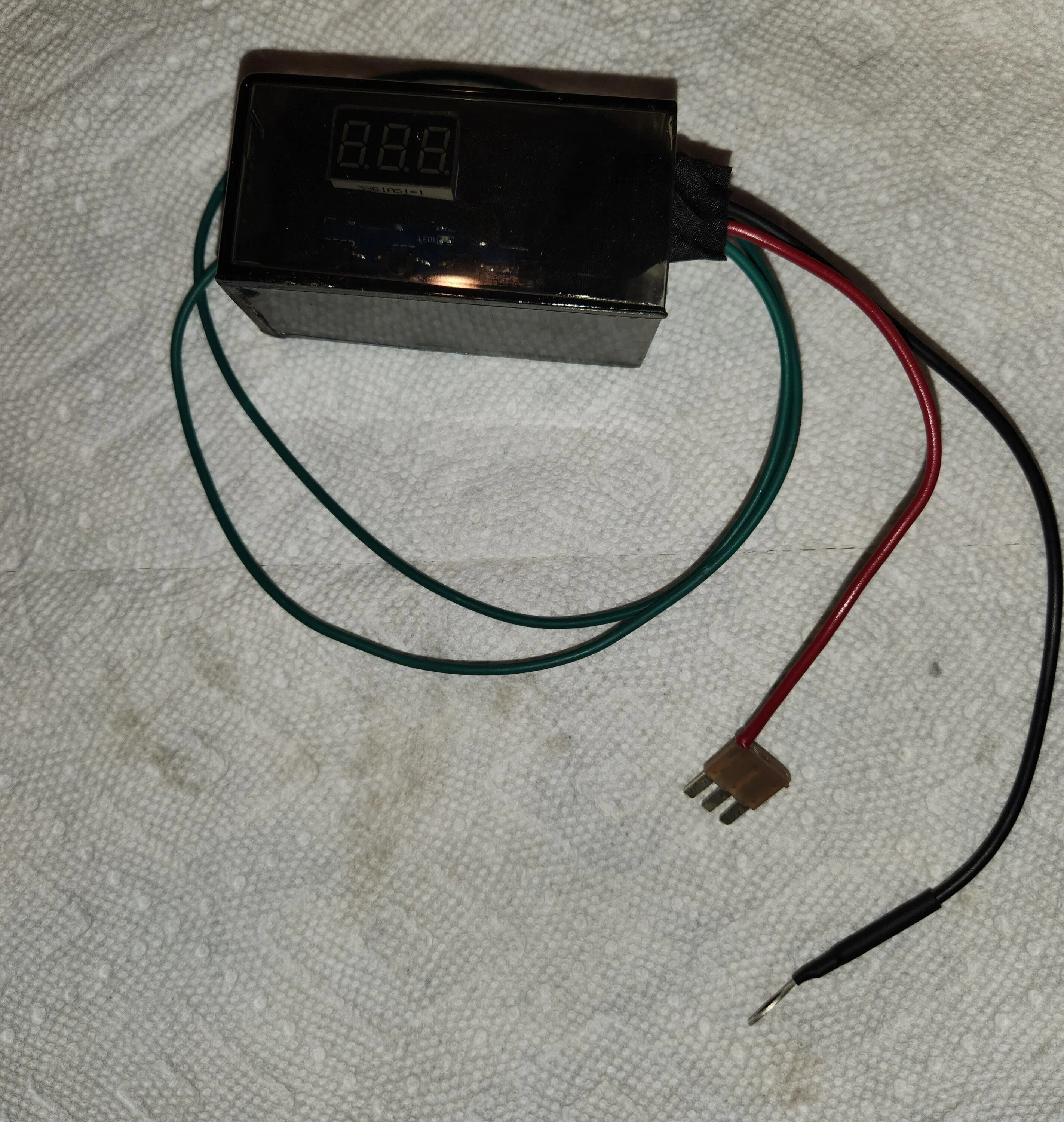

Here is my solution, also using a Fet to switch ground, so no clicking:
Ford Maverick Default to Eco-Mode with this DIY  Module 20230512_001957
Replaces the unused micro3 fuse 1/2 and uses the ground terminal in the fuse box. The module enclosure is small enough to fit right in the fuse box.
Two wires run to the cable harness in the center console. Takes about 5-10 minutes to install.
Power on the key, after 5 seconds the auto stop button is pressed and the driver mode is selected (5 pushes for Eco).
Works like a charm so far.

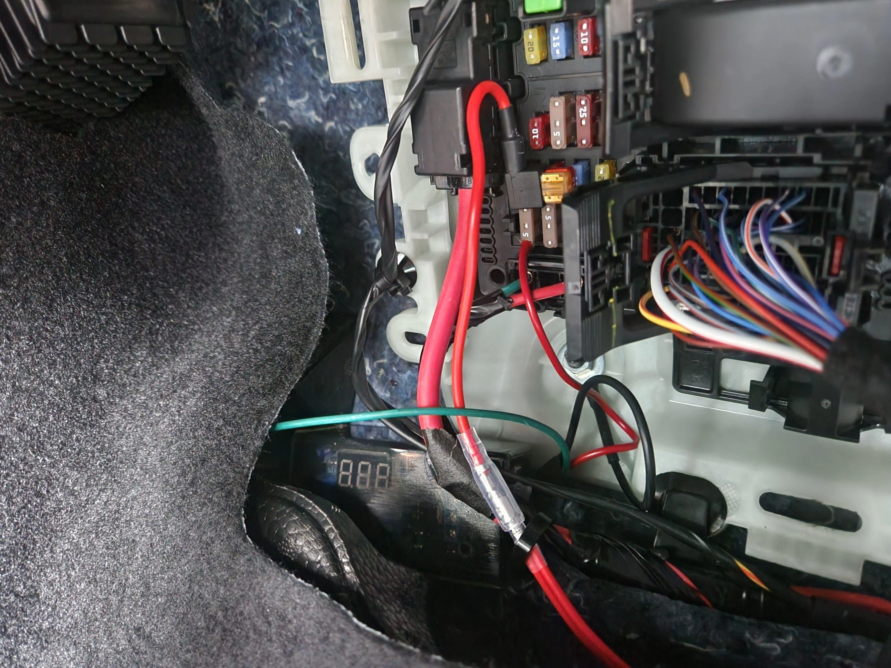

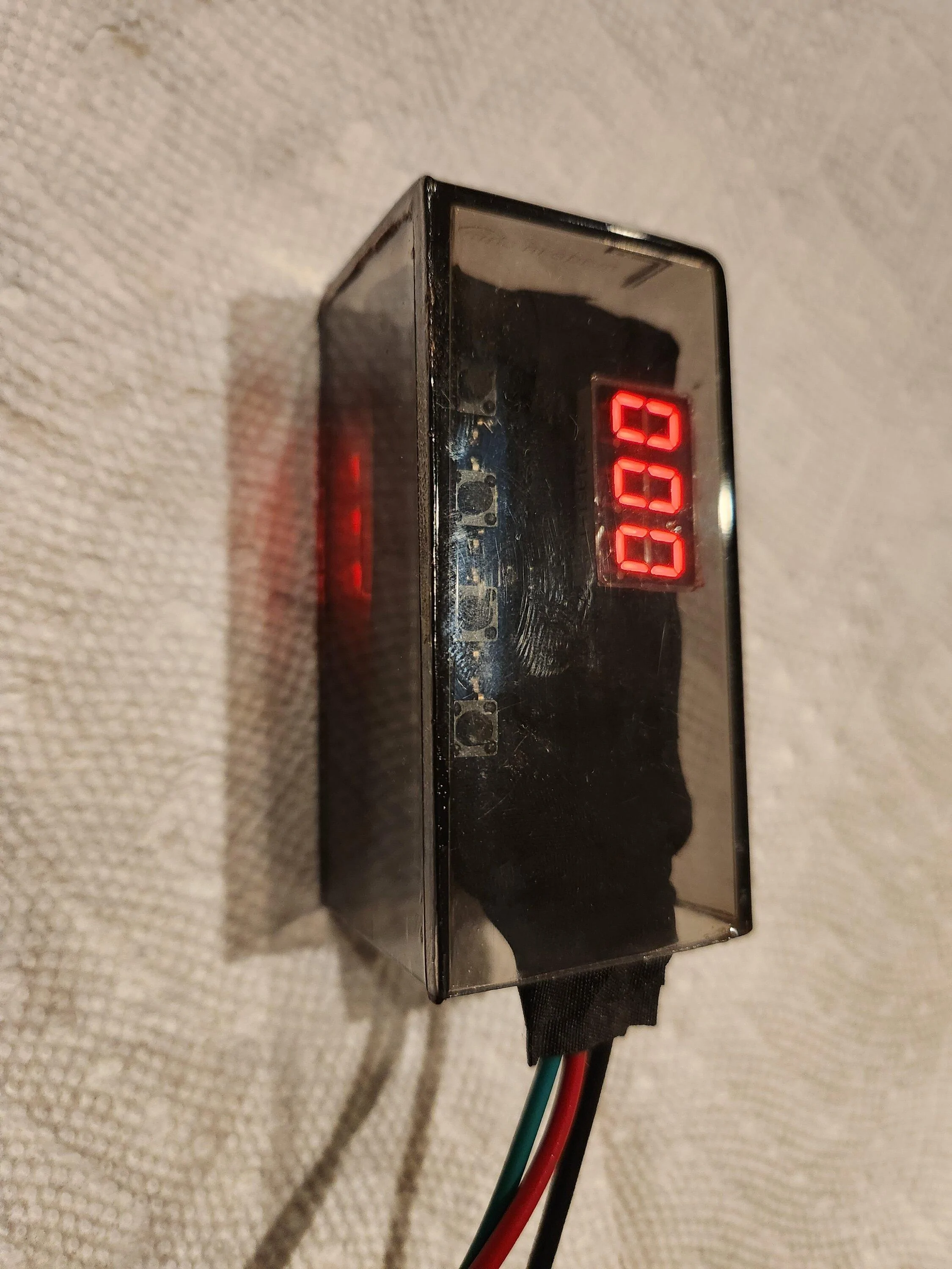

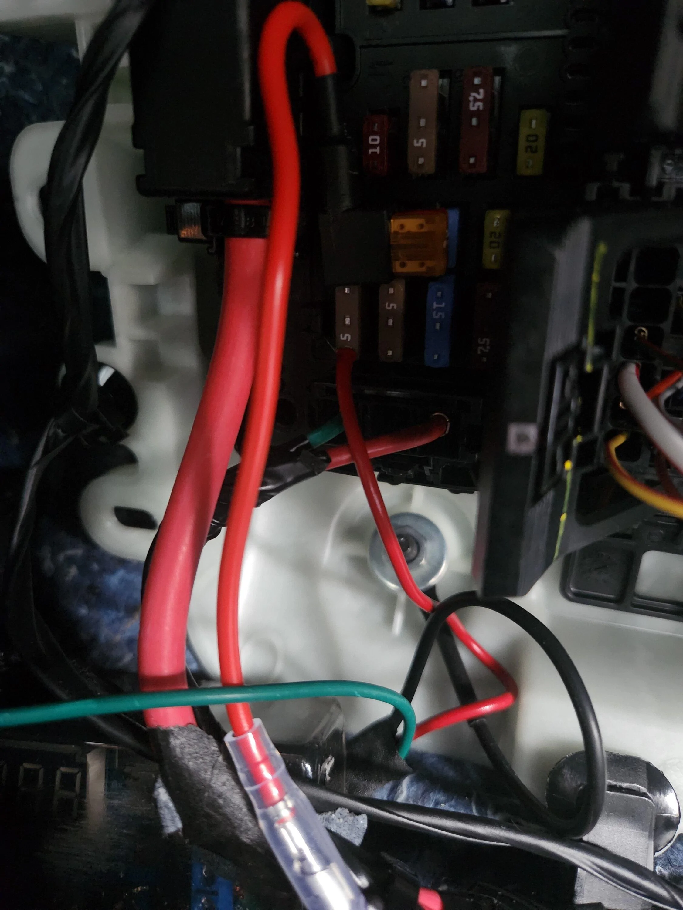

Installed and working.

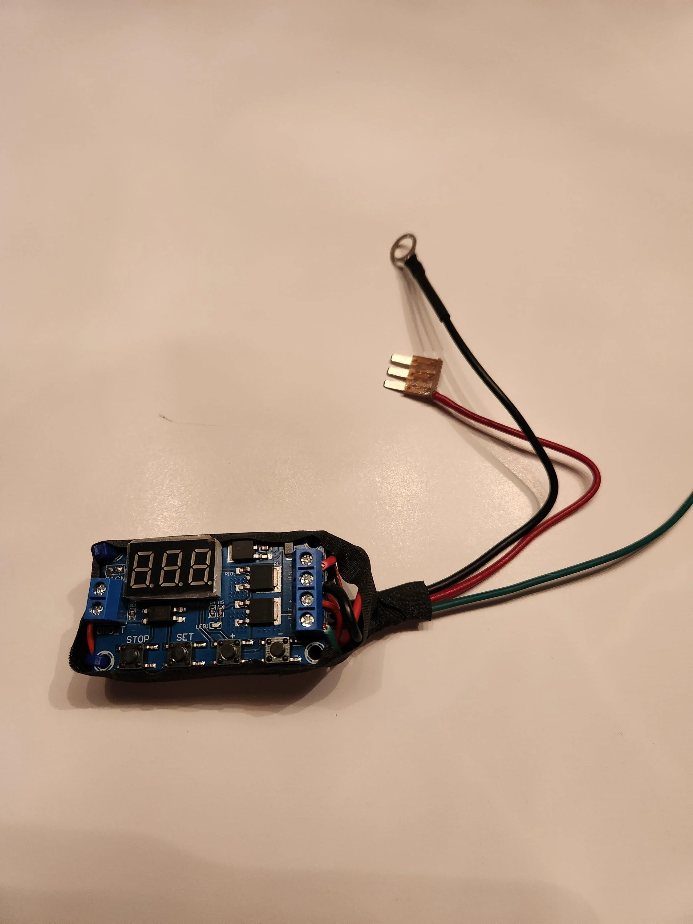

I just got this one ready for a forum member. Been testing mine for a few days, working great. I still have parts for a few more. Takes 10 minutes to install.
