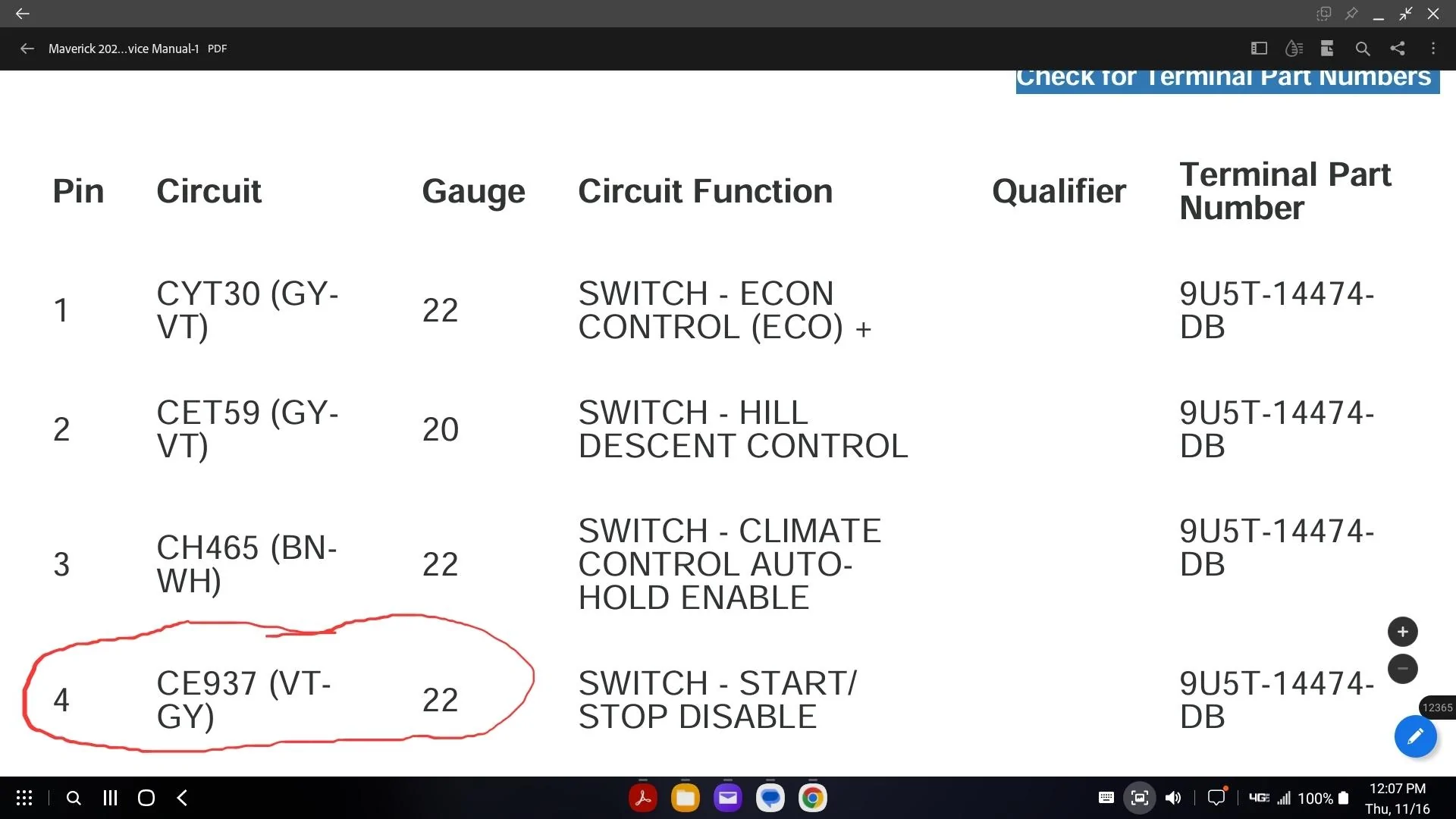

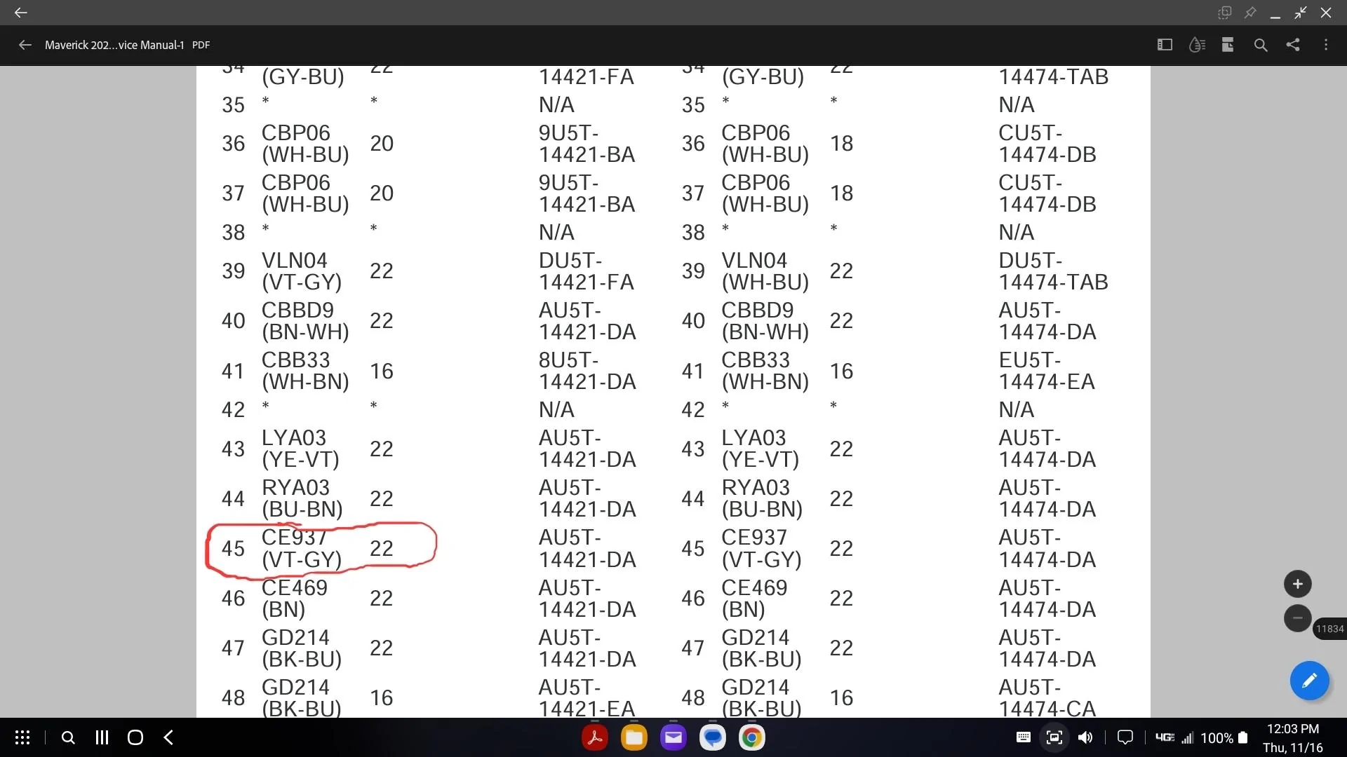

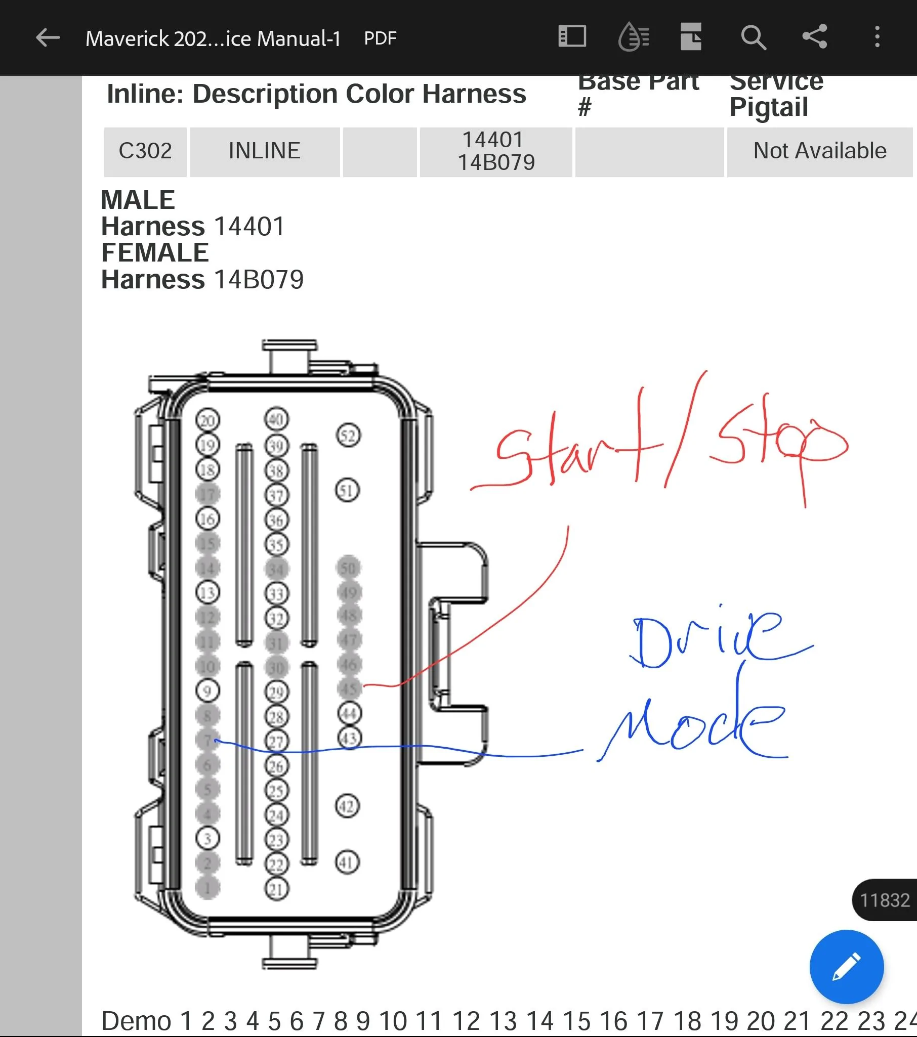

Your circuit grounds pin 4 of connector C3010, correct?
And if I remember correctly, the brilliance is that you read the output of the LED light to verify that it was turned off (well, on).
So when I follow pin 4 to connector C302, it looks like it should be pin 45.
I don't have an EB to test it, but someone told be they tried grounding that pin, but it did not turn off the auto start/stop.

I’ll have to look. I recall in the CubanRedneck’s video that something didn’t work if you tap at the main harness, something about the resistance not being the same as right at the switch. Watch that and see if that syncs up.
I do tap right at the button switch block, so I didn’t run into any of that.
