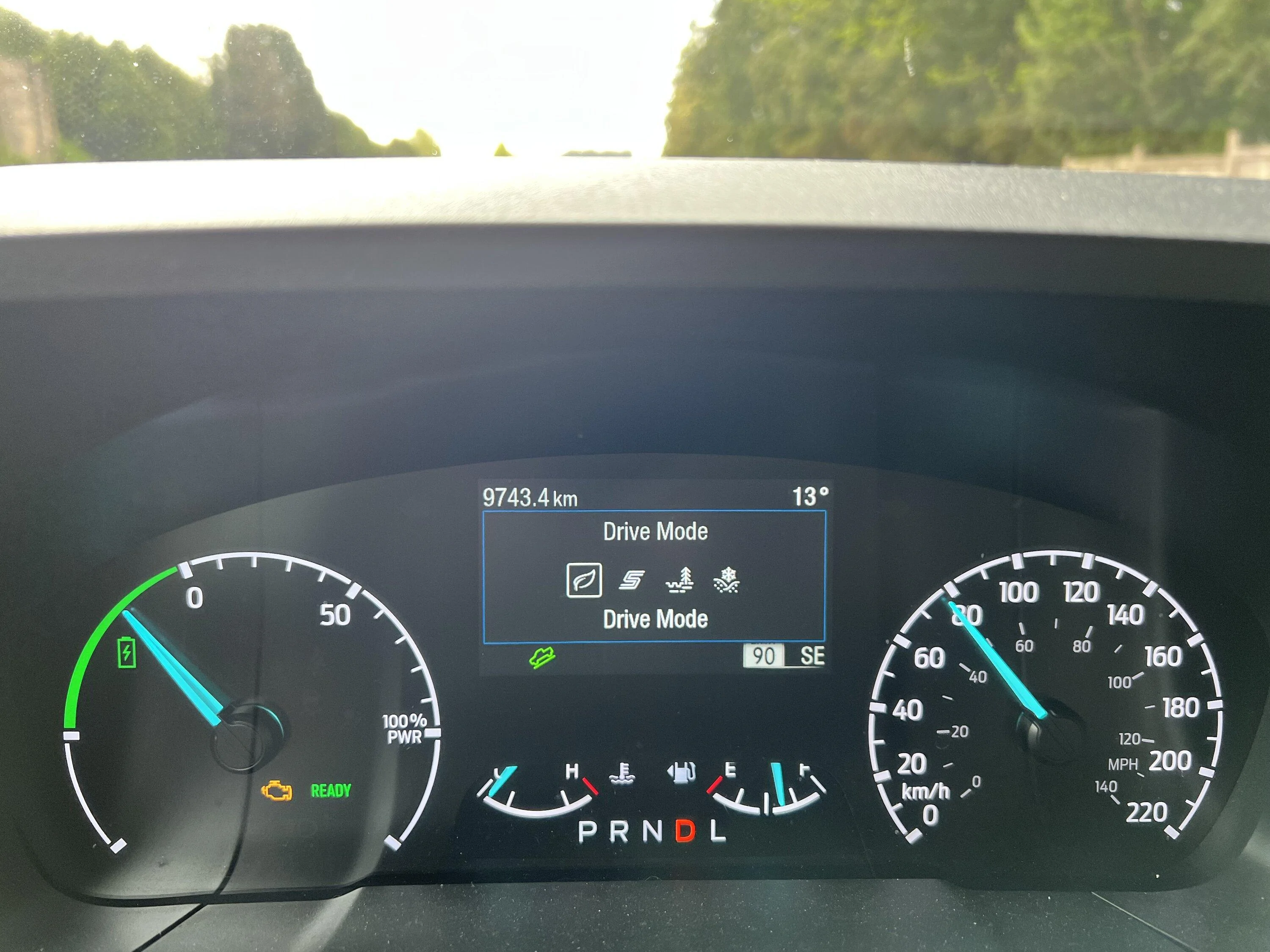

I disabled normal tow haul and slippery mode and now it starts in eco mode every time.

Yes. I’m not likely to tow much in the near future so don’t need tow haul. If i need to haul anything I can enable it prior to use.
I wanted to start in eco mode so removed normal.
Initially I just had eco and sport mode but added mud and ruts and sand and snow just to see if they do anything.
Haven’t tried them out but they are there when the opportunity presents itself.
I have been starting in eco mode every time for about two weeks.
It’s the same screen you would use to enable any of the drive modes.
Interesting. I had wondered if such a thing was theoretically possible or if at least Normal would be hard-coded, but never got to trying it out myself.
Did you have to do the ABS disable as when adding more drive modes or were you able to disable just the drive modes themselves without issue?
Edit: Gave it a try and it doesn't seem to think it's in Eco as the IPC stays in its Normal color scheme and pressing the drive mode button reported it was Normal even though only Eco and Sport icons were present. It also wouldn't even switch to other modes; the rotation animation would start to play and then jump back to Normal. I didn't drive it yet to evaluate what mode it was performing as.
Edit 2: Nope, driving it it's definitely starting in and even staying in Normal despite the drive mode display saying Eco.

I’m not sure if you can reorder them by installing them in a particular order or not. I haven’t had time to try. They may just be in a default order and by removing the normal and tow haul it ends up being first.
Maybe someone can look into that further.
I can’t take credit for anything I’ve enabled or got to work a certain way. I just got the ideas from messing around with Forscan after reading posts like yours.
Well that sucks, thought I was into something.
How do you determine what mode it is actually in. I won’t be able to test as I’m out of town for a week
