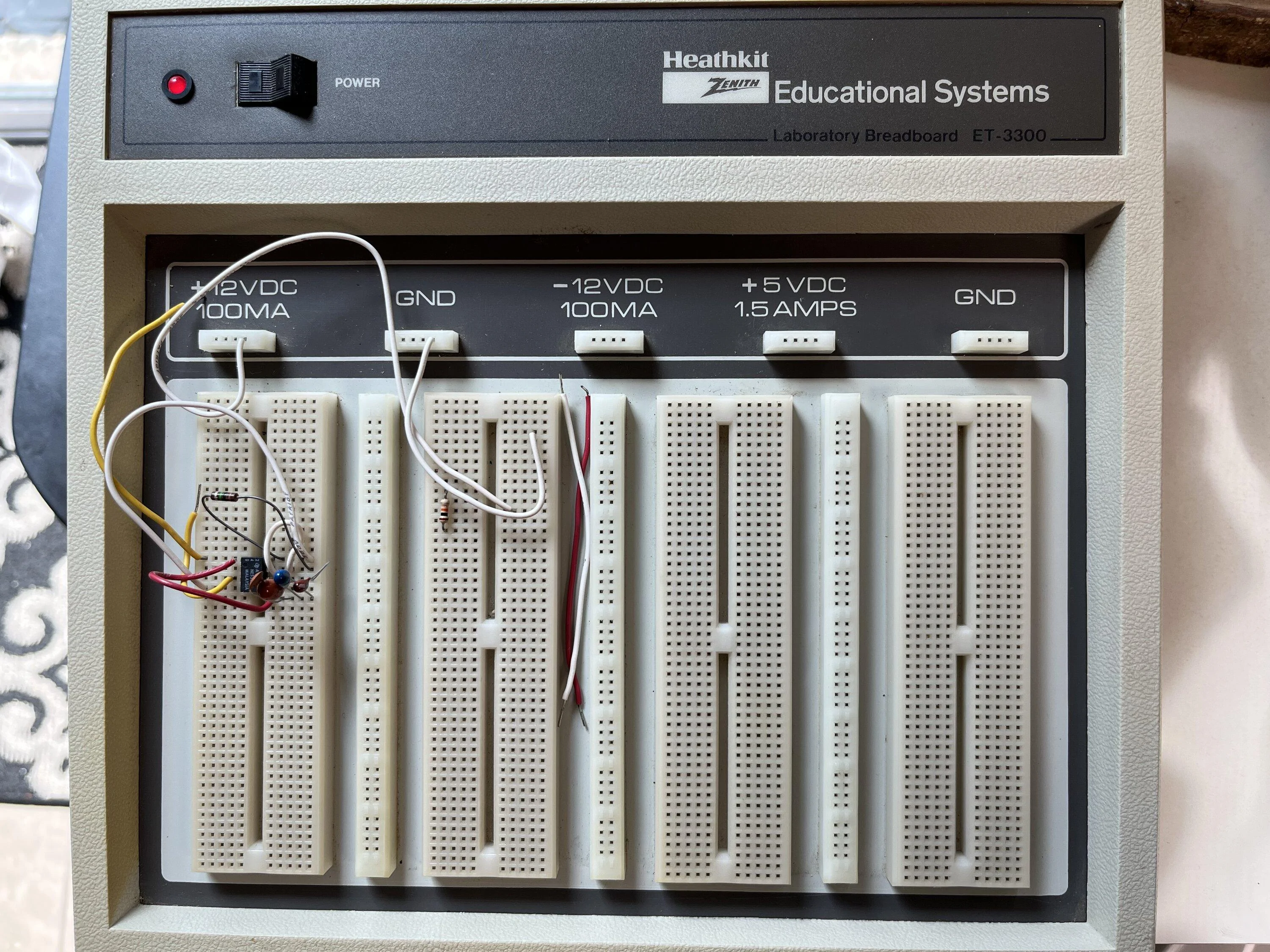

I hadn't though of breadboarding in years, found my old Heathkit with a NE555P in it from last time I used it.
I played with tubes, discrete, TTL, CMOS before microcontrollers took hold.
Ford Maverick DIY - Disable Auto Start / Stop + Default to a Drive Mode (MY ‘25 update) Heathkit ET-3300 Breadboard - IMG_1269
