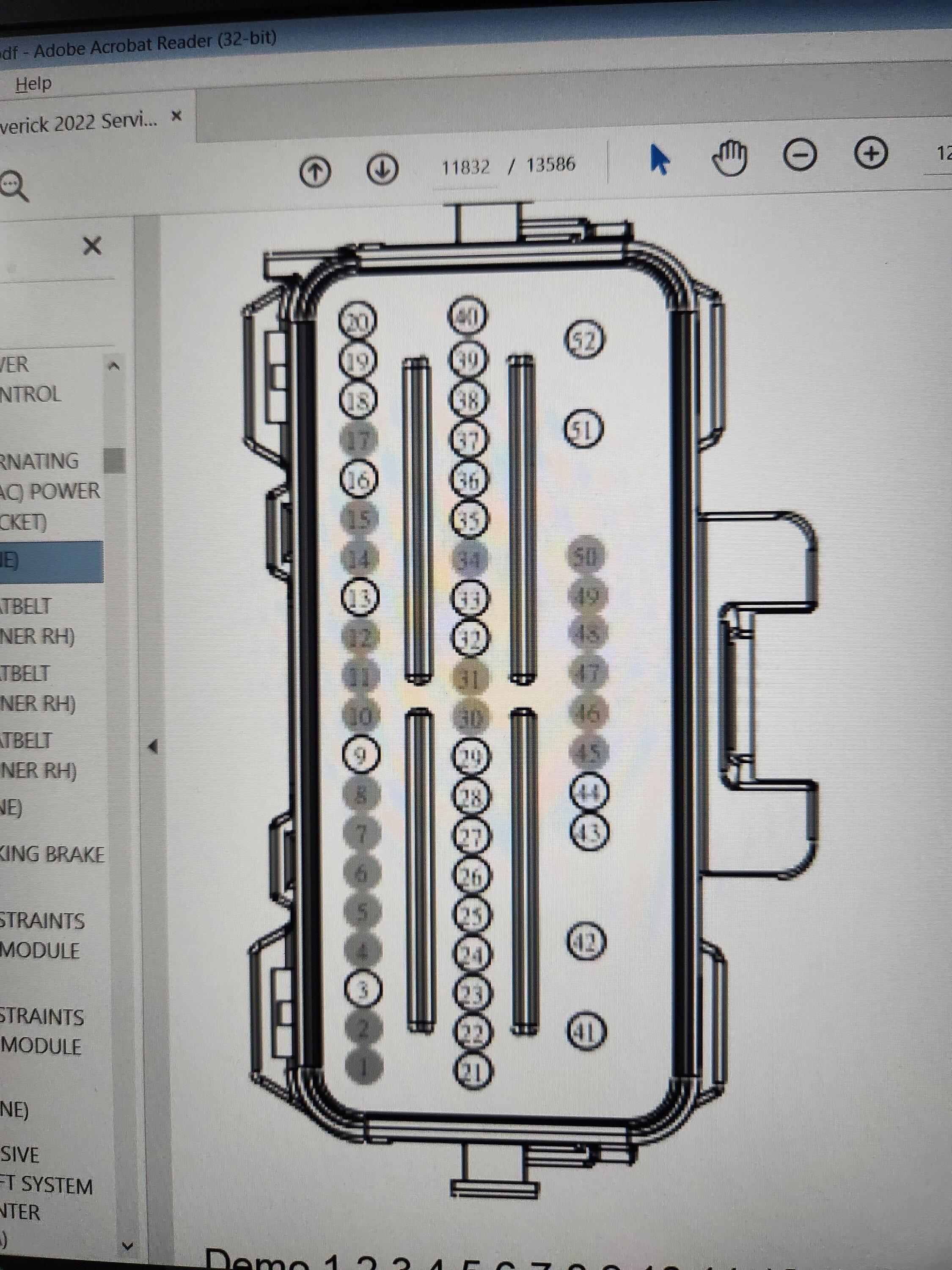

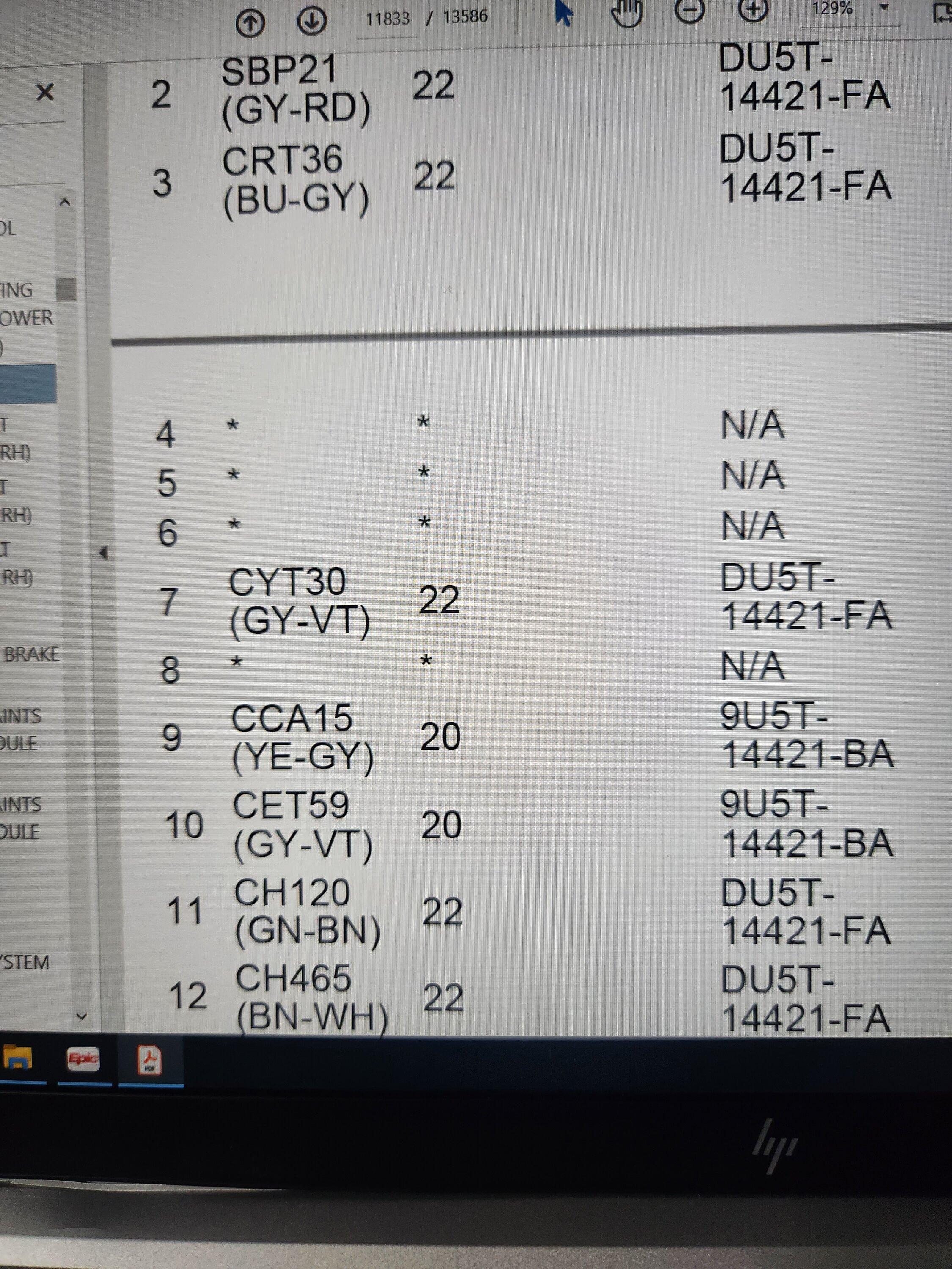

I was able to mess around with the C302 connector (the one in your video that you mention not to use, since the resistance is different). The wire in the 7th position at the connector is the one that controls the drive mode, per the service manual. It is Gray/Violet (CYT30).
I separated the connector and stuck a tiny gauge wire into the 7th spot, and then reclamped the connector.
Touching this wire to the screw below the in-cab fuse box triggers the mode change, just like pushing the button.
So Cuban Redneck's idea (which is brilliant) can be accomplished without any disassembly of the center console at all. All you need to do is tap wire 7 and fish the wire up to a spot where you would like to install your button hack.
Fuse 6 has been reported to be ignition switched, so would be a great place to tap for power for this device, and wouldn't require going to the ignition wire in the steering column:
Passenger Compartment Fuses | MaverickTruckClub - 2022+ Ford Maverick Pickup Forum, News, Owners, Discussions
I plan to use a 7805 regulator to drop the 12V to 5V to power a PIC microcontroller that will be powered when the key is turned. 5 second delay, then 5 pulses as Cuban Redneck as detailed (one extra for the seat belt indicator) on an output pin that will control an optoisolated solid state relay that will connect the wire I tapped into pin 7 of C302 to ground.
I'll publish my schematic and PCB/components.
