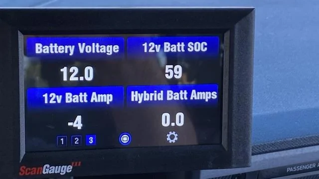

I'm posting in near real-time here.
NOTHING is turned on besides the scanner. It takes trivial power over Cat5 ethernet cable. 4 amps would burn it up. Yet here I am sitting in a parked locked car. Losing 12v battery charge.
This is really great findings. Wondering if it's possible to share with Ford Engineering Dept?
