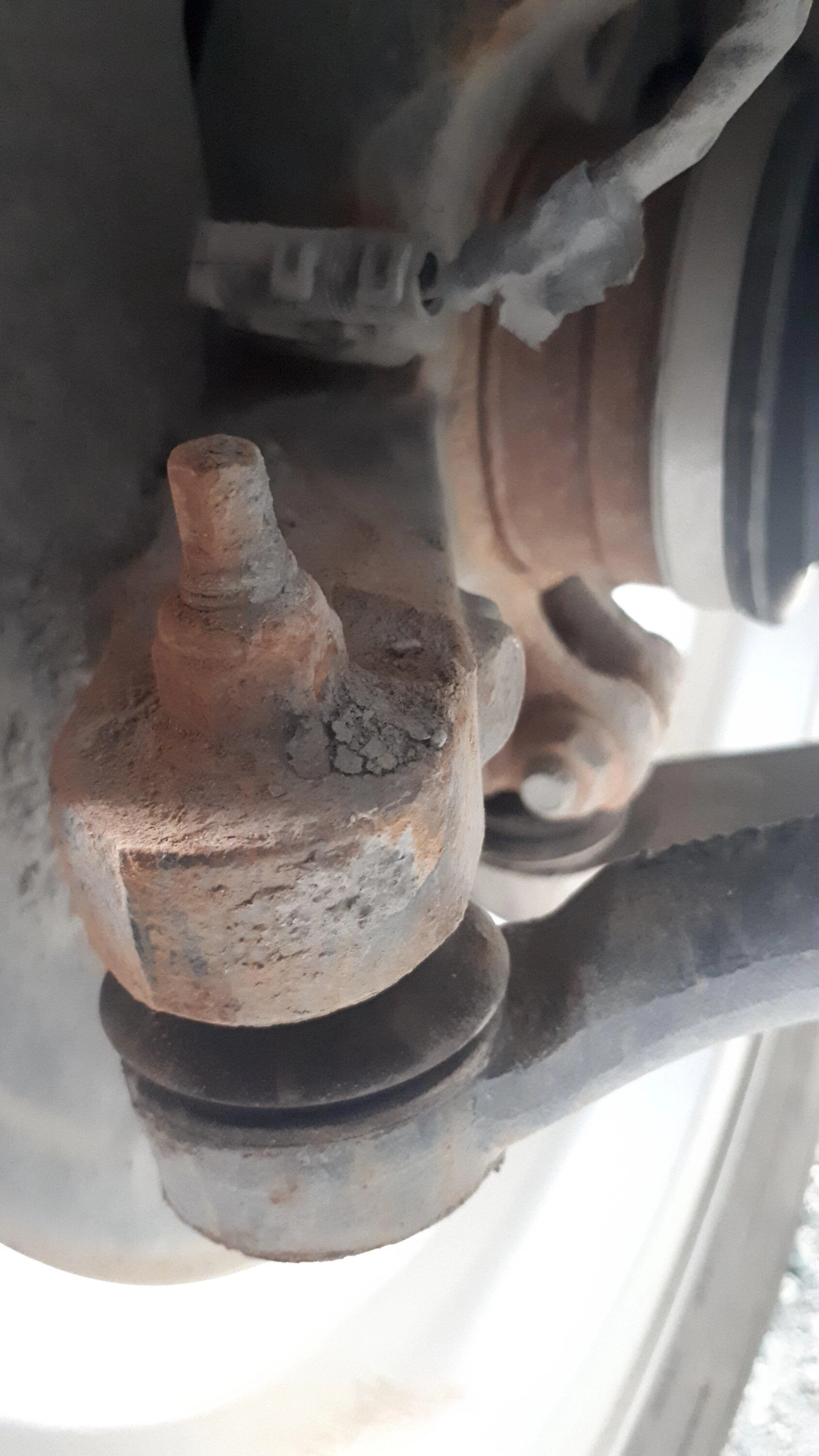

Just Google image search "steering knuckle", every single one of them will have several areas (all mating surfaces) ground down like this. These areas need to be paint free for a precise interface with other parts.

I think that's really petty stuff. That machined area to smooth the surface will never be an issue in the life of the vehicle. If you don't like seeing the surface rust, get a can of rustoleum truck bed coating or rust converter and dab it on. You people that see this as a worry issue must not have real problems to worry about.

This is not an uncommon occurrence. There's also nothing wrong with it. The only reason you're noticing it at all is because the rest of the spindle is painted. If it weren't painted the whole thing would be flash-rusted, the surface would look "even" and you wouldn't complain.

There maybe some quality issues somewhere, but the paint on the spindle isn't one of them. It only stands out because the spindle was painted prior to the machining operation. Most factory spindles I've seen aren't even painted.
This is a nothingburger.
Any of us who have had to bust loose nuts on spindles that have a serious torque setting to them already and rust has added to that, know what this picture brings to mind; a BIG hammer smacking away at a LONG breaker bar with maybe a piece of pipe over that handle while trying to keep the socket in place and HOPING you do not round off the edges of the nut!

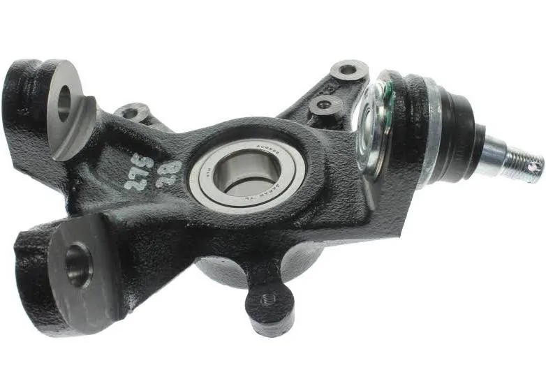

If anyone does search for steering knuckles for most all vehicles this is normal machining process for cast pieces. You can also go to any forums for other cars you’re interested in and see typical “rust” on new vehicles in same area’s. Here is picture for a new steering knuckle of Honda Ridgeline I googled please notice the “hacking” as described is precision machine work to proper dimensions.

I have been in the auto industry for 20+ years. The last 9 in aftermarket parts. I've never seen anything "shaved" like this, especially on a new car. My 2013 Audi and my 2017 and 2020 Chryslers never looked like this.
But if that's what Ford does then that's what they do. I've never owned a Ford so I guess I expect more. Surface rust on à week old part doesn't look good in my opinion
You first said that they were hacked then shaved. Its called "machining". Almost all castings and forgings are machined on functional surfaces.
One could argue that they should have been painted after machining.

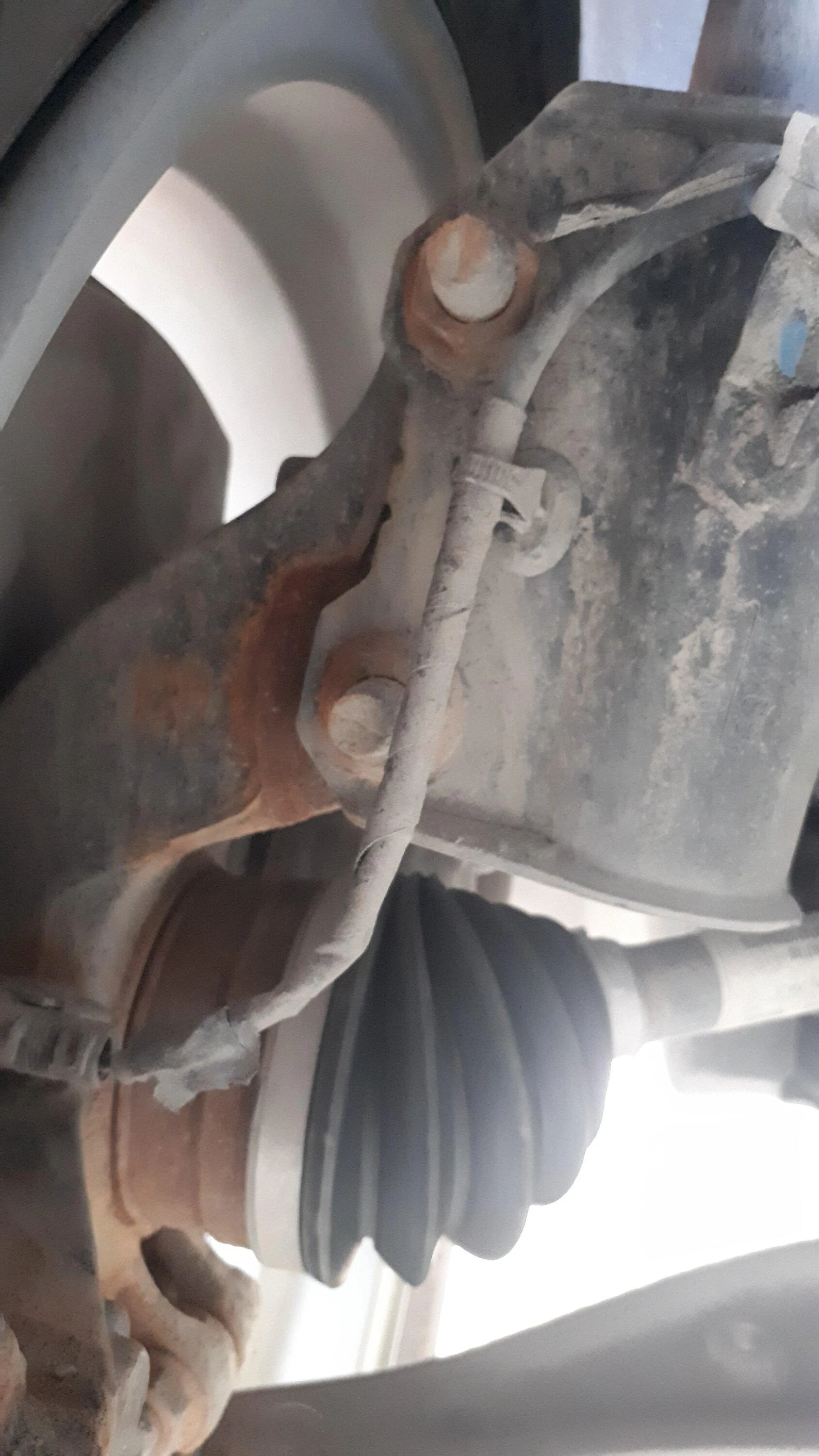

Just ran outside and randomly shoved my phone behind the front wheel, here's what it looks like after a weekend of gravel roads and 12000kms. I have no issue with this

I love my maverick hybrid...of course I don't crawl underneath it looking for anything that does not look "great"...but again, that's just me. I'm happy as hell with my 23k purchase.
