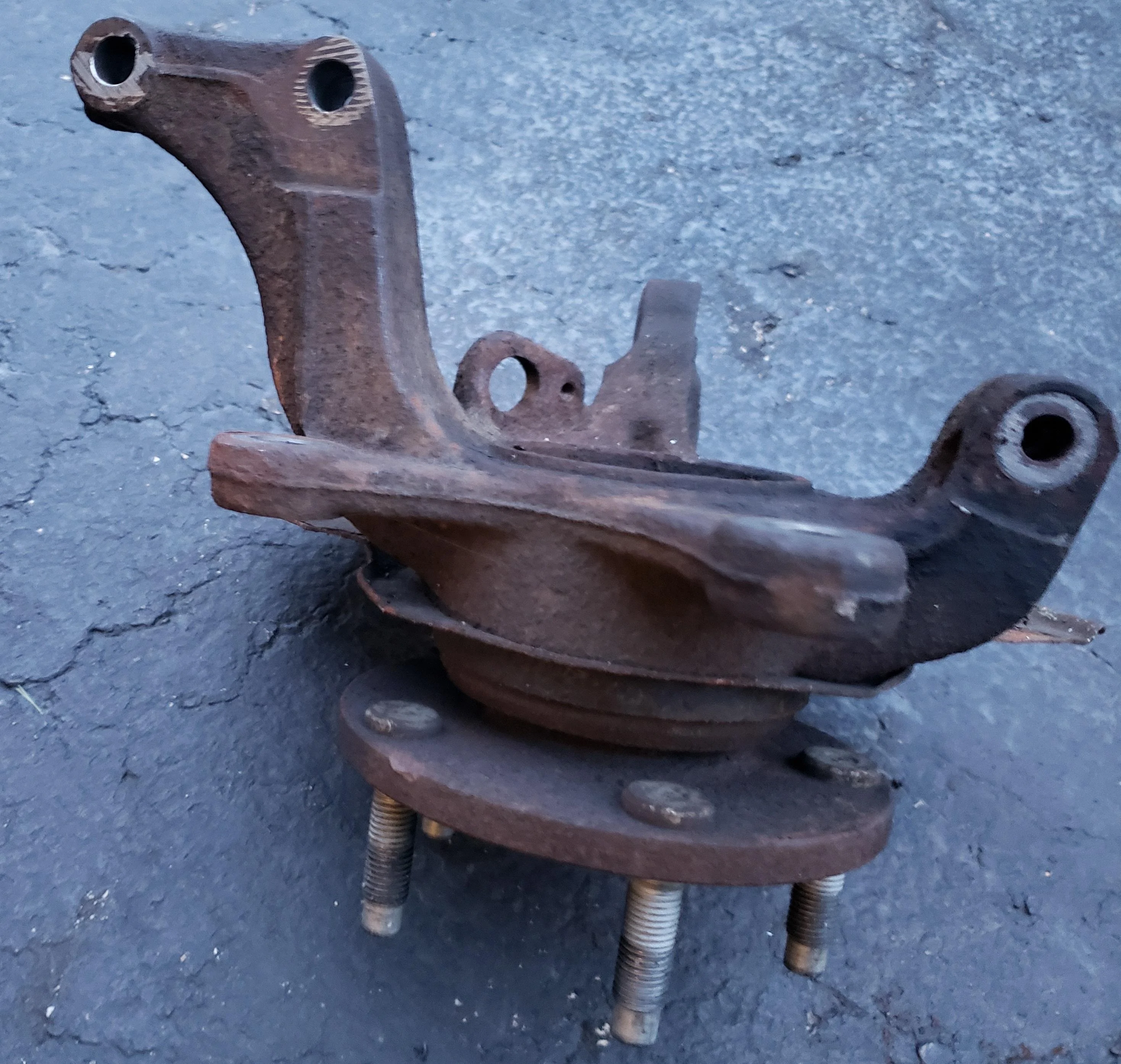

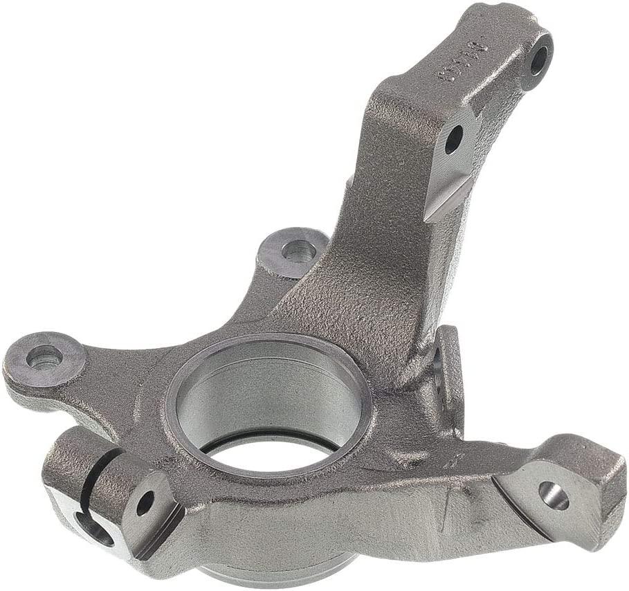

Here is a picture of a steering knuckle/spindle I pulled off my 09' Escape. You'll notice the machined mating surfaces and it may be hard to tell, but it was never painted from the factory. I also posted up a pic of a knuckle with the OEM raw cast appearance.
Ford Maverick Cutting corners 20220815_200047
Ford Maverick Cutting corners 61kXGwaoS8L._AC_SL1200_
