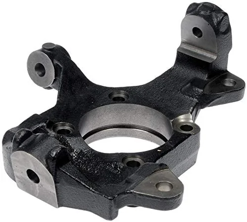

Very common to machine that surface perpendicular to the tie rod bore. I would be more concerned if they just left the cast surface unmachined. FYI the casting will probably rust through 10 years after the trucks been recycled.

This is normal, I've been in the industry for nearly 30 years, and this is completely a normal process of production. It might be more noticeable because the casting is painted so the machined portion stands out, but it's just a machined area to allow the nut to seat on a trued surface.

So after almost 10 months I figured I'd have a truck that was 100%. I had to imagine that Ford did whatever it takes to get trucks out for 2022 and by "whatever it takes" I was hoping it wasn't literally. I wanted to change my wheels out. And low and behold, corners were cut, well not corners but my spindles. Tops trimmed to mount the shocks and as you can see the really hacked the area to mount the tie-rod. Not real happy with my first ever Ford. Has anyone else had this issue? XL Hybrid 230 miles. Who can I contact at Ford? Dealer is aware of my issue.
I don't see the issue, most cars are made like that now a days, i've been a automotive tech for 10 years and its very common to see that... here's a brand new one for another vehicle for reference

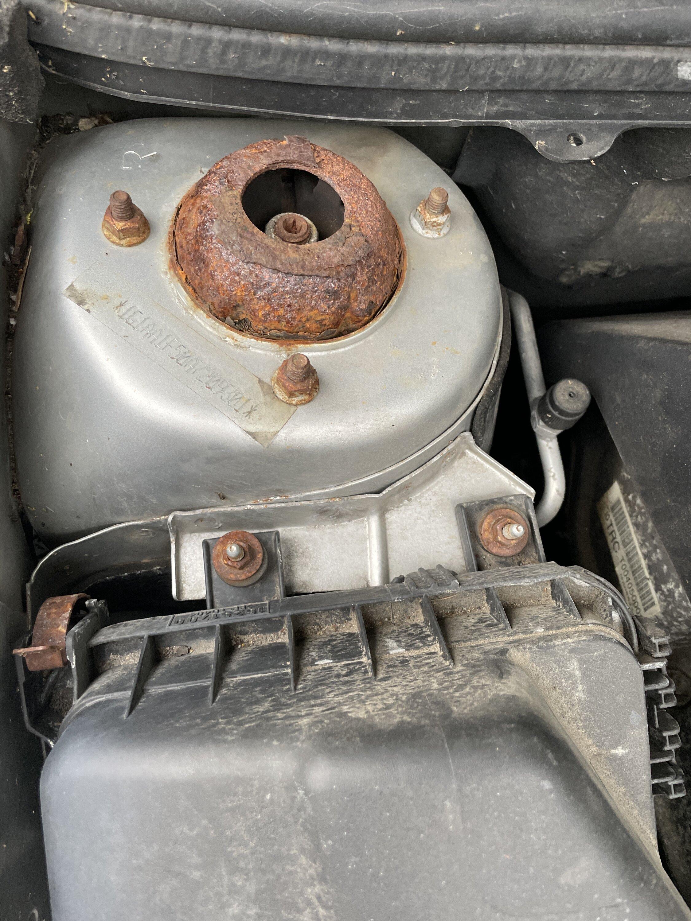

Here is how GM does it, it’s a replaceable part so why use anything better than old tin cans?
