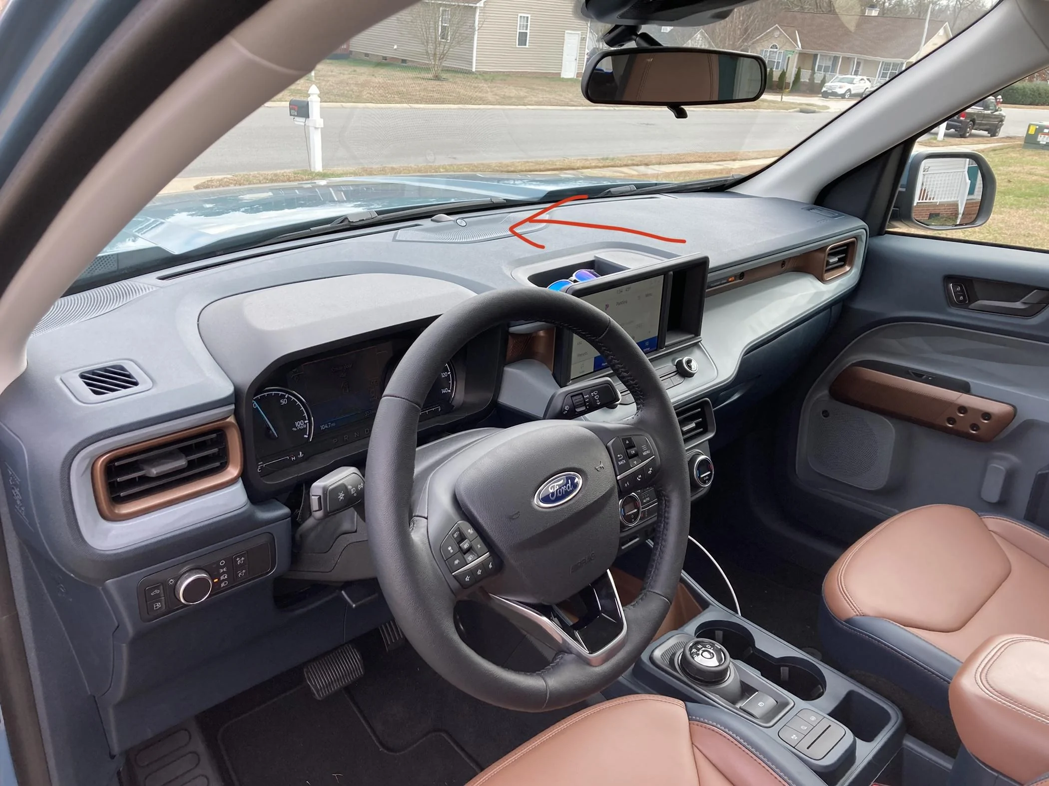

Ford is sending out top trim units with speaker grilles that don't fit correctly on the dash and you expect them to do well on parts that most customers will never see?
Can you point me to pics of this? My Lariat Lux is slated for production at the end of the month.
Heres mine. If you zoom way in you can see the middle part of the plastic lifting up and showing a gap. Not a big deal.
Hard to see. Does it rattle? Was it that way all along or did it develop?
This was back in January when I got it, but it sat in the Mexico parking lot for 3 months waiting on ok to buy before that (ancient history now lol).
No rattle there, but I do sometimes hear a buzz near the display itself. I can squeeze the display panel trim or something close to it and it seems to stop. It doesn’t happen all the time so it’s hard to pinpoint. It feels like a gamble on any trim level for something like a buzz somewhere in the cabin. Don’t sweat it you’ll probably not have one and if you do it can be remedied. The truck is great. Except I got the dreaded hybrid 12v wiring harness solder failure so the shop is replacing that currently. Hopefully they change that part to be a crimp connection for new builds.
