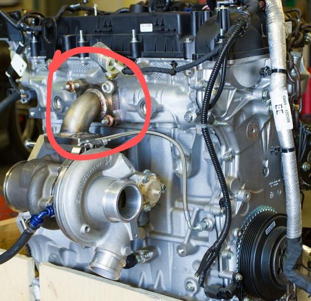

Yea, I'm trying to wrap my head around that as well. Looking up pictures of the 2.0 there is an exhaust port that goes to the turbo. On some the turbo is connected with stainless steel, others are aluminum. I'm guessing that is what they are talking about. The difference in expansion rates over the temperatures is the issue, not that there is stainless steel inside the aluminum head

Thanks - I totally forgot about the connection to the turbo, this is a big help in understanding what's going on. At least it looks like an easy fix - a few nuts and studs to get the damaged one off and to put the new one on. Now I understand why they use stainless steel instead of cast iron in a typical exhaust manifold - the heat between the head and the turbo must be intense. I have never worked on a turbo engine - always something new to learn!

Can you image how horrible the exhaust port flow is with this port design? Why in the world would the “engineers” encapsulate all four ports into one cast-in manifold with 90° angles? The EU head uses traditional port designs and bolts onto the block, but apparently needs custom headers. $4K w/performance cams, port blending and larger valves. Stupid....
