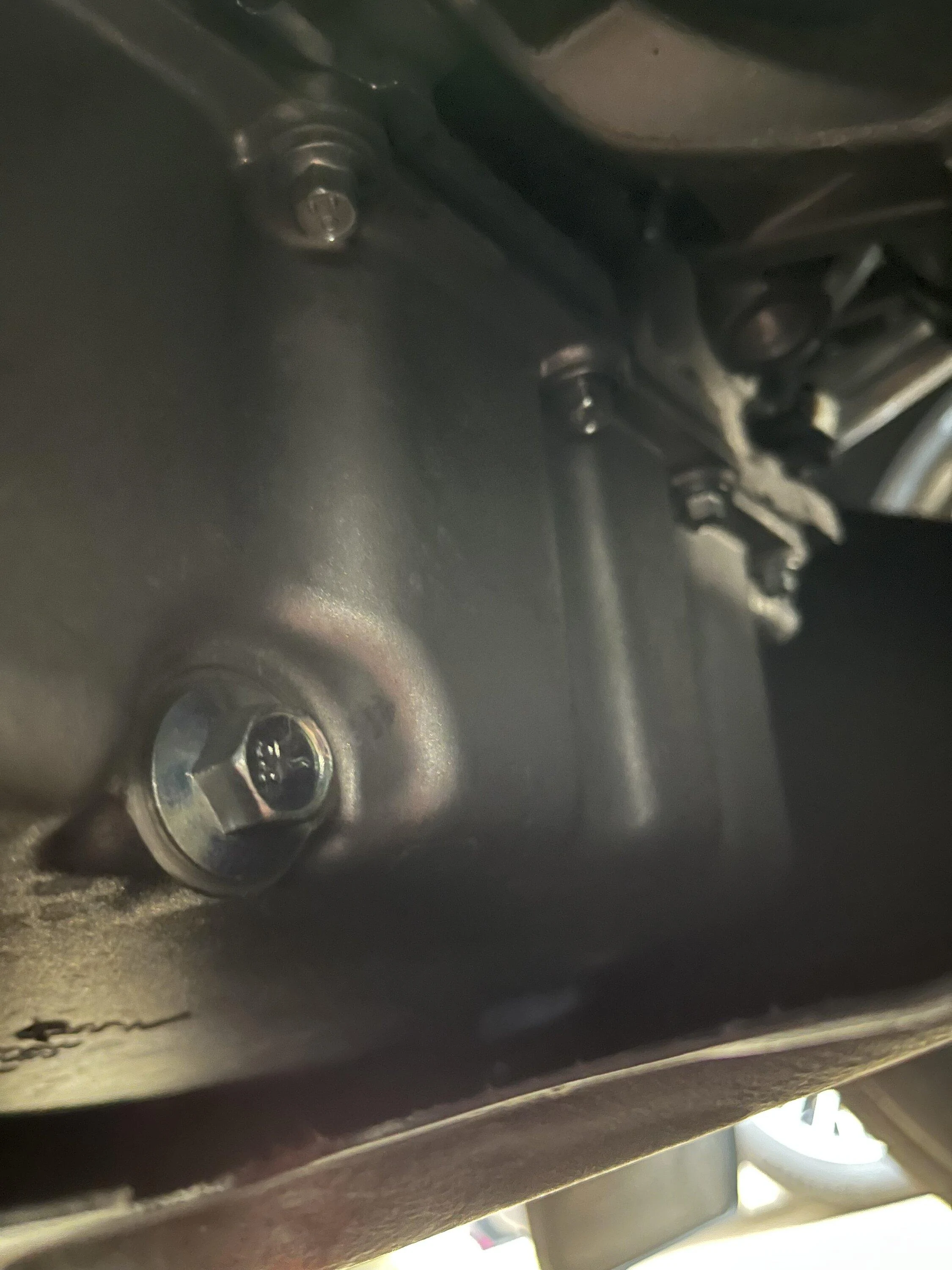

Does anyone know if a fumoto valve will fit under the hybrid properly?
There's space. I've used Fumoto valves on 5 prior vehicles.
When I changed my Escape's 2.5L oil a couple weeks ago, it was simple once the splash shield was down that I won't do it on either it or the Maverick this time.
Maverick 2.5L Oil Drain looking thru splash shield square hole.
Ford Maverick Changing your own oil - 2.5L hybrid Oil Drain above Splash Shield - IMG_2496
Looks like an adapter has to be added to the valve to fit onto the pan.
