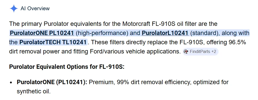

I'm using a PurolaterONE that bypasses at 12-15 PSI. That said I change my oil and filter so often the filter never gets a chance to go to full resistance/filtration.
Mine came with the short H6BG-6714-BA filter. But the FL910S and the 10241 are the same size so, not really sure why they have 5.7qts in the manual. The H6BG-6714-BA is listed as a 'break-in" filter but have seen a few reports of dealers using the same filter on an oil change. I requested to my oil to be changed before I even saw the truck not sure if the dealer did or not.

Is PurolatorONE 10241 a little longer and allows you to use six full quarts?

Purolator one 10241 is a little longer and allows you to use six full quarts?
Unless my engine is using oil, yes. I have 6 quarts in it with the 10241 and still within the hash marks of the dipstick.

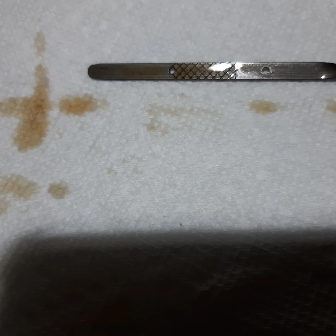

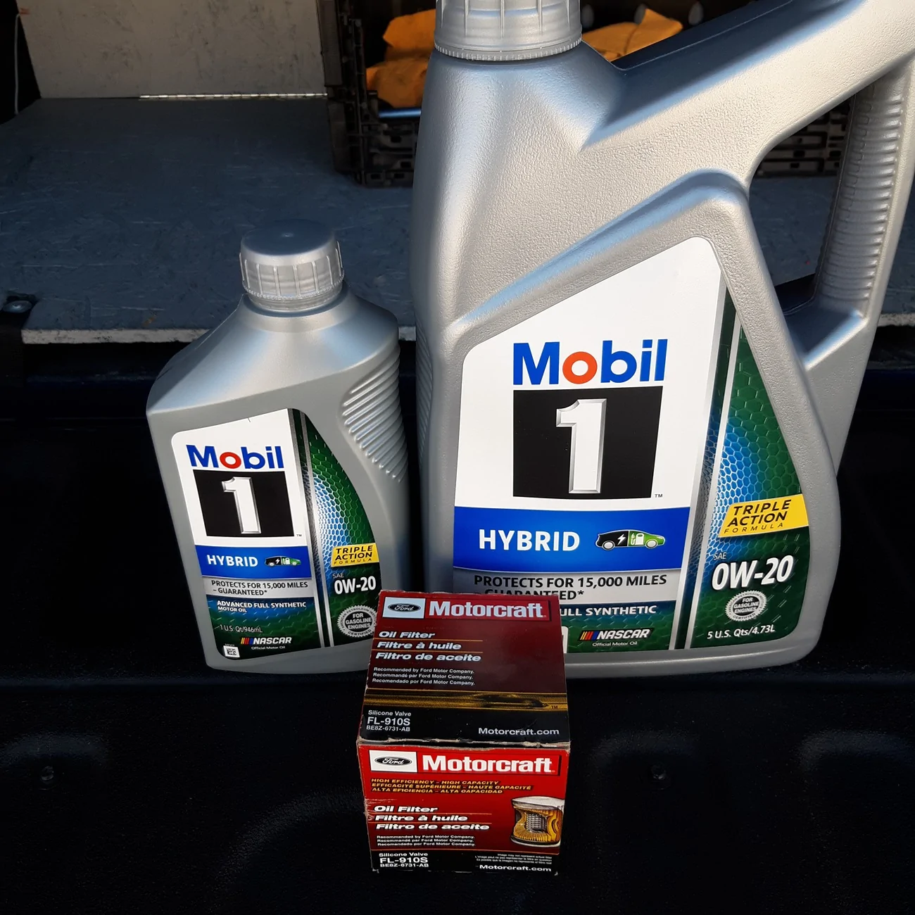

I changed my oil last week. I used Mobile 1 and a Motorcraft FL 910 S
Ford Maverick 2.5L oil capacity 20260115_100103
* I filled with the recommended amount 5.7 quarts and it was a little short.
I dumped the remainder of the quart in to equal a full 6 quarts.
And that brought the oil level up perfectly.
Dipstick reading taken with a cold engine. Truck has been setting for 24 hours since it last ran.
I know it's a little hard to see.🤓
Ford Maverick 2.5L oil capacity 20260209_094313
* I understand anywhere within the hash marks is okay for oil level

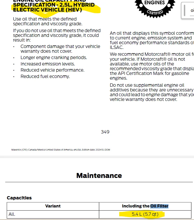

NO I have The 2.5 EB
Ford does not make a 2.5 ecoboost, and your profile says 2.0 ecoboost. That said the owners manual is for both drivetrains and you have make sure you are in the correct section. The 2.0 does take 6qt, the 2.5 liter states 5.7qt.
