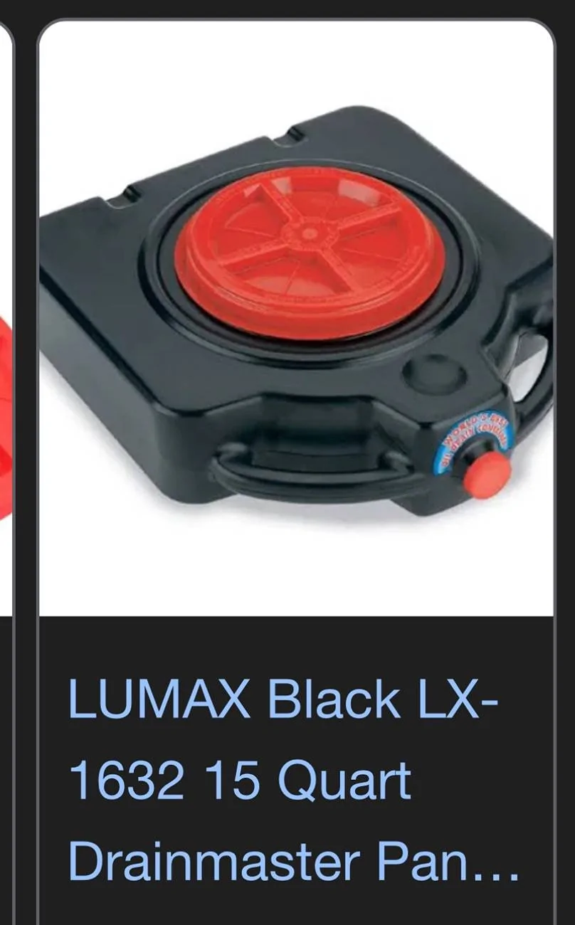

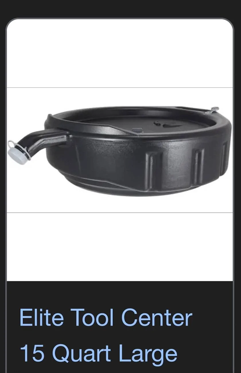

Regarding the pan....
Bah.... no lid.
I always get ones with lids or enclosure.
Then you can just drive it to the recycle place. No transfer necessary. And I can do two changes or two cars between trips to the oil drop off place.
Bah.... no lid.
Been there and rejected both. The one with little hole splashes oil out around the pan when you first pull the engine pan bolt, or worse if a breeze is blowing on the stream, completely off the pan. For the big red cover version, more finicky placement to hit the hole, and if the stream isn't centered or blows off center, splashes out. And if the red lid isn't tight or age and/or grit comprises the o-ring, they leak on the floor when set upright.
The Lisle is wide, deep, has an anti-splash lip for draining and carrying, and the spout fits into a gallon jug or my 5-gal gas can I use for waste.

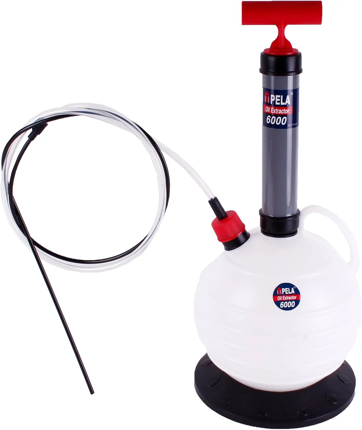

Ford Maverick 2.5L Hybrid - Change to 5W-30 oil 61Y2KtCFIpL._AC_SL1500_
Easier and cleaner yet; 3 minute oil change. Too bad the oil filter isn't a topside cartridge on this vehicle...

oh my, I got mine as a package deal from a guy when I bought an old VW diesel, I bet there's a million clones of this thing out there nowadays. It was nice on that old car because the oil filter was on top too and it had the bolt on tray underneath, so this was the coolest thing, do an oil change only by opening the hood, filter and all!
