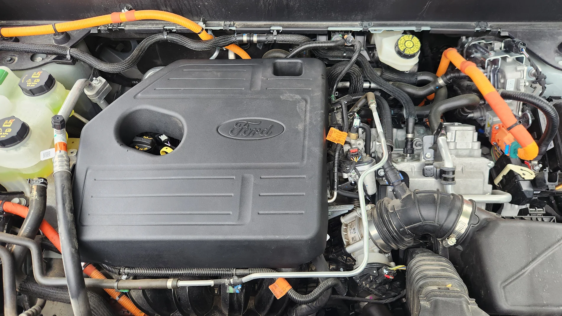

For those who have questions and are considering an engine cover for their hybrid, I wanted to collect all the information in a single thread. This is my first contribution, hope it is helpful!
I was fortunate to find a used junkyard engine cover from a Ford Escape Hybrid for $50 plus shipping. At my request, the yard also pulled the mounting hardware which includes a ball post and a retention bolt/washer/nut.

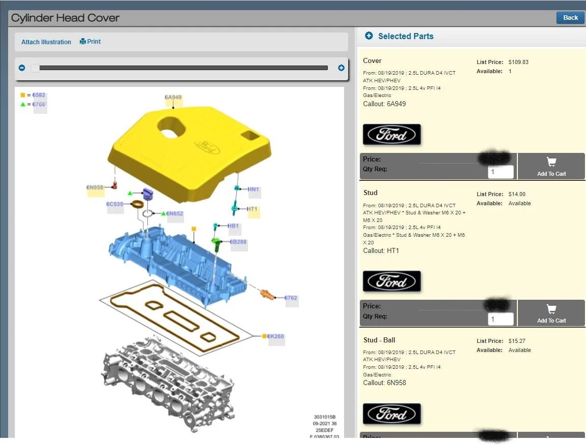

Ford Maverick 2.5L Factory Engine Cover Definitive Thread 1000005866

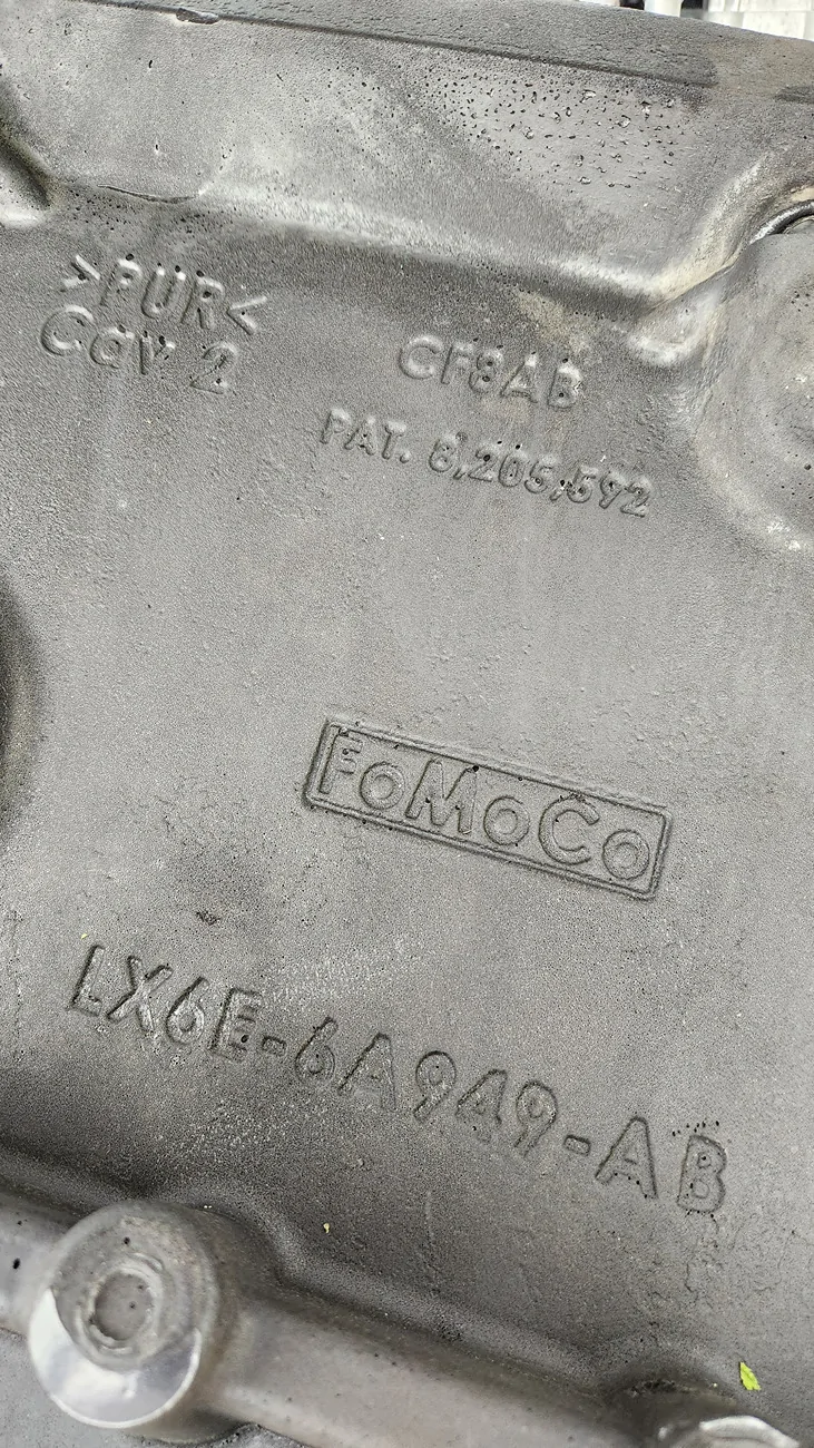

Ford engine cover 6A949 part number
LX6Z6A949B
LX6E6A949AB
*Or* do an interchange salvage yard search for 2020-2022? Escape Hybrid engine cover
Ball Post part number
6N958 stud is AA5Z6N958A
Ford Maverick 2.5L Factory Engine Cover Definitive Thread 1000005864

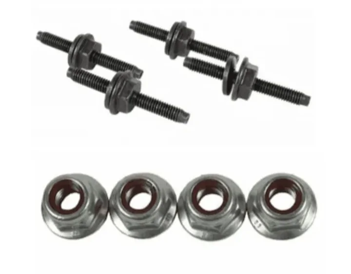

Retention screw part number (Just need one!):
HT1 stud is W714647S450B (also need H1N nut unsure if included)
Ford Maverick 2.5L Factory Engine Cover Definitive Thread 1000005865
My first impression is the engine cover definitively reduces engine noise. The transition to engine power is almost imperceptible and the sound level is noticeably reduced across the rev range. The distinct growl of the Atkinson Cycle, especially in the 20-30% power range, is attenuated but not muted.
Ford Maverick 2.5L Factory Engine Cover Definitive Thread 1000005860

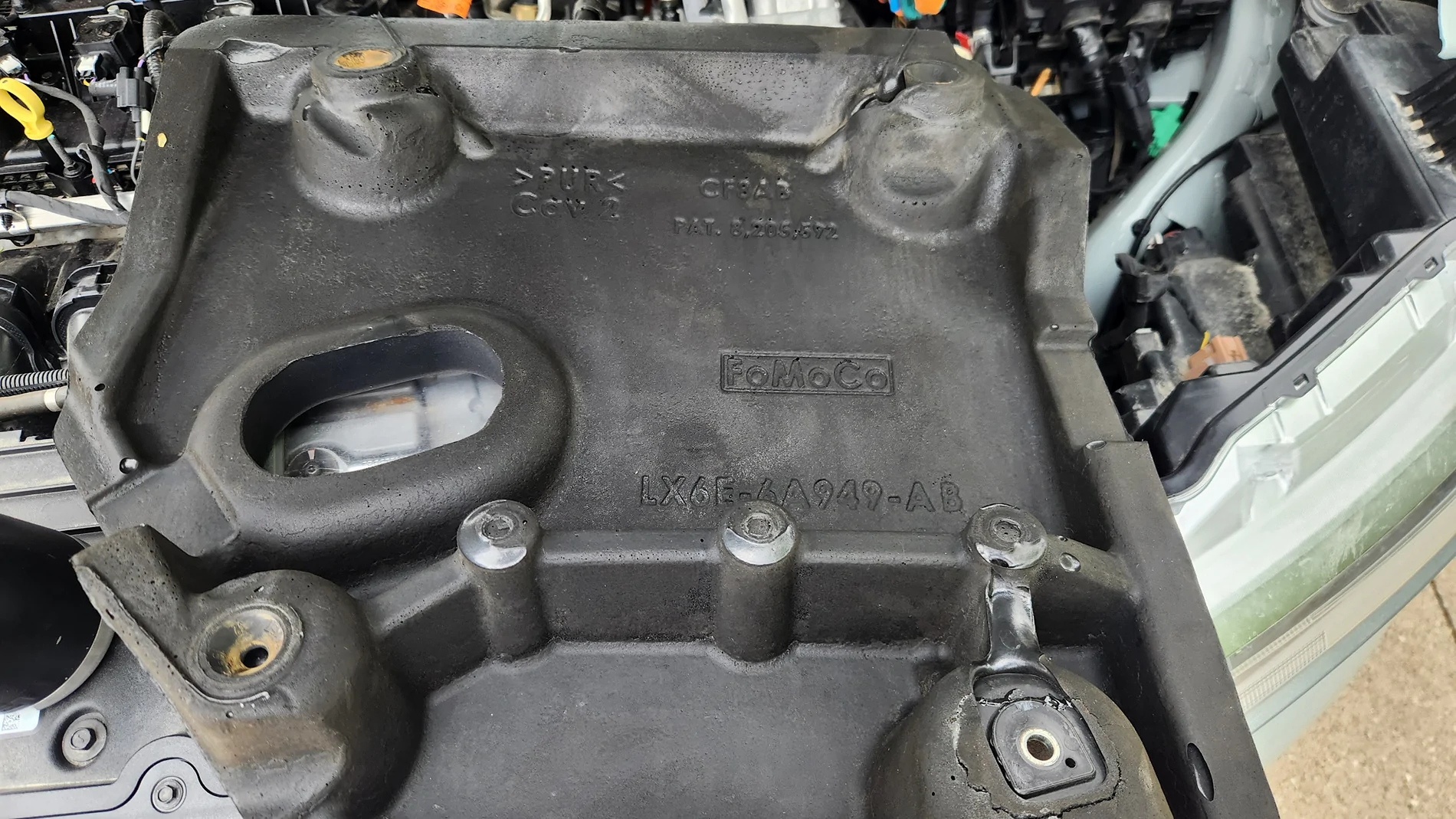

The cover is made of urethane or rubber foam and varying thicknesses between 1/2" and 1" . There are four plastic pieces molded in for the mounting points for the posts and the retention screw.
Make sure you firmly tighten the bolt post or when you loosen the nut the post will walk out tear the cover (as you can see below).
Ford Maverick 2.5L Factory Engine Cover Definitive Thread 1000005859
Ford Maverick 2.5L Factory Engine Cover Definitive Thread 1000005858

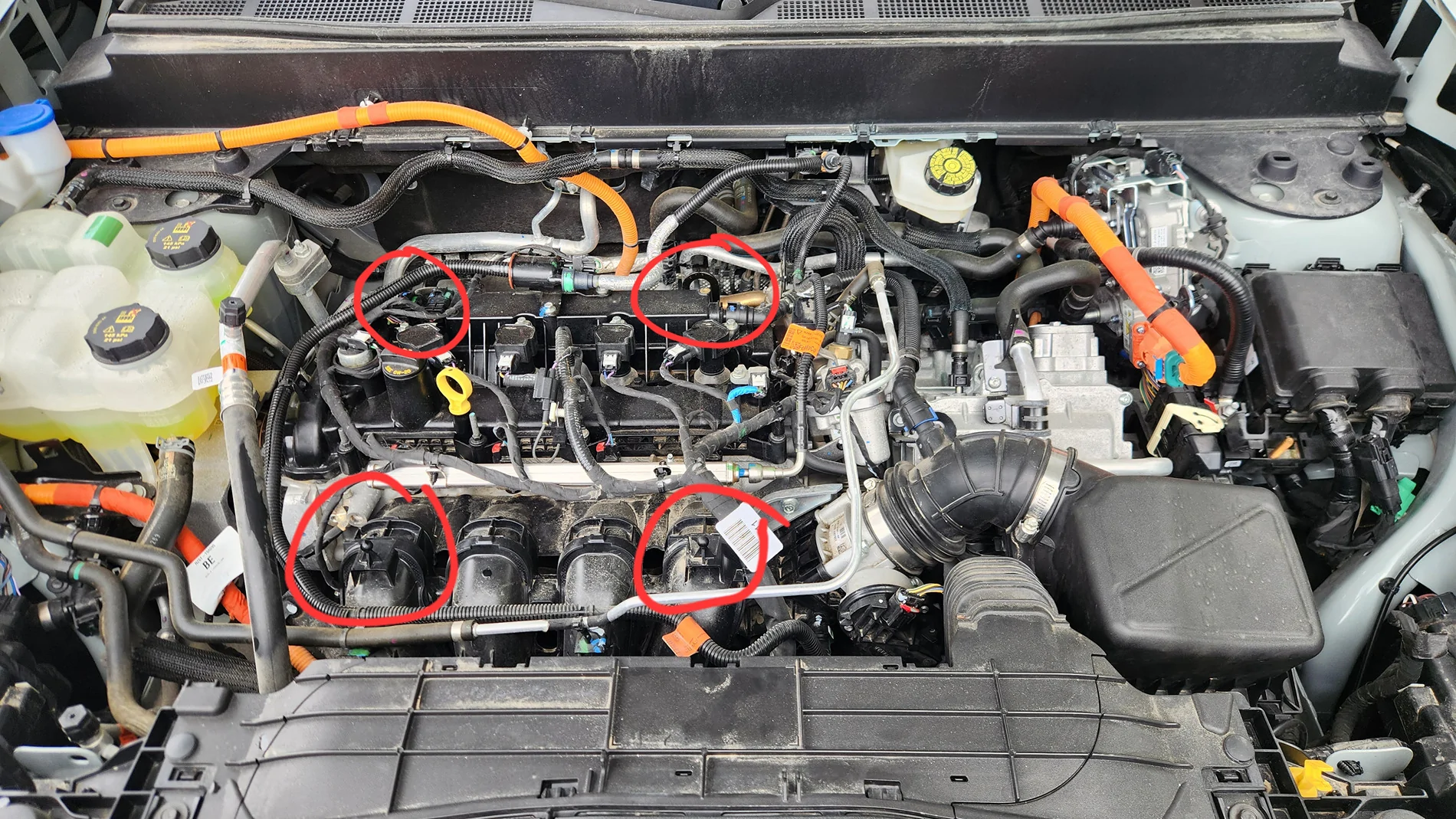

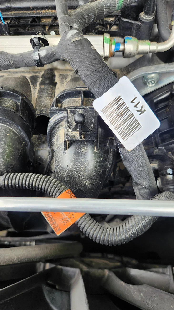

There are four mounting points.
Ford Maverick 2.5L Factory Engine Cover Definitive Thread 20260423_142714

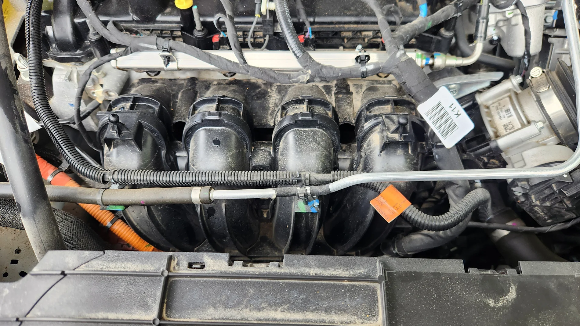

The front mounting posts are molded into the intake runners.
Ford Maverick 2.5L Factory Engine Cover Definitive Thread 20260423_142722

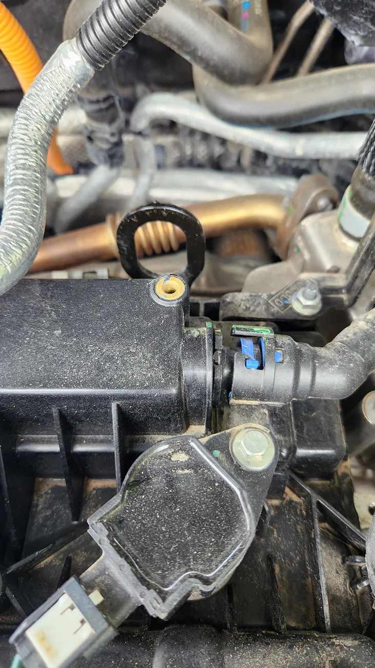

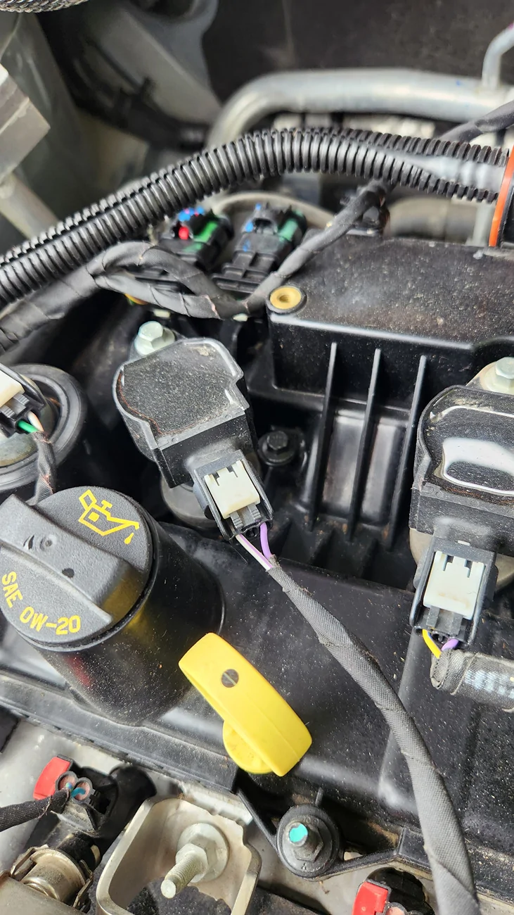

You will need the hardware for the rear ball post mount and the rear retaining bolt. Sorry, I didn't grab pics of these installed. They mount here:
Ford Maverick 2.5L Factory Engine Cover Definitive Thread 1000005857
And here:
Ford Maverick 2.5L Factory Engine Cover Definitive Thread 1000005856
