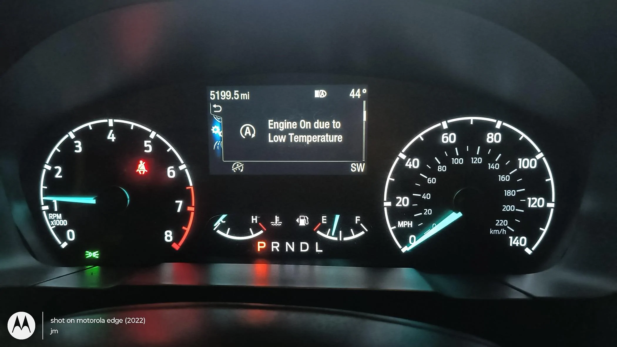

I posted this recently with another user with similar ussue: It might be different on the Lariat (bigger screen and maybe different menu layout) but on my EB XL: If you go to the center screen and the Information Menu, then select AutoStartStop, the reason stop/start isn't working is displayed. Below is a screenshot I took with a cold engine:

I'm going to check that.
