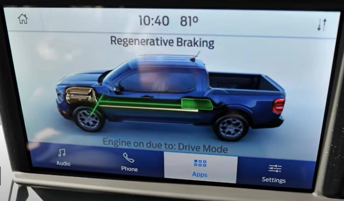

Do this, on the home screen there is a little noticed 'electric bolt' symbol. Click on it. It will give you a graphic of the power movement in your car and it will also tell you why the gas engine is running.

Tap "Apps" in the bottom bar of Sync 3, then "Power Flow" OR the "home" icon, then the rectangular button on the right side of the screen with a lightning bolt on it. It will display the below screen to tell you why the engine is on.
"Drive Mode" = you're in Sport or Tow/Haul mode.
"Normal Operation" = the batteries are low, or the coolant isn't up to temperature.
"Drive Power" = you're commanding more acceleration than the hybrid battery + motor can provide.
"Heater setting" = the coolant isn't warm enough for your desired heater setting.
Engine running at stop lights, especially when cold, is normal. As others mentioned it depends on the coolant temp, heater setting, and battery charge levels.
Your MPG also sounds normal for peak New England winter. Expect low 40's when spring comes around.

This was an absolutely amazing post!
Thank you.
I spend all my time with the Nave screen up so outside of settings I had no idea.
This is just perfect.
Thank you again!
