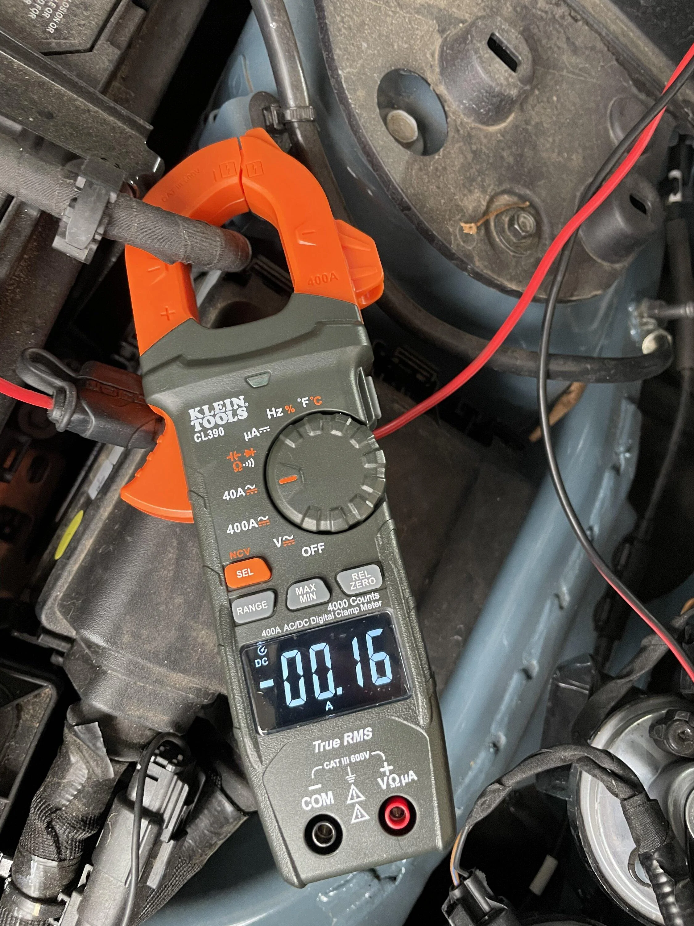

This was after sitting for an hour. I made sure to not open any doors, unlock, etc. The hood was already open. Anyone know if this is normal?
Watch PHAD check a Linky for battery going dead...
I think his number was 6ma when fully sleeping. You are at 160ma, which personal opinion is a bit too much.
Ivan went through the networks on the Lincoln, essentially an Escape touted up, and then found which was going active, and found the guilty party.
