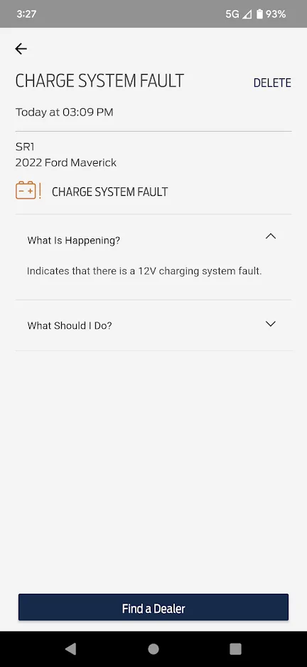

Ford Maverick Auto Stop/Start Not Working 12V
system fun today even after the new battery 3 weeks ago -

Same problem!!!!! Fords dumb ass can’t fix it even though I showed them the TSB!!! They contacted ford support and it’s been weeks!! I’m so annoyed! I get 100 alerts a month while driving and on app! Auto/start doesn’t work which is fine lol, but, it is annoying and I think is causing other electric glitches

Check that battery and all/terminal connections - Then find a new dealer- wow
