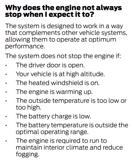

It doesn't have to be low voltage. The battery temp itself could be below the required value. It could also simply be the outdoor temp is too low. In my Escape, I've noticed it tends to not stop as frequently in the winter as during the summer and I live in central Alabama where a cold day is in the upper 40s.

Appreciate the response, but as I stated in my original post the dash is providing the reason of "disabled because of vehicle charging". Which seems to point to battery related.
