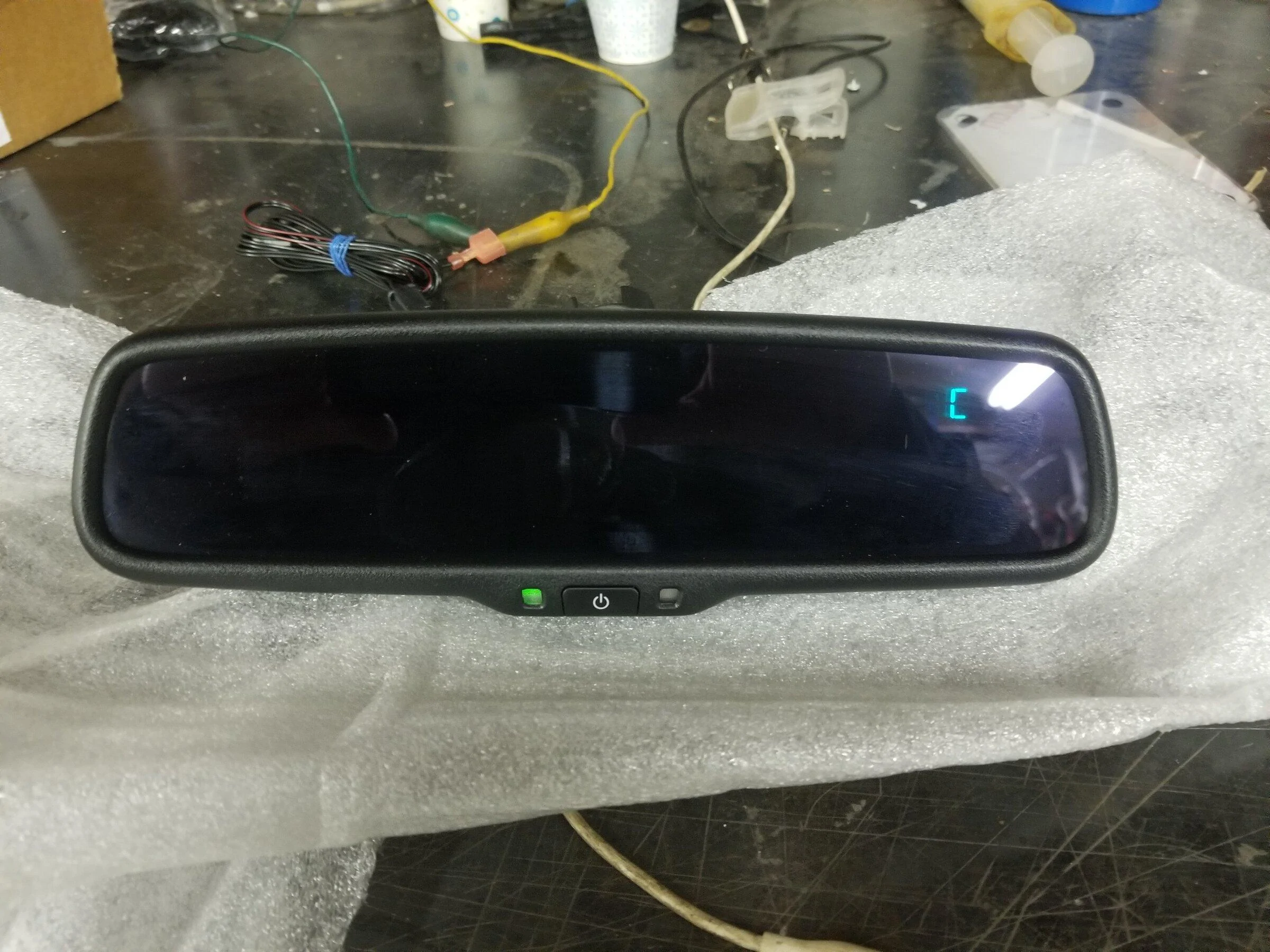

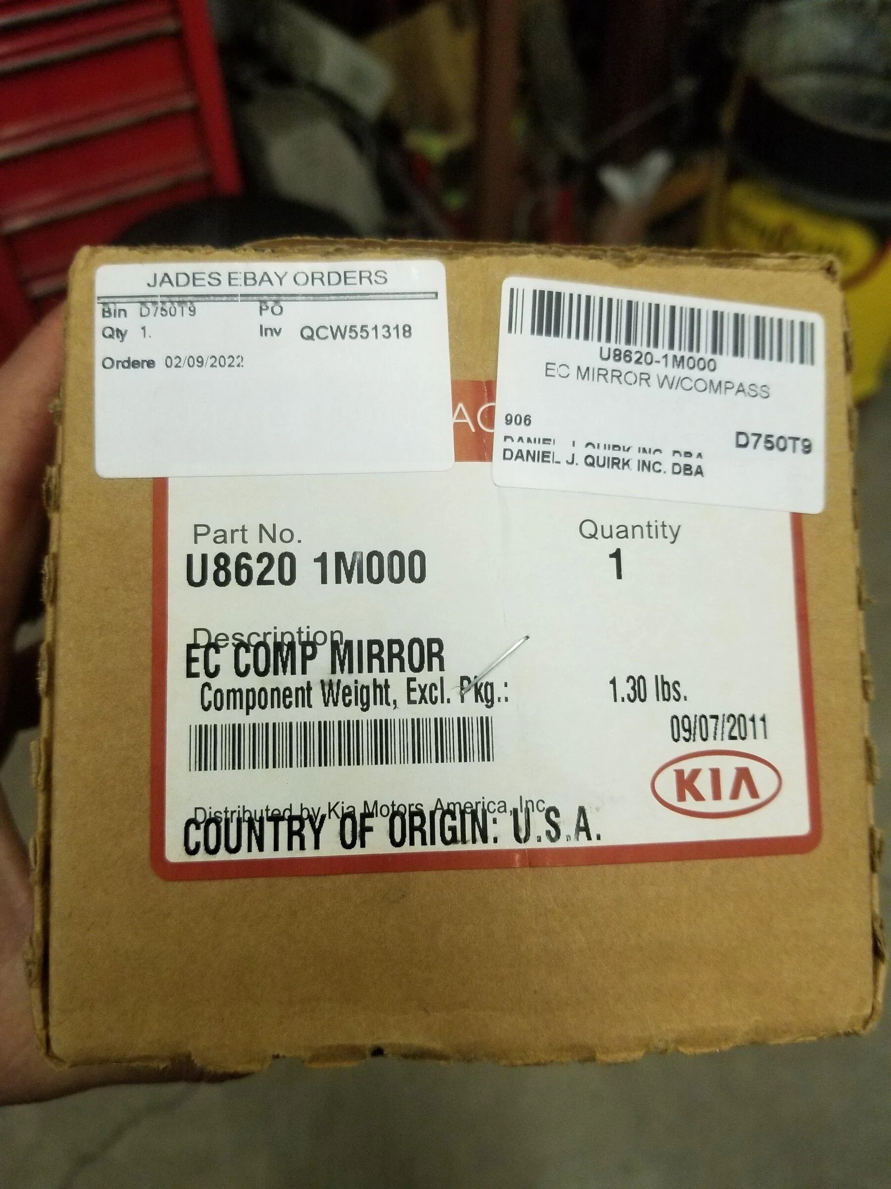

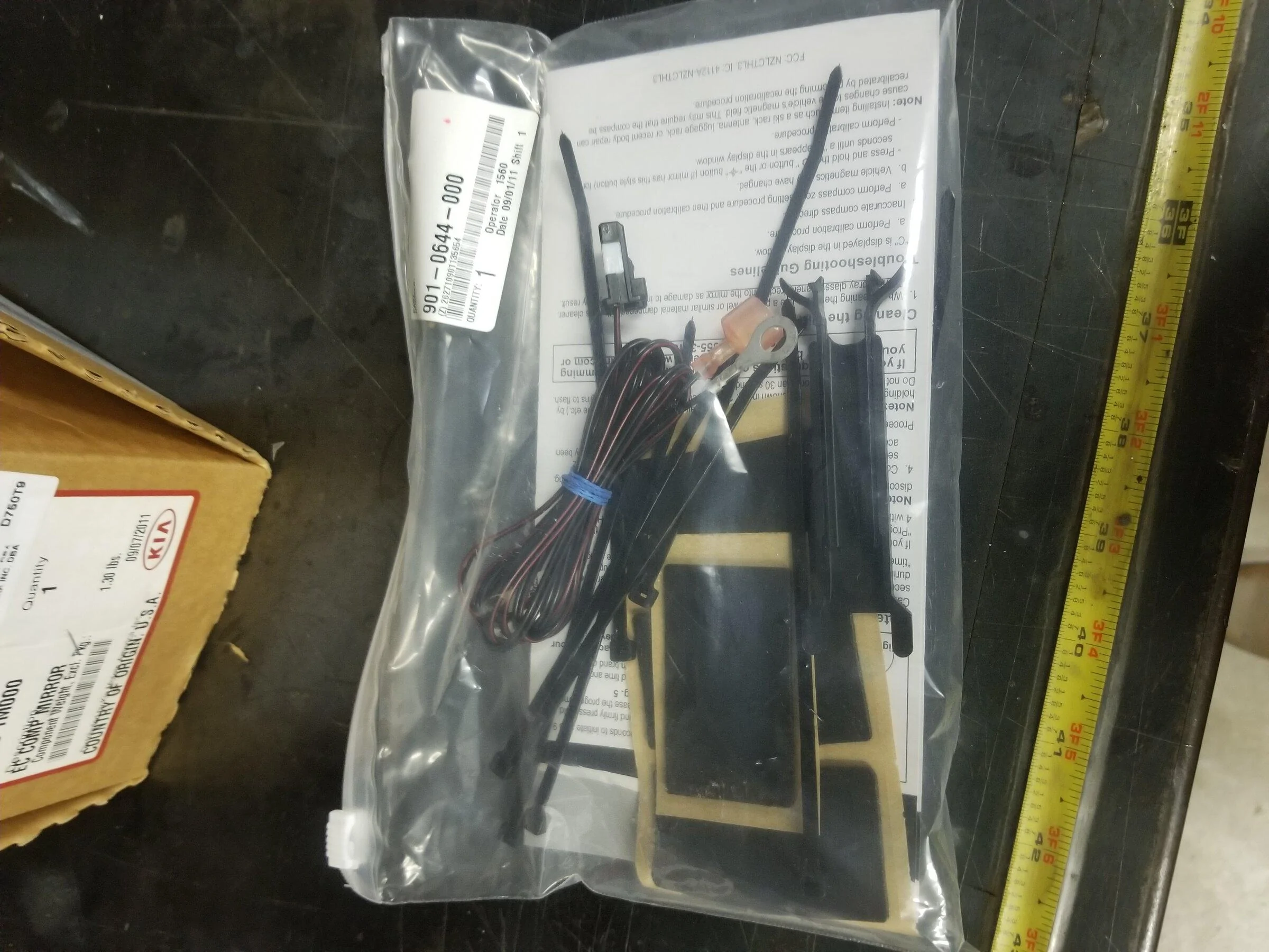

I didnt need homelink buttons, so I got this Gentex mirror ran me $32 shipped and it was a dealer install kit for either a Forte, or a Sorrento. Obsoleted, auto dimming with compass off evilbay. 2 wire hook up. Body ground, ignition switched hot. Will be easy peasy to install when my truck arrives.

Just finished up installing my auto-dimming mirror. Unfortunately I jumped the gun and ordered mine used off eBay a few days before someone found the cheap Kia mirror online but oh well. Was just under $60 shipped. Has auto dim, homelink, and a hidden compass as a bonus.

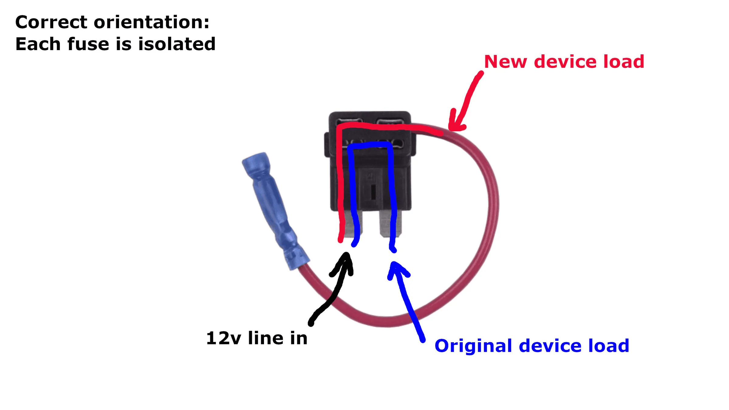

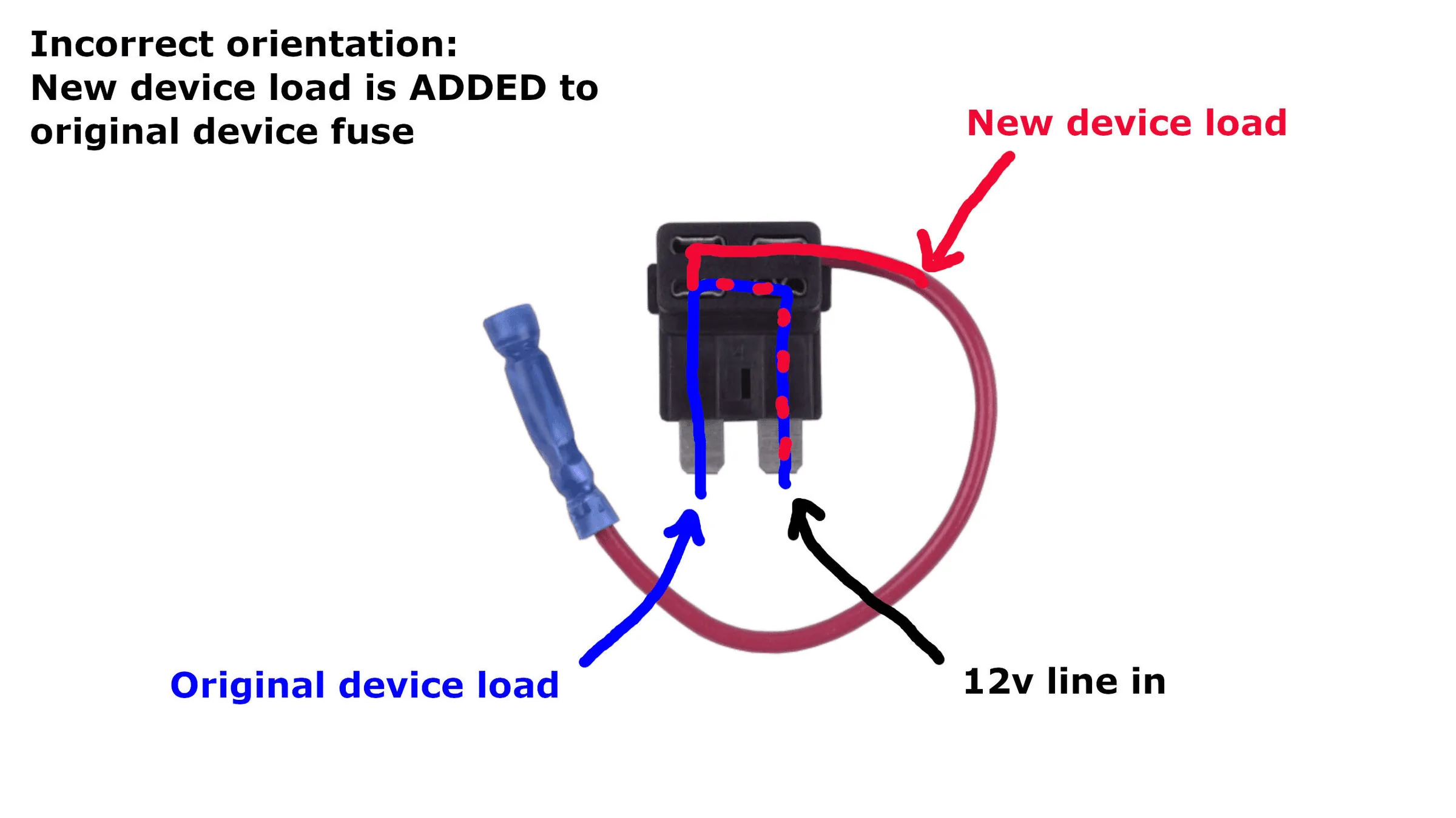

Question when you use the fuse tap does that replace the factory fuse or does it share the slot❓
clavicus
Jun 21, 2021
1,483
2,053
You will keep the original fuse in the 'bottom' part of the fuse tap, and your 'new' fuse goes in the top, in line with the outgoing wire to connect your device.
If you 'orient' the fuse tap correctly, these two fuses are isolated from each other and the system load will not blow your 'new' fuse, and your new device will not blow your original system fuse.
If you do the orientation wrong, then the issue is you are putting both the system load and your new fuse load both onto the original system fuse. It might not matter at all unless you are really pushing the limits of the combined total.
