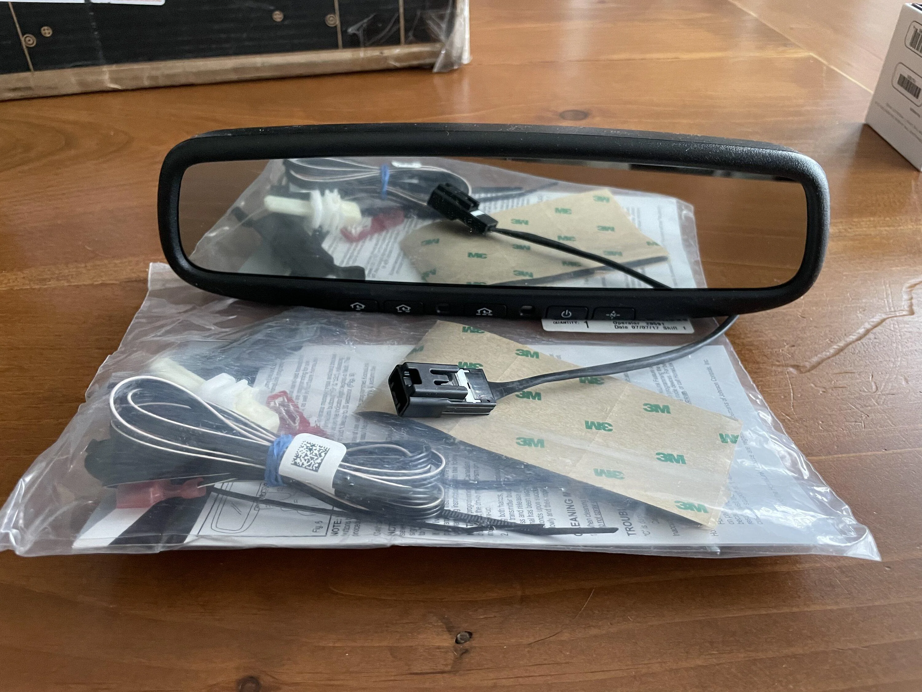

There are some very nice 3M sticky backed thin foam pads in the box I could not figure out what they were intended for (maybe something on a Kia) but I have found some very handy uses for them around the maverick. I lined out the bare spots in the sunglasses holder where Ford did not, and also used them to make my glovebox organizer completely slop (and rattle) free.

I ordered mine last week from KiaAutoParts.com (part# A7062-ADUP1 ) for $12.59 and it arrived quickly.

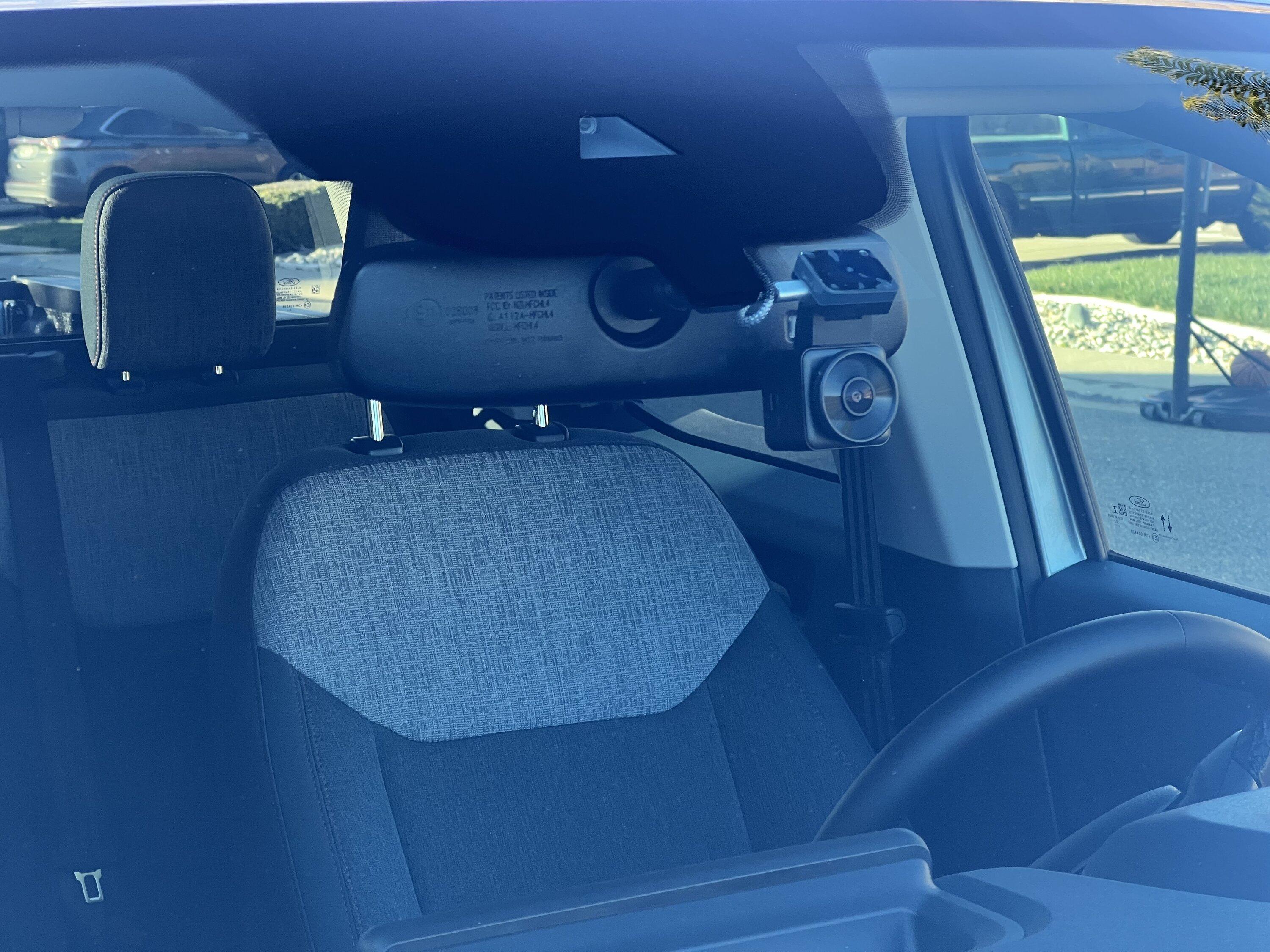

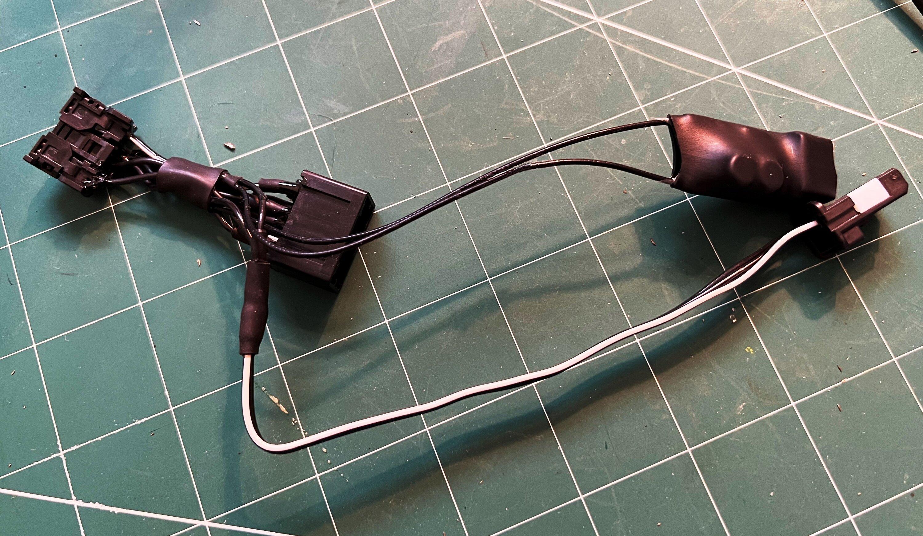

I also ordered some appropriate Molex connectors from Mouser to make an inline harness with the factory camera, and also wired in a heavy duty 12v to 5v USB converter for a dashcam into the same harness. I don't like tapping into factory wires if I don't have to, and this makes the installation completely reversible if needed.

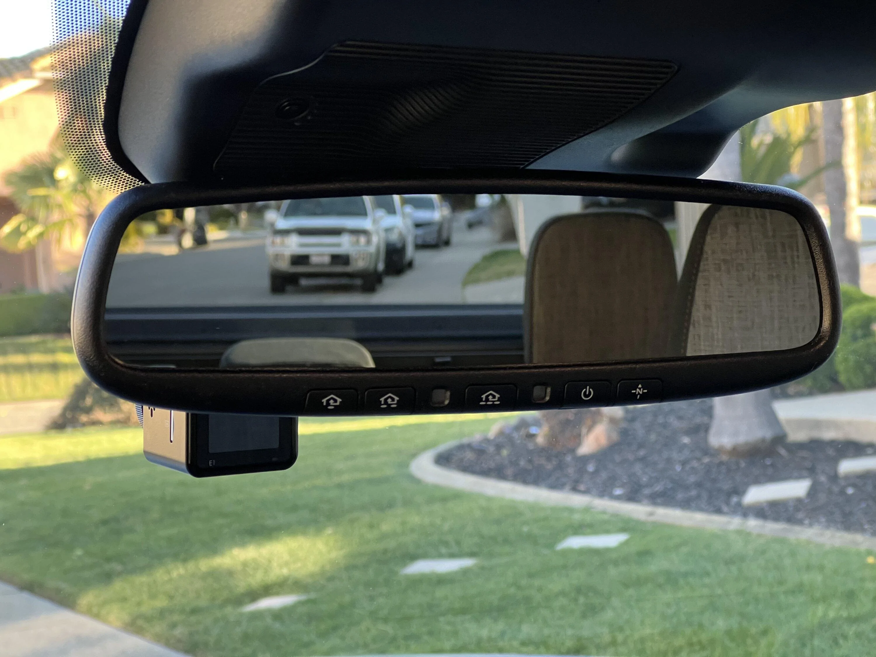

The mirror is awesome, works perfectly and looks like it came from the factory. I wired both power wires for the mirror to the ignition (key on) line for the factory camera, because I don't use Homelink and even if I did I would not mind it only working with the key on.

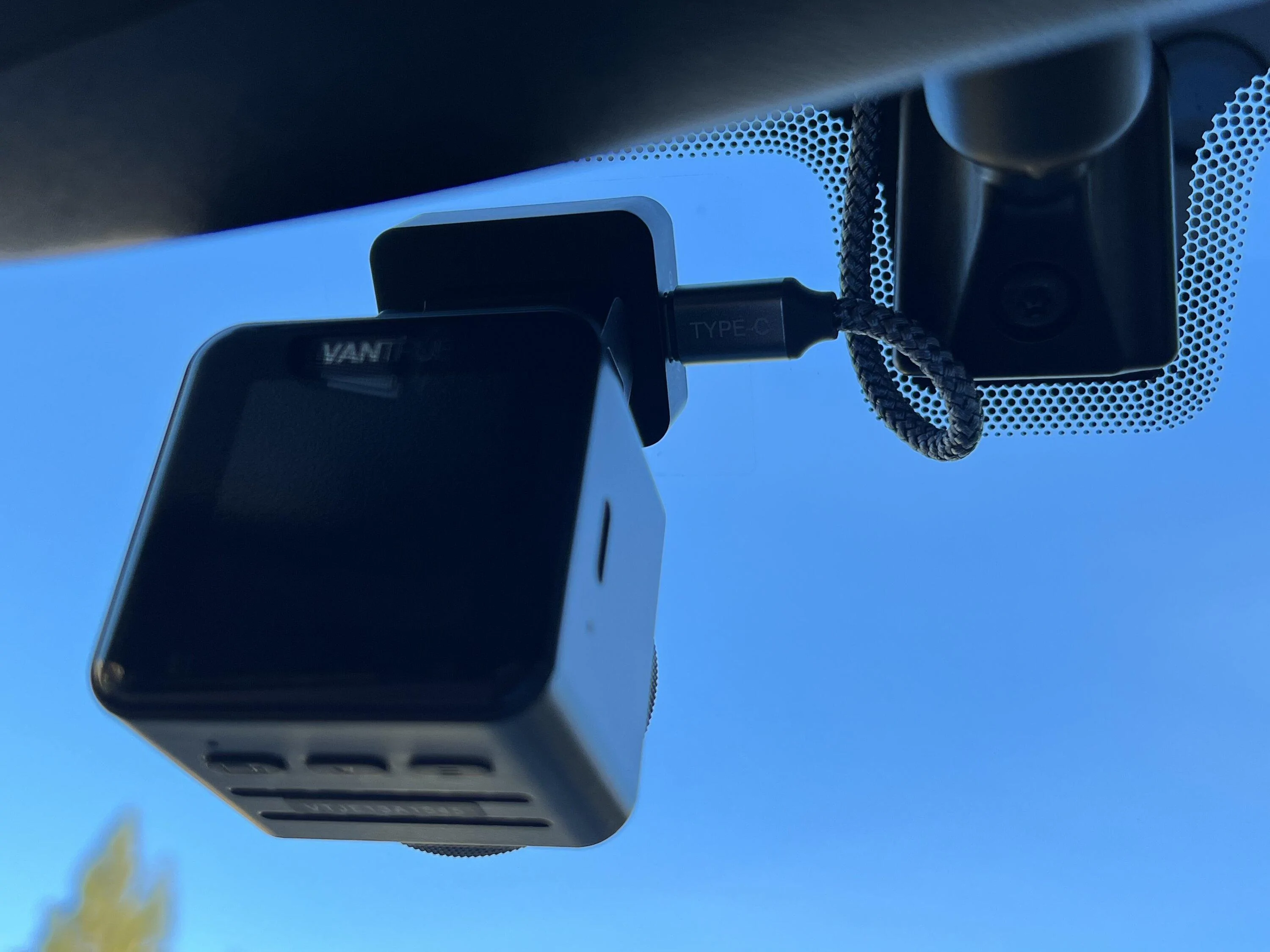

I use the Vantrue E1 2.5k dashcam in several cars and I love the small size and excellent image quality.

34824-0124 (you need one)
34825-0124 (you need one)
560023-0423 (you need six, but order about 20 in case you need to re-do any - you might flub a crimp or apply too much solder etc and have to redo)
I would order two of the connectors each and 20-30 of the terminals. These parts are cheap and ordering extras does not change the shipping price. Worse case you can make a harness for a friend.
I already had a special Molex terminal crimp tool that surprisingly would handle these small connectors, but I still hit them with a dab of solder. If you don't have a crimp tool it will be fine
For the wires needed to make the pass through, I found that the long power wire harness that came with the mirror had the perfect wire for these terminals! The insulation on this wire was also perfect and allowed full insertion of the terminals into the connector, with insulation right up to the terminal, where other wire I was trying had too large insulation. I have also seen pics of other folk's harnesses who could not get the wire into the connector properly (ie, with insulation going into the connector) and had to just cut the insulation back farther so it would not interfere with insertion. This works but is not optimal.
The power harness that comes with the mirror is so long and you will not need much of it, so there is *plenty* of extra wire there to make your pass through connector.

No, you can just splice into the power wires as a dirty way to do it, but using these connectors you can build a harness with no splice connectors, taping, or soildering wires from the mirror wires to the power wires in the truck.

As noted by the previous poster, you will not need these or any extra parts. These just allow for a cleaner installation that preserves the original wiring without splicing or tapping them, and also makes it easier & cleaner to add something else like a USB power supply for a dashcam. With an inline harness the install is completely reversible like nothing ever happened, should you ever have to remove it for any reason.
However these connectors are for wiring to the front collision cam, which only provides power when the key is on. Some people may want to wire to the dome light instead for constant power to the homelink so they may not be for everybody anyway...
