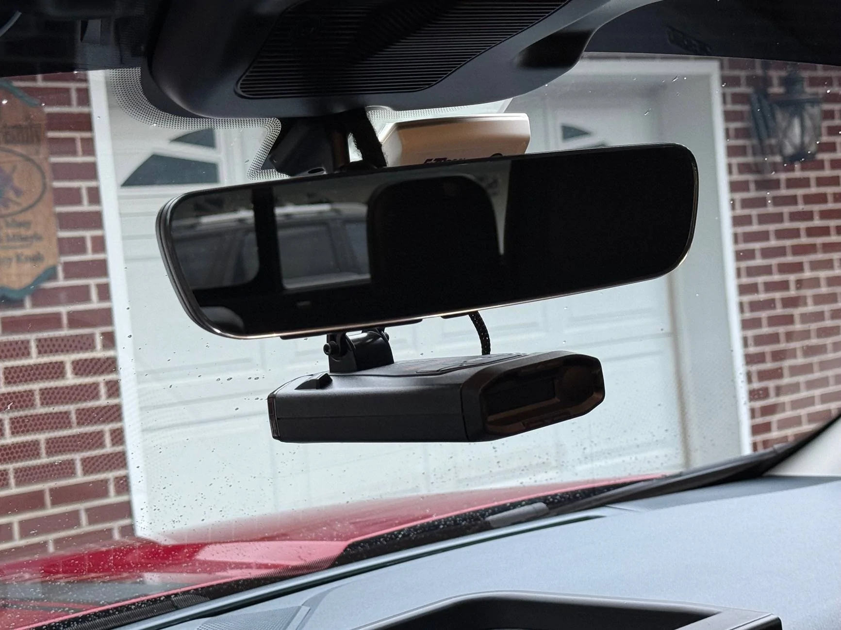

Installed auto-dimming HomeLink mirror
MadDog304
Michael
Jan 25, 2025
45
162
WV
2025 Maverick
So I ordered the frameless Home link mirror from bobsmirrors.com. Totally pleased with this purchase. I really miss the auto dimming mirror and the Homelink buttons. While at it, they installed a blend mount and wired up for my radar detector.

So they added a usb-c connector to the auto dimming cable that's included with mirror? And if so will it do the park mode for dashcam
