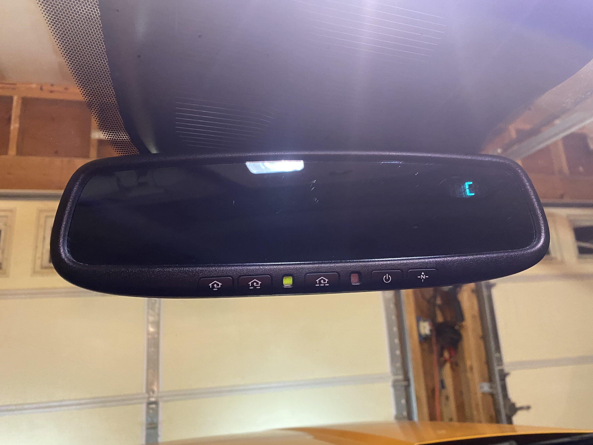

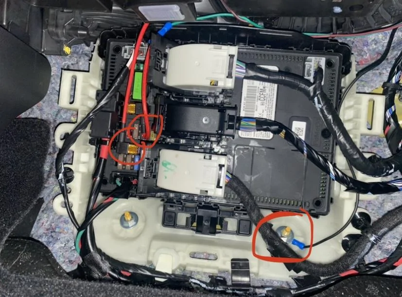

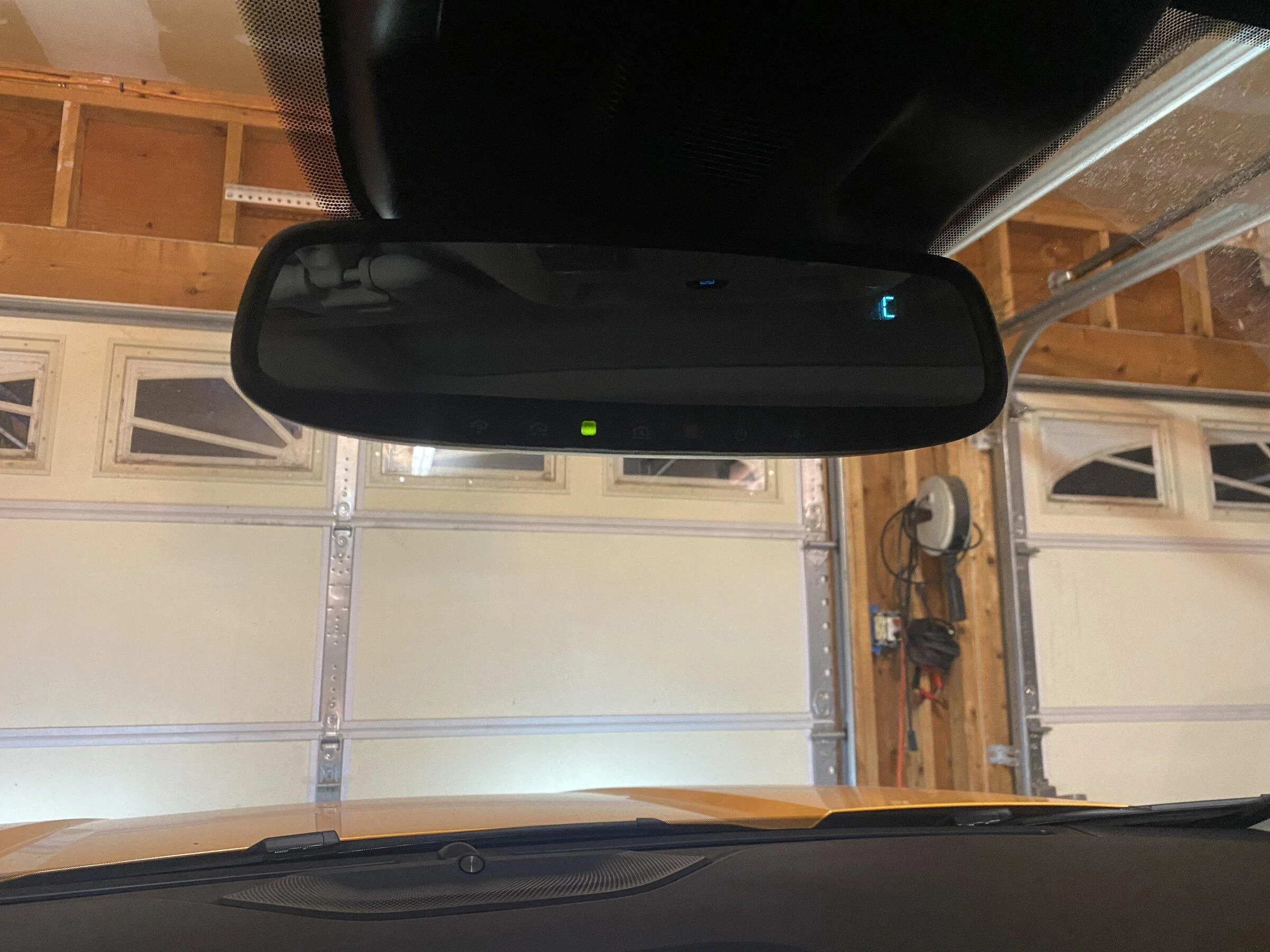

Just finished up installing my auto-dimming mirror. Unfortunately I jumped the gun and ordered mine used off eBay a few days before someone found the cheap Kia mirror online but oh well. Was just under $60 shipped. Has auto dim, homelink, and a hidden compass as a bonus.
For power I ran 3 wires from the mirror down to the fuse box in the passenger footwell. For switched power I tapped into the #3 slot, and for constant I tapped into the #20 slot. For the ground I just used a ring terminal and put it on the bolt holding down the fuse panel.
I personally wanted my homelink to be on a constant circuit. I know some say someone can break into your car and open your garage but I park in the garage when Im home anyways. If you want to you can wire both of them to circuit 3 and only need to use one fuse tap.
Homelink is programmed and works perfectly as does the auto dimming feature. Just need to calibrate the compass and all will be good to go.

Hey, thanks for the detail on installation. How does the size compare to the stock mirror? Also, how about running the wire down to the box? Did you just stuff it along the windshield and down through the back of the dash? How tough was that?
It’s slightly taller but not by much. Yes just tucked it above the headliner. And had to remove the a pillar trim and the side dash panel. Not terrible to do just have to be careful with the cheap plastic clips. They break easily.

So you're saying you used the stock arm and just unscrewed the mirror and screwed the new one back into the stock arm?
No the arm stays with the mirror. Loosen screw. Slide off old mirror, slide on new one, tighten.
