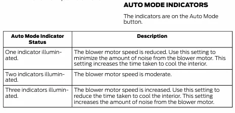

I can't speak to the MY25+, but for MY22-24 the 3 settings for Auto set the maximum fan speed to low, moderate or high. These three settings are made with the Auto mode button, not the fan control. I would think that the MY25+ plus would be similar, but don't crucify me if I'm wrong. ;)
Ford Maverick Auto AC is weak when it is hot outside 1776784994596-1j

Modern HVAC in cars give some control of freedom of the fan speed. I’m not sure is if figured out the logic, like the fan speed you set is the max allowed, because it’s not quite that either, but bottom line it you may need to leave it on AUTO but increase the fan speed a little (AUTO is not cancelled when you do this, you will notice, which is new compared to older vehicles).
Other difference with pre-25MY - if you adjust fan speed it kicks it out of Auto.
But to the manual image posted above - Auto has 3 selection ranges of fan speed.
