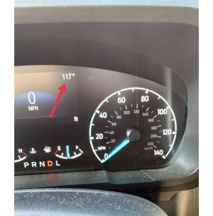

You will never see 40 degree air. A mechanic/ac expert told me once the best you can hope for is 15 degrees below ambient air. So 80 outside, 65 coldest at vents. I don't know if he was correct. Please remember the temp setting is NOT the temp the vent air will be. It is just like a house thermostat. It will heat or cool to that temperature if it can.
I don't think, if I were you, I would return to that mechanic/ac expert.
Looking at it logically and realistically the expert doesn't make sense.
The picture below shows 117° outside. If what the expert told you was true. The interior air would only be blowing between 95 and 100°. 😱
I can assure you that didn't happen. I was very comfortable at 72°

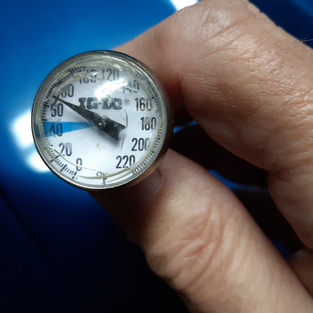

Even my thermometer shows the proper range for AC air.
