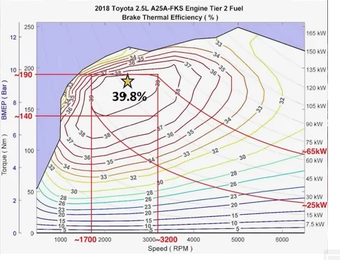

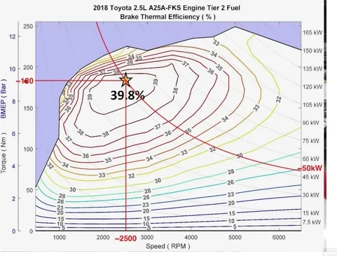

From the video - so depending on how close the Ford 2.5 is to the Toyota 2.5.
I looked for this BTE chart awhile back for Ford's engine - perhaps it exists now or I just didn't search well.
Ford Maverick How the eCVT in the Hybrid works 1780684358428-ry
Ford Maverick How the eCVT in the Hybrid works 1780684433248-a9
140 - 180 - 190 Nm = 103 - 133 - 140 lb-ft torque
RPM 1700 - 2500 - 3200
HP 33 - 63 - 85
kW 25 - 50 - 65
