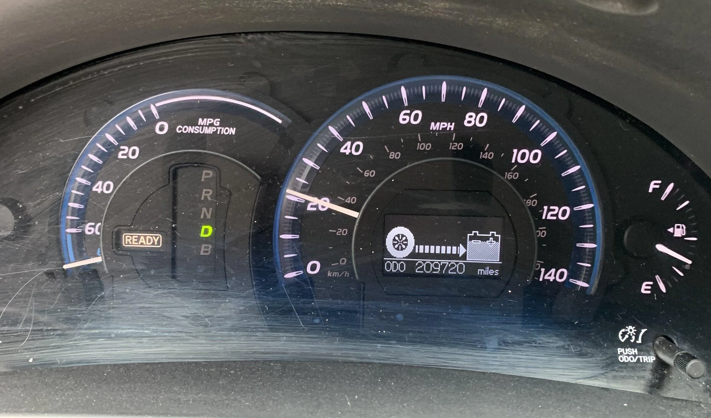

Even the Prius you have sounds different. There was no "L" in the 2007-2011 Camry Hybrid. Unless you opted for the Nav screen, this was the monitor for battery info. The Hybrid vehicles have come a long way since then. 😁
Ford Maverick eCVT is amazing! Camhybrid
Just to clarify, when off throttle on a downhill or not the system in these could shutdown the gas motor, and just let it spin freely, but at any speed over 40MPH it would not go into EV section of the gauge, it had to spin the ICE (no fuel used though) or the Sun gear in MG1 would spin too fast and get damaged. I think that's less of an issue for modern Hybrids, but not sure.
My Prius is the latest version sold starting in 2016. I believe its transmission is very close in design to the Maverick. Since 2016 I have easily gone into EV mode going slightly downhill at highway speeds, I think I have been over 60+mph many times. I have heard (not sure if a fact) that Toyota and Ford put their heads together and designed the latest version then they parted company. In actual use, I feel the Toyota and Ford eCVT's work about the same when driving. Your Camry has a different generation CVT than my Prius for sure and that your gas engine is probably more powerful so the programming would be different.
