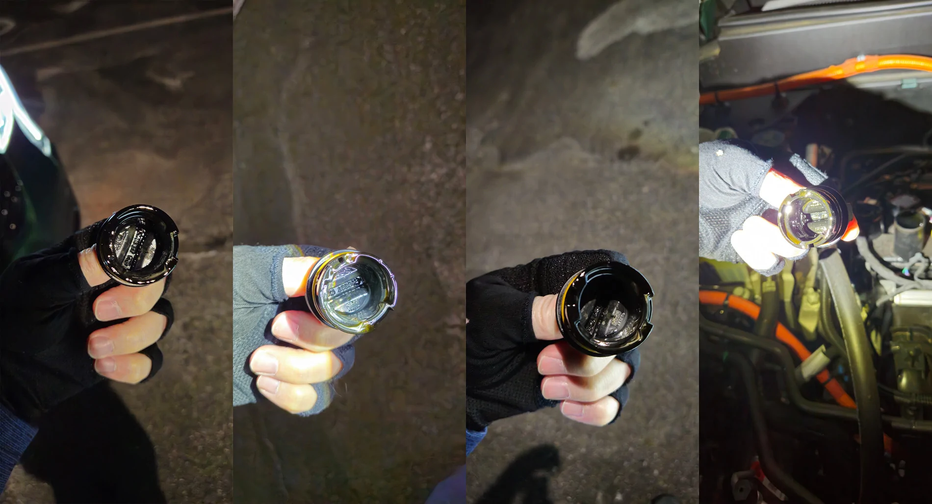

I used to see this on my 02 jetta VR6 later in my ownership of it because my commute to work went from 20 miles to about 5 miles so the car was barely warmed up by the time I got to work. freaked me out until I found out what it was.Common issue. Water will condense at the coldest point, which would be the oil cap. If you see the same on the dipstick or during an oil drain/change, THEN you have problems.
