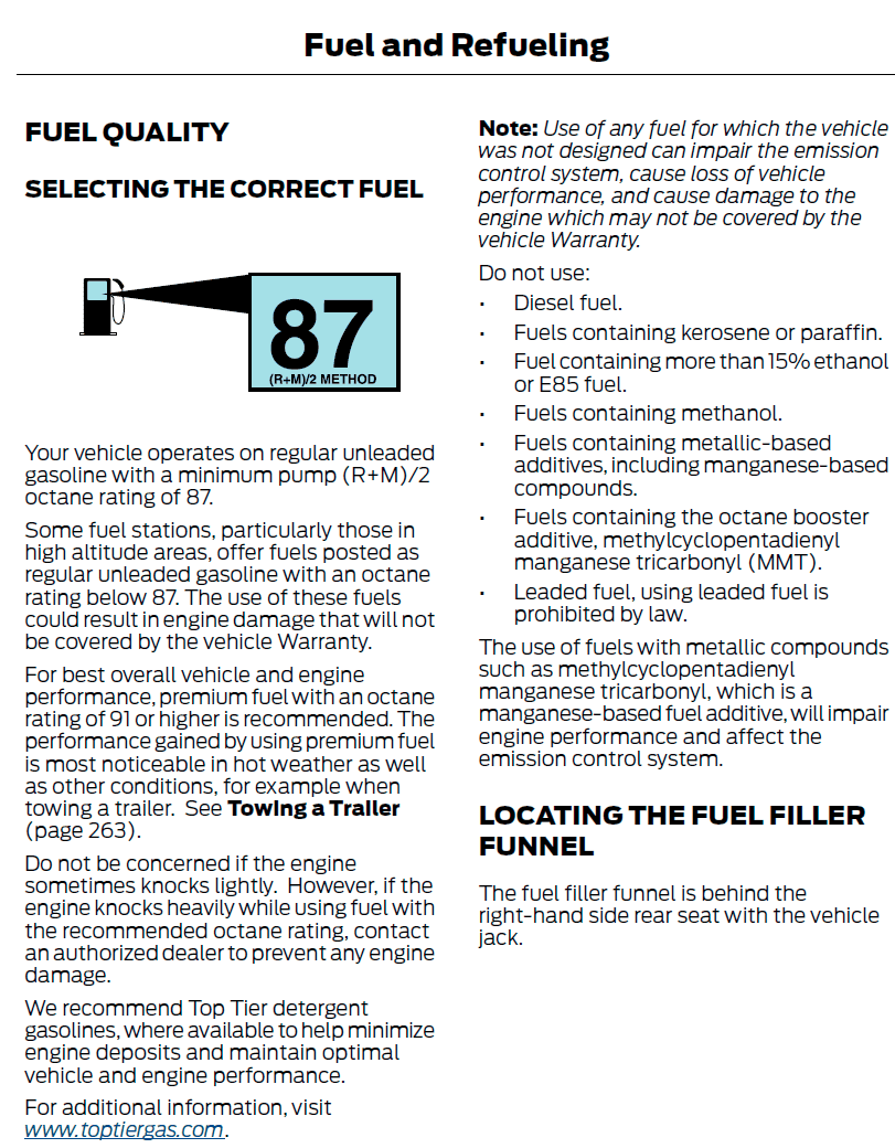

Not reading thru 7 pages.......
My plan is use 87 Octane fuel.
How much better would pure gas be vs. the Ethanol mixed variety??

Sorry no link but Google July 2019 Car and Driver regular gas vs premium. They tested 3 cars and a Ford 150 using both grades. One of the cars was a BMW M5 and another was a Dodge Charger. Net was don’t waste your money on premium except for the Ford F150.
I rarely use anything but 87 in my 2015 3.5L EB F150, and I’ve averaged right around 20MPG over the 81k miles on it. That’s running snows/studded snows in the winter, with extra weight on the rear axle, and sometimes full of wood or hauling an L-series tractor. The only exception is when hauling, when I sometimes put 91 octane ethanol free in it.

So whats the verdict on 87 octane v. Premium? Which is it? My 2017 Kia Niro hybrid runs perfectly now for 5 yrs and it has only used 87. I was told to use only 87 at time of purchase.

That's every car forum, unfortunately. Even the Ford guy from the KS dealer said something like "premium gives you better fuel economy" in one of his videos, even though that is not a blanket truth for all - or even most - cars.
Our G70 has a 2.0T GDI with 255hp. The G70 says "premium recommended" but there is zero difference. We've tried. There is no detectable difference in performance or MPG with premium, but there is a detectable and significant increase in cost per fill up.
Most named brand premium fuel has 2-3 times the additive package of the lower octane grades, which obviously helps mitigate potential carbon/sludge and injector problems. If you are dead set against an occasional premium fill-up, please consider a good fuel additive added every 3-4 tank fulls. Chevron Techron is considered one of the best.
