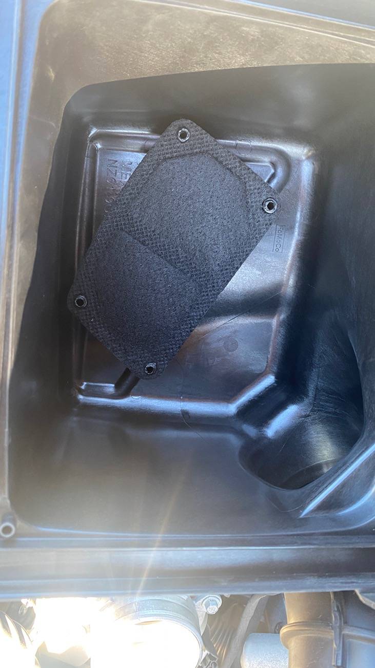

Any idea what is attached to the inside of the air filter cover?
I changed my first air filter today and noticed this.

Carbon filter perhaps??? Just a educated guess.
The Hybrid engine does not run all the time. It is a carbon filter to keep fumes from escaping??
One of the things they have to do with a hybrid? Like pressurizing the tank.

Whatever it is, I wonder if it is serviceable.
It is attached by a few rivets. Should I be concerned it might fall off and fly directly into my engine sooner or later ? Will it be a good idea to take it off once the warranty expires?

"The intake air system provides clean air to the engine, optimizes airflow, and reduces unwanted induction noise. The intake air system consists of an air cleaner assembly, resonator assemblies, and hoses. Some vehicles use a hydrocarbon filter trap to help reduce emissions by preventing fuel vapor from escaping into the atmosphere from the intake when the engine is OFF. It is typically located inside the intake air system. The hydrocarbon trap is part of the EVAP system."

Mine is the same. If you gently touch it it has beads inside. Similar idea to oxygen scavenger packets in some food packages. Fun fact: Dole pineapple and pineapple juice always comes in steel cans, not aluminum and generally not plastic. They want oxygen in the can to react with the iron in the steel and leave the juice alone. It's worked for 100 years.

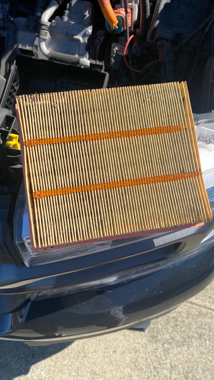

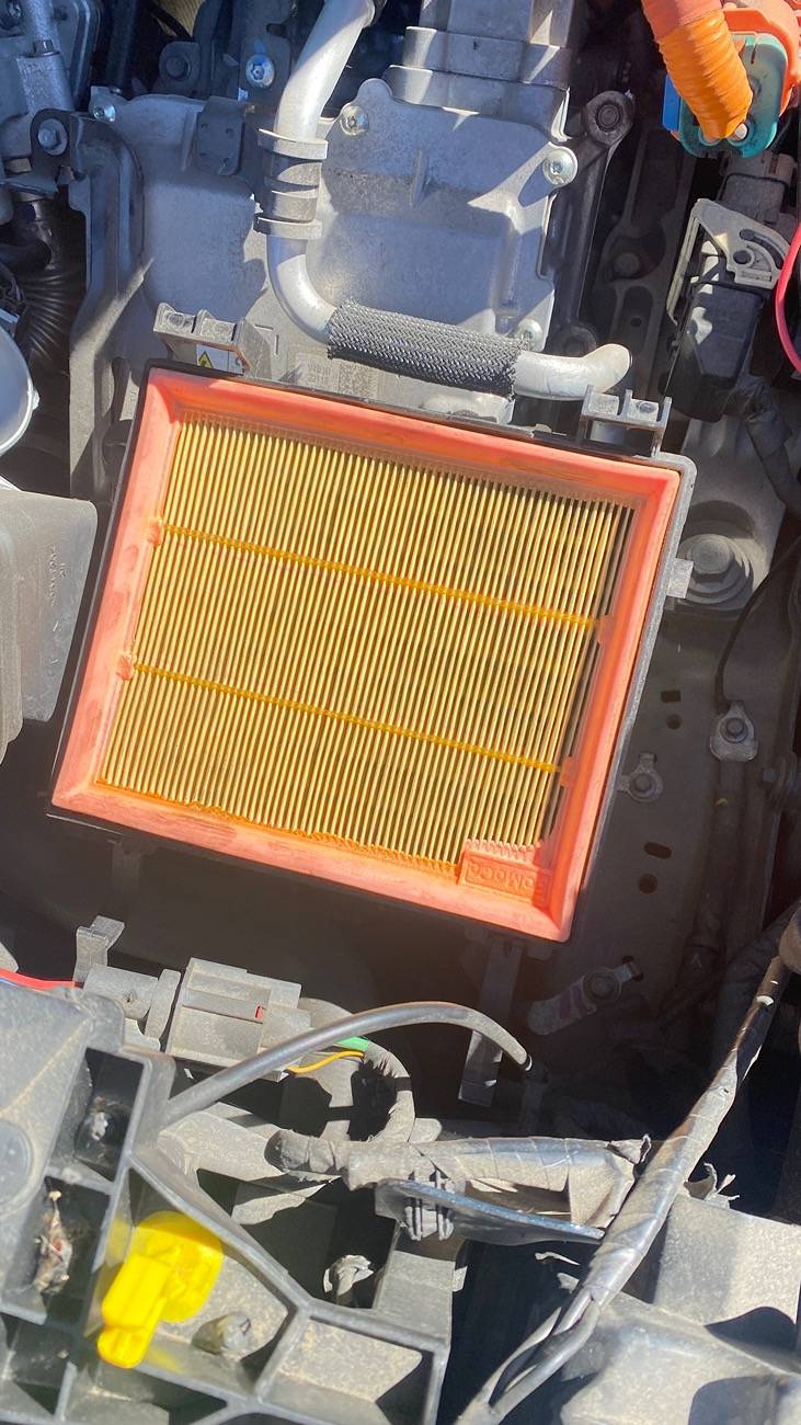

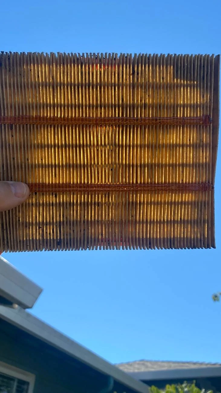

Almost 30,000 miles on this filter: engine side:
Ford Maverick Air filter cover. 2.5 L engine. IMG_1363
Street side:
Ford Maverick Air filter cover. 2.5 L engine. IMG_1364
This puppy is still good.

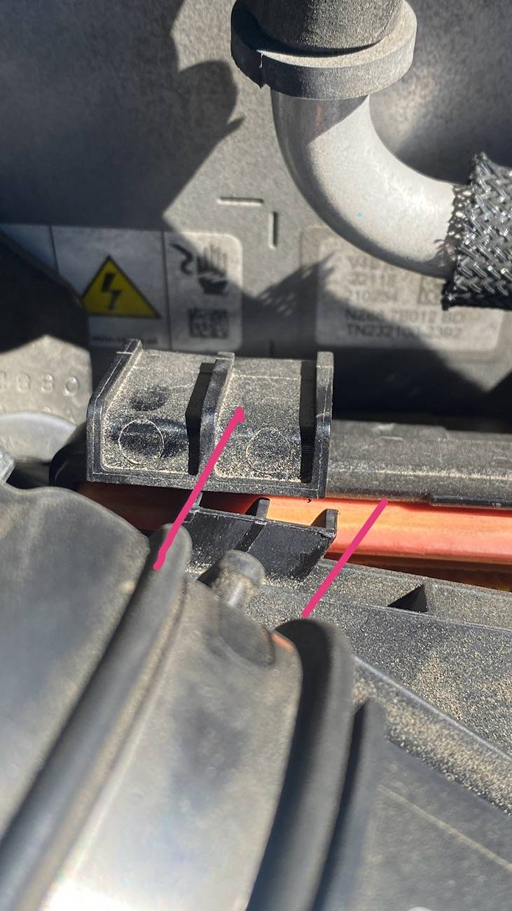

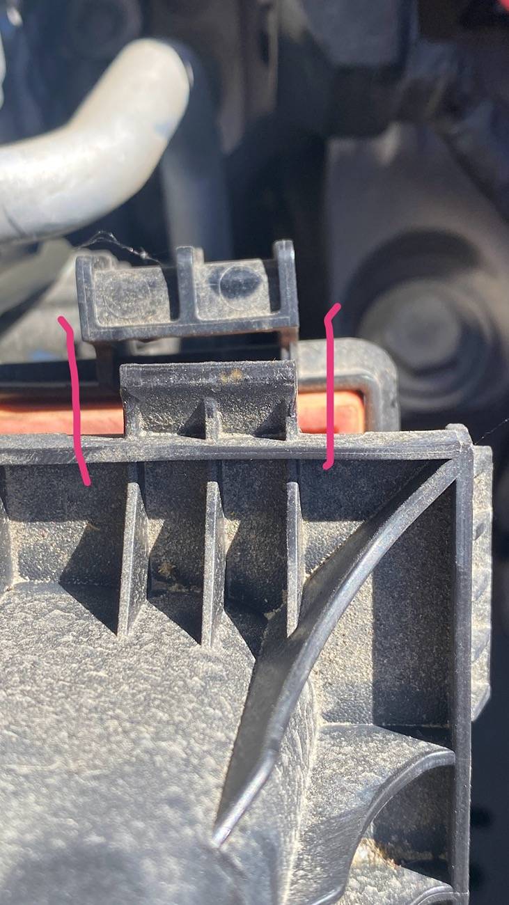

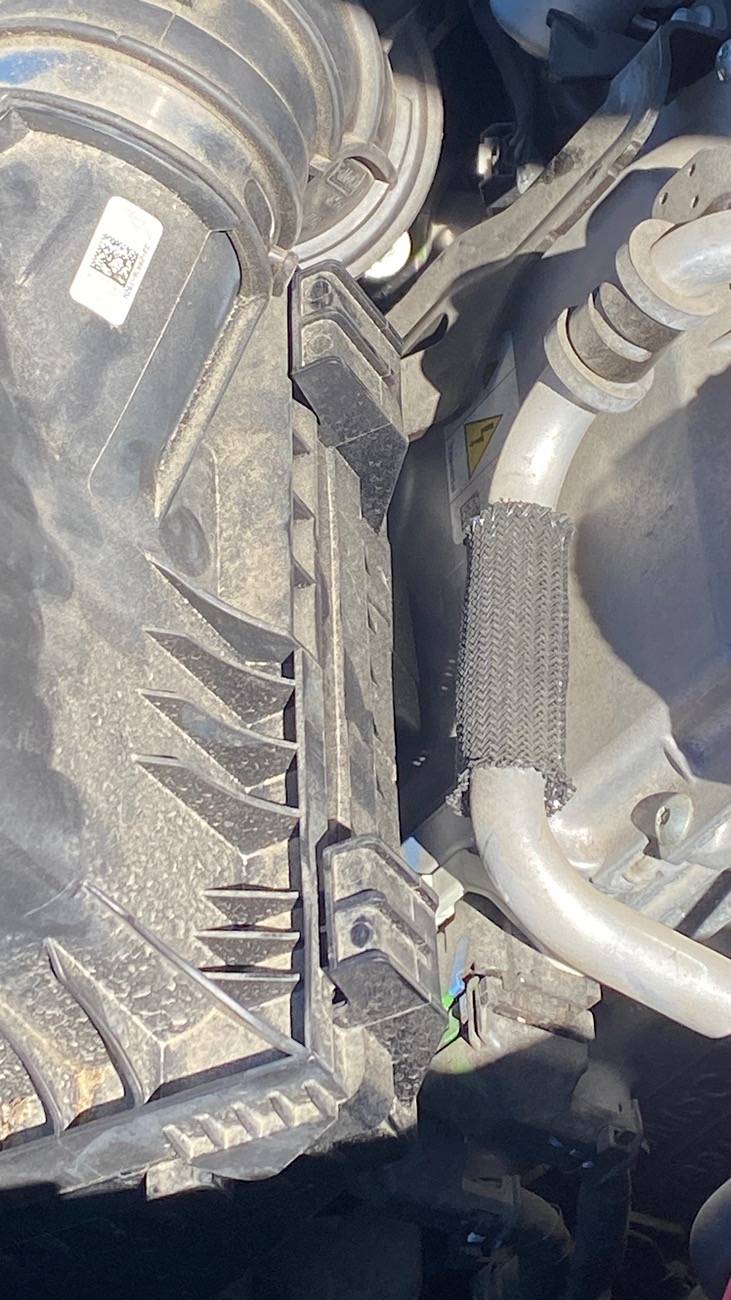

Oddity: Tabs are "square" on the right:
Ford Maverick Air filter cover. 2.5 L engine. IMG_1370
But tabs are at an angle on the left.
Just be aware.
Ford Maverick Air filter cover. 2.5 L engine. IMG_1371
Which looks odd since from the outer case, they both look square.
Ford Maverick Air filter cover. 2.5 L engine. IMG_1372

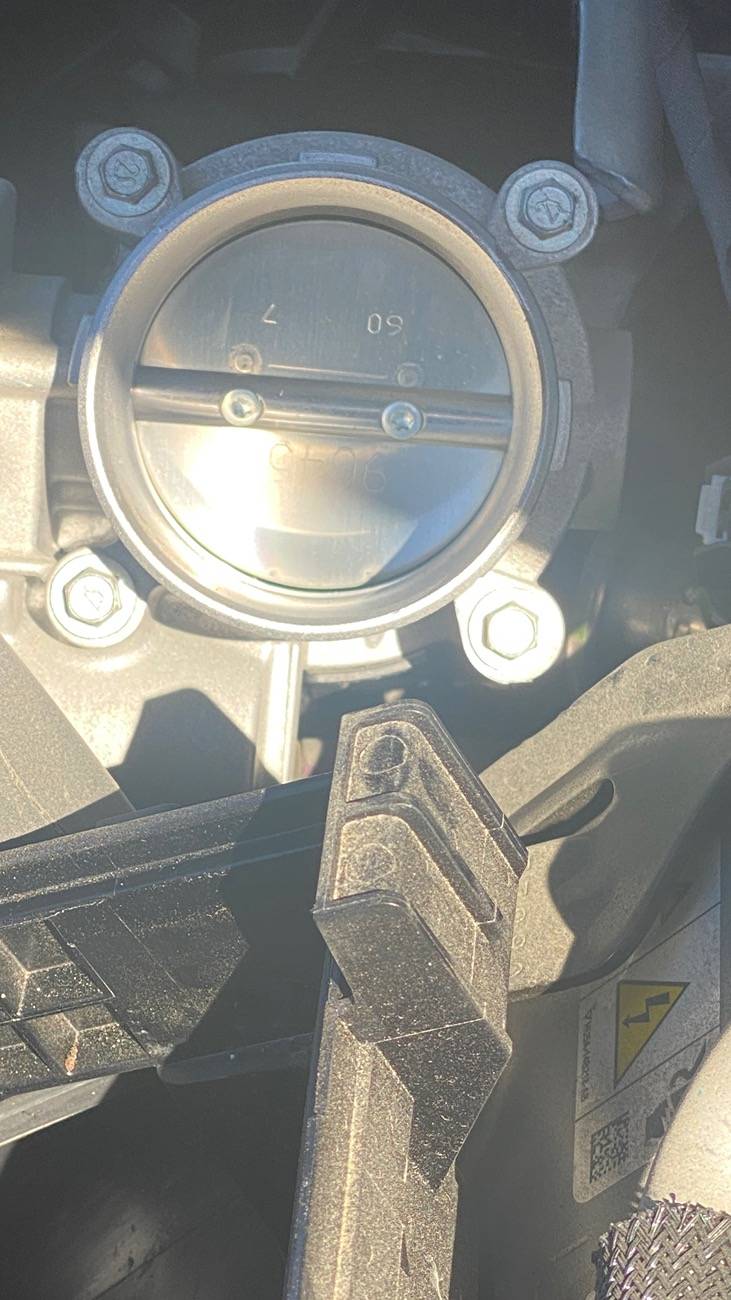

I highly recommend you loosen one hose clamp on the throttle body. Takes 15 seconds and makes life so much easier and you can peek inside.
Ford Maverick Air filter cover. 2.5 L engine. IMG_1368

Look again. It is on the top:lid.
The photo is inverted.
No holes. Air does not pass through it.
It is just an absorber of sorts.
Does seem "insignificant" to me but....
