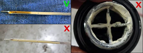

Is this normal and or is there something to worry about....
It is normal given the circumstances (cold weather etc), but it is also normal to worry about it when you see it on your cap. If you have not looked at your cap yet - prepare yourself:)

I had a lexus rx 300 about 15 years ago that I put 245k on. Awesome car. When I asked my mechanic if it was advisable to change the oil and filter every 3K even though I was using Mobil 1 full syn, he said, Yes, because the top end runs hot and you get some foam build up. What he showed me looked just like the pics in this string. I don't know much about engines, but I followed his advice for over 200k with that car and it ran like a top the whole time. Just sayin'.

I've seen this happen under the oil cap of my vehicles during periods of extreme cold. I have a very short commute to work, and the engine doesn't get to full operating temperature until the weekend.
I just do shorter oil change intervals, and all of my vehicles have been fine.
Unlike the op though, my vehicles haven't lost coolant while this is occurring. Op needs to get his vehicle back into the service center ASAP.
This is not uncommon for hybrid vehicles as the engine doesn't warm up fast enough if the trips are short. As I noted before if it is cold enough the PCV valve will be stuck - specially in freezing temps and the condensation (sweat) will not evaporate out of the block (PVC should be check for operation) or simply the engine is not getting hot enough to burn it off.

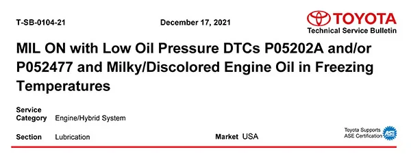

Attached is a TSB from Toyota pointing out this problem on their hybrid models
MC-10252251-9999.pdf
Moisture from blow-by gases condenses and accumulates in the engine oil during short trips in extreme cold weather. When the moisture in the oil freezes, the oil pressure may drop, and the aforementioned warning indicators may display. Figure 2. Engine Oil (Milky/Discolored)
Ford Maverick 2024 Hybrid 2.5 engine milkshake tsb_0104_1
Ford Maverick 2024 Hybrid 2.5 engine milkshake tsb_0104_2
