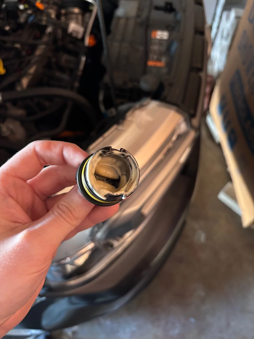

This thread encouraged me to go and look under the cap on my truck as well. I drive ~25 mins to work each way; we’ve had a cold winter here in Michigan this year. Oil changed last November, it probably has ~600 miles on it since then (was at the dealer for a fuel tank issue for about a month.)
When it’s cold out, if you’re running the heat while driving, the heater core pulls so much heat from the cooling system that by the time my drive is over, Im usually halfway warmed up, sometimes 3/4 on the gauge. Not running the heat will make the temp gauge stay higher, but when it’s 12 outside, thats easier said than done.
Other than running in sport mode (which I do sometimes, keeps the engine running unless at a stop light) there’s not much you can do to prevent this happening, unless you go out of your way to take a longer trip.
I’ve not checked under the cap in previous winters but Im sure mine looks like this here there throughout the season for the 4 years I’ve owned it. Wouldn’t think that it has anything to do with a blown head gasket/coolant getting in the system, just condensation from the temperature changes as well as water from the combustion cycle per some other comments in here. This is why the owners manual specifies a particular ford specification to stick to for oil changes, that oil is formulated to combat the long term effects from this.

Oil/water emulsion happens, it could be for different reasons (none of them good). You’ve already found 1 possibility – “At which time I had to refill the engine coolant tank from mid-level. Which was mid-level again by the oil/filter change. Hmmm.” As others have mentioned – cold climate, lots of short-tripping, rarely getting engine up to full temp – yes you can definitely get condensation, exacerbated if your PCV system also has issues.
It’s a very common problem on Kawasaki Mule UTV’s that are started cold/shut off after a short ride and this pattern is repeated frequently. On later models with their ridiculously long dipsticks, many instances of the dipstick rusting to the point they disintegrate.

There is definitely moisture in the oil, the question is where it came from. The fact that the coolant has been low twice is very suspicious, a simple pressure test of the cooling system should tell you if that is the cause. It certainly could be condensation, I had a car that had the same issue, actually worse. It happened in the winter and the car was used for short trips. My mechanic told me to change brands of oil and get it out on the freeway once a week and the problem went away. Once the weather warmed the freeway trips were no longer necessary.

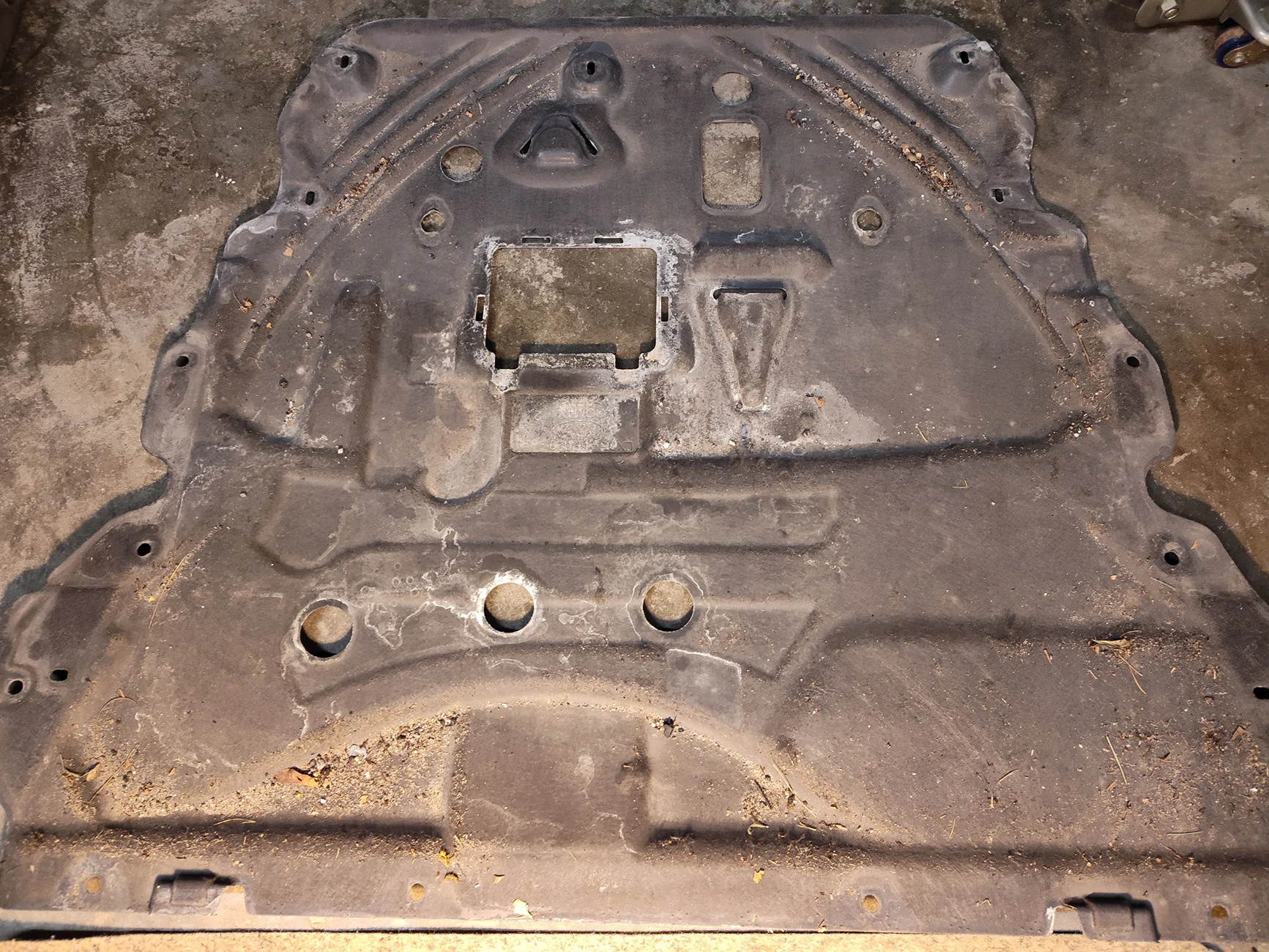

Except a lot of leaks would be helpfully caught by the felt-like under-panel instead of the pavement.

I wanted to confirm drips too - so took a picture of hair cardboard!
Yes - I should have gotten another after I cleaned it off.
Yes - I did clean it off. Not washed off of course, just broomed off.
I don't think any signs but the winter splash up.
And finished my inspection with it off too - no signs of drips elsewhere.

Mine did it at 10,000 miles.
Mine does it at 56,000 miles.
A little bit at 40°F.
A little more at 30°F.
Never much colder than that but there's dozens of posts that the effect is more pronounced the colder you go and the shorter the drive cycles.
One hot cycle and it's gone.
NORMAL.
