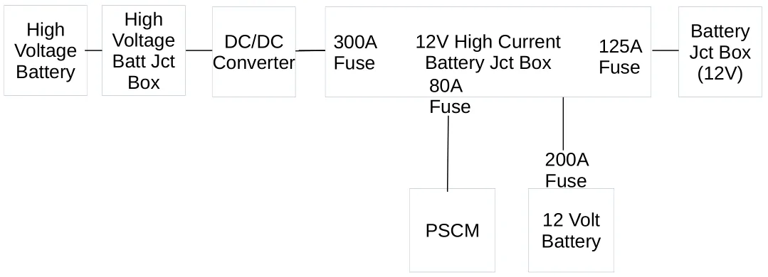

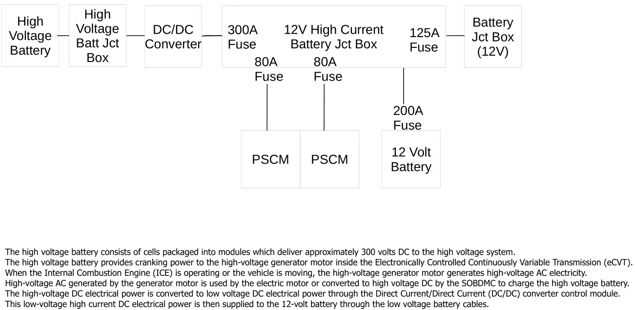

Anyone have any good ideas for tying it to the run/start relay? I assume that the run/start relay itself isn't rated for directly pulling 200A (plus it would be a pain to run heavy gauge wire from)...
I guess I could probably put some kind of microcontroller that monitored the relay state (and possibly the voltage) and controlled the "remote" line of the inverter. Not sure I would trust a random Amazon relay with breaking that high current?
Note:
According to the wiring guide, the DC/DC step-down is rated at 265A and fused at 300A; so I figure it should be relatively safe to pull the full 2000W; especially since if it is at 14.5V then it is only 138A, leaving 127A for everything else.
However, the 12V battery is only fused at 200A. I need to figure out where this fuse is physically located- if the inverter is directly tied to that spare battery post, will it be on the wrong side of that 200A fuse? I'll have to look for it physically, the diagram is no help.
I have attached the high current power distribution diagram, as well as the battery load shed description.

Note:

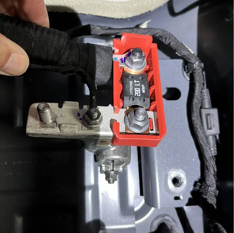

The 200A fuse for hybrid is on the side of the battery post bus.
So the spare stud is fused by this fuse. The cable connected to the fuse runs back to the high current junction box at the bottom of the BJB.
Ford Maverick 2000 Watt Removable Inverter Installation 1746730886003-wo
2022 to 2024 Maverick Hybrid
Ford Maverick 2000 Watt Removable Inverter Installation 1756311192782-e7
2025 Maverick Hybrid:
Ford Maverick 2000 Watt Removable Inverter Installation 1756310943921-x5

The 200A fuse is on the side of battery post bus. So the spare stud is fused by this fuse.
I see. I’d prefer to be on the other side of that fuse, but I guess as long as I add my own 200A fuse to protect the battery it should be fine…
I assume that the 4000W surge rating is with internal capacitors in the inverter, and that it won’t actually try to draw potentially 300A?
Spec sheet recommends fusing it at 250A, assuming worst case 80% efficiency at 2000W that’s 208A at 12V and 192A at 13V? So a little headroom, but not much.
Only worry is that existing fuse would be passing 200A for inverter + charge current of battery…

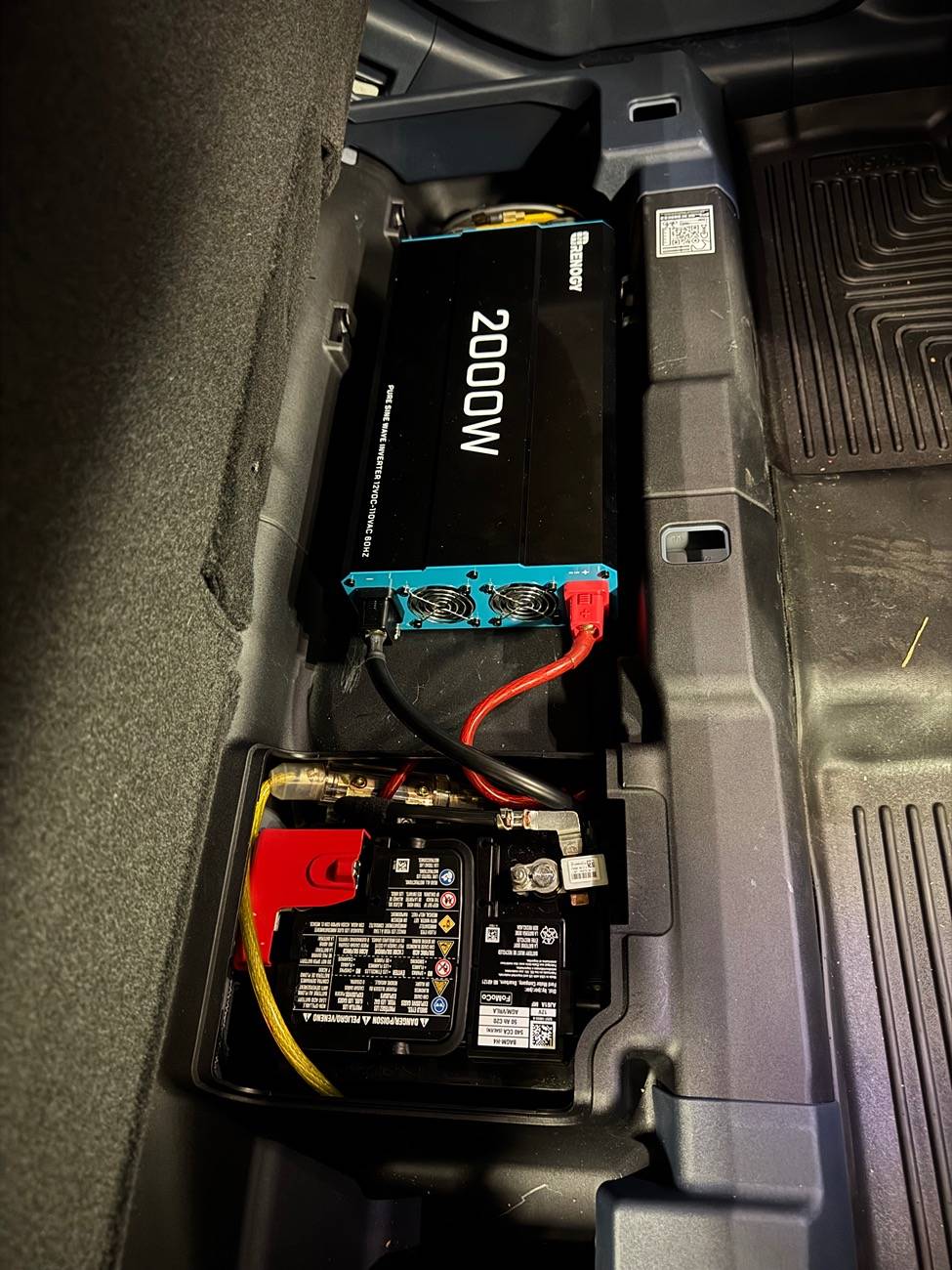

Well, I did it!
Discovered that there were a bunch of brackets behind the seat, and I was feeling lazy, so I just put it beneath.
The positive wire is under spec’d because the proper fuse holder I ordered hasn’t arrived yet, so that’s gauge 4 wire with a gauge 4 fuse holder I had from some old audio gear. Will upgrade to 1/0 before testing full load.
I was able to fit the lug underneath the already occupied post *before* the 200A fuse, so I should be able to safely pull the full 250A. And the poor 12V battery won’t be in any danger.
Ford Maverick 2000 Watt Removable Inverter Installation IMG_1403
