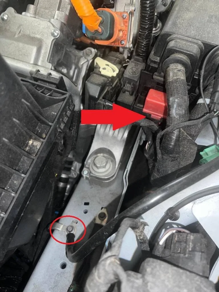

In any case, the main reason that the 12V bus still needs to be able to supply large amounts of power appears to be because the PSCM (Power Steering Control Module) is connected on the 12V bus.
Presumably, if you are idling rather than maxing out the power steering, you should be safe to pull several hundred amps from the 12V bus. I've successfully run a 2000W inverter for hours at a time (with a ~1700W heating load) while idling to no ill effect: I monitored it via OB2-II and the computer was perfectly aware of the consumption and properly commanding the engine to idle more often in order to maintain the high voltage battery level.
