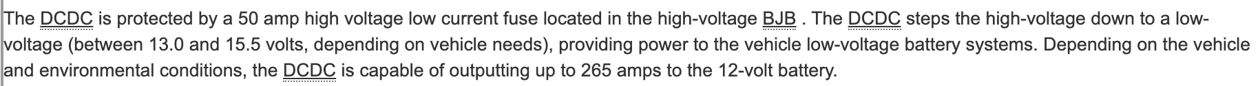

Look guys, I don't know why we're relying on Google AI summaries rather than simply trusting the service manual...
Note that the 50A fuse is a *high voltage* fuse, i.e. 300V*50A=~15kW. And an explicit mention of the 265A number.

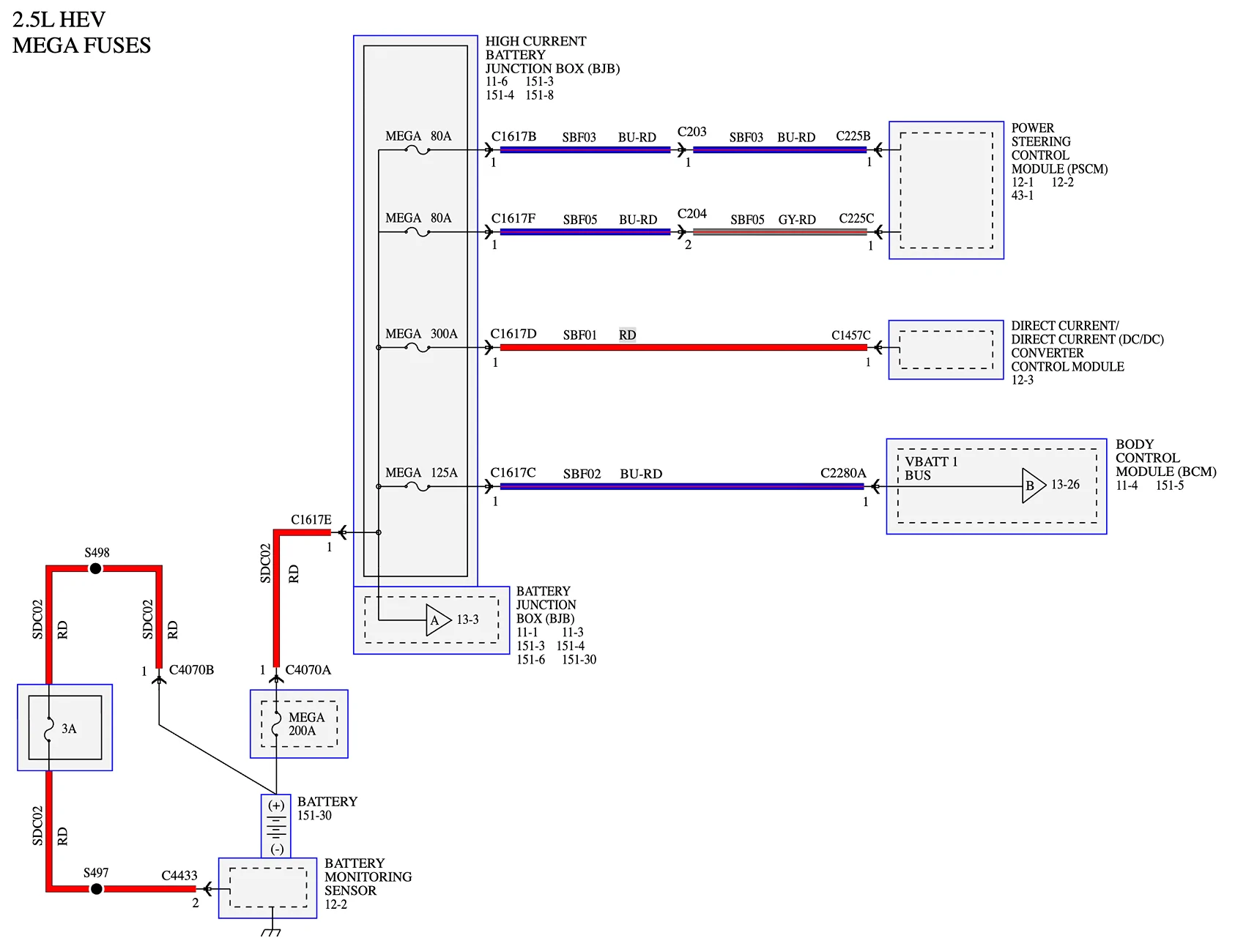

...and I just read a few posts that I hadn't seen. The idea that you could pull 167 12V Amps (2000W) continuously from the hybrid Mav 12V source just is not realistic (to use a mild term).
Please remember (for those who should know, and those who haven't learned it) that P=IV, or more clearly Wattage = Voltage x Amperage, is the operative formula.
An inverter is rated in W output, so 2000W (nominally 15A AC output) requires 167A input at 12V. The DC-DC converter providing 12V from the high-voltage battery in the Mav and its battery management system can't deal with that much 12V current output, certainly for more than a transient peak. You need a battery system to buffer it, and some way to bring in the power to keep the system functional (solar or shore power/transfer switch).
My 22 hybrid 12v buss continuously runs at 15.6v through a 300+ amp fuse with the end with each other feeding the 12v battery through a 200 amp fuse. Tap the 12v buss prior to the 200 amp fuse for an inverter. In any case whatever inverter even a 400 watt has to accept input voltage up to 15.6-16v unless you don't mind intermittent shut off's from over voltage protection. It has been posted that the oem 400 watt inverter is a split phase. So it gains conversion efficiency there. (Think like two 60v ac hots out of phase with each other which can be wired to yield 120v plug similar to way 240v residential is done.) Maybe more later?

In any case, the main reason that the 12V bus still needs to be able to supply large amounts of power appears to be because the PSCM (Power Steering Control Module) is connected on the 12V bus.
Ford Maverick 3000 watt Inverter 2.5L Hybrid Mega Fuses
Presumably, if you are idling rather than maxing out the power steering, you should be safe to pull several hundred amps from the 12V bus. I've successfully run a 2000W inverter for hours at a time (with a ~1700W heating load) while idling to no ill effect: I monitored it via OB2-II and the computer was perfectly aware of the consumption and properly commanding the engine to idle more often in order to maintain the high voltage battery level.
The 12V battery voltage did not decrease, in fact, it ended up being more charged than normal because the bus voltage was always higher due to the DC/DC being constantly commanded to be on. This is similar to the advice to "keep your headlights on" to cause the 12V battery to be charged more (because that also draws enough power to kick on the DC/DC).
Ford appears to have chosen the cheapest 12V battery they possible could have for the hybrid, I imagine the CCA is simply a byproduct of it being a lead-acid battery and not something specifically required.
