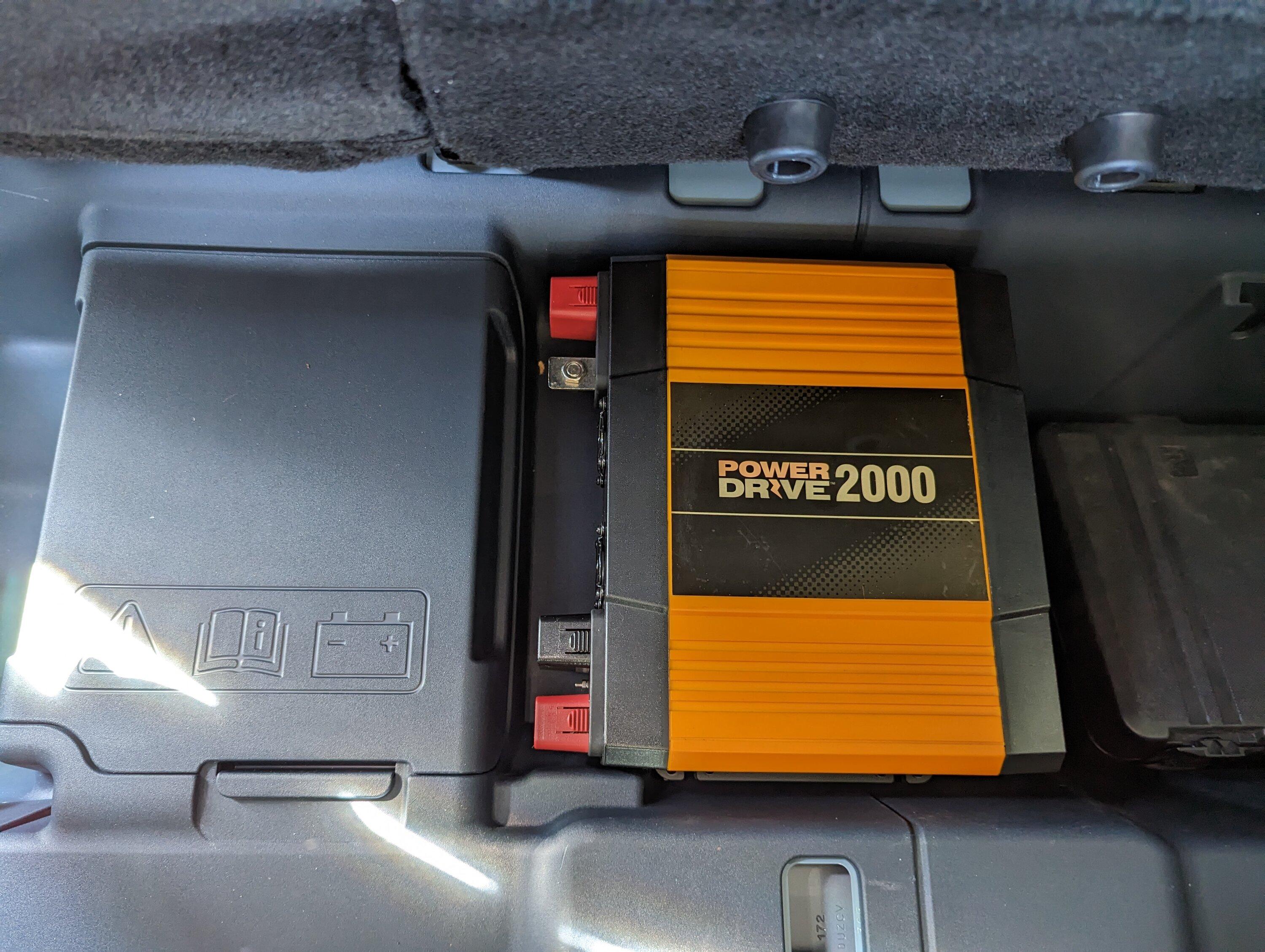

You would need to keep the engine running to use it. It would start the engine and probably keep it running You need to ground to the frame near the battery and not the negative lug. You need to connect after the bms or else the bms will get confused.
The 12vdc battery - polarity lug IS connected to the chassis. So seems you could connect your inverter to battery - lug (which is connected to DC DC converter from 460vdc traction battery) or the chassis & get same result.
If you want an isolated ground for either the 12vdc battery or inverter I believe you would run an inline diode with the polarity set for the direction of electron flow you desire?

Battery negative post goes thru the BMS shunt then to chassis.
Connecting inverter directly to battery negative post bypasses the BMS.
Although Ford's BMS embedded software needs improvement.
