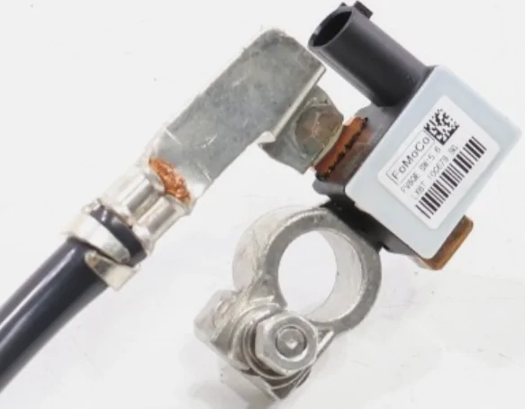

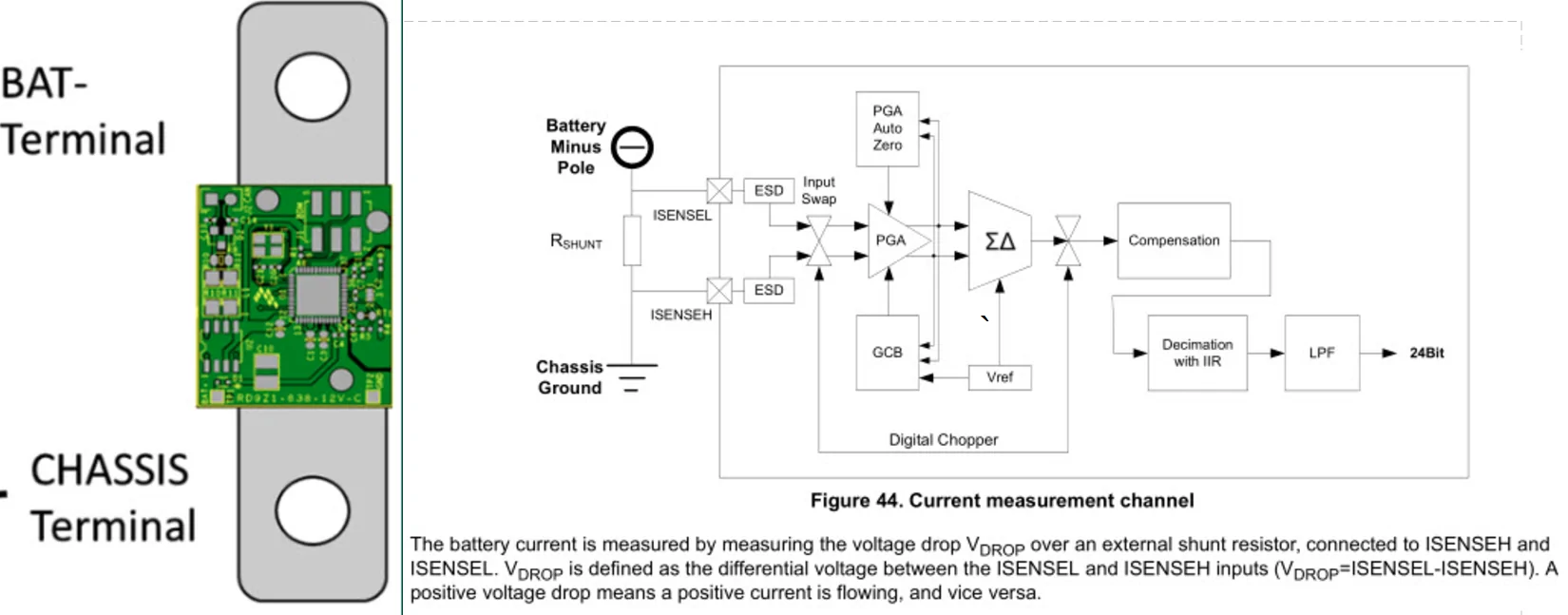

Battery negative post goes thru the BMS shunt then to chassis.
Connecting inverter directly to battery negative post bypasses the BMS.
Although Ford's BMS embedded software needs improvement.
Maverick's BMS + Negative Cable assembly

Example BMS current measuring:
Ford Maverick 2000w inverter 1757516552281-a9

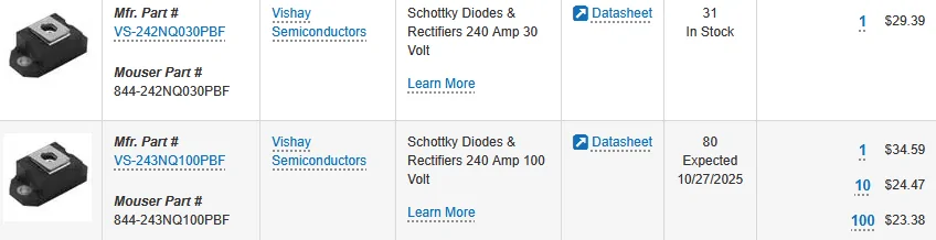

A reverse polarity diode would need high forward amps rating.
Maybe like:
Ford Maverick 2000w inverter 1757516854265-h0
