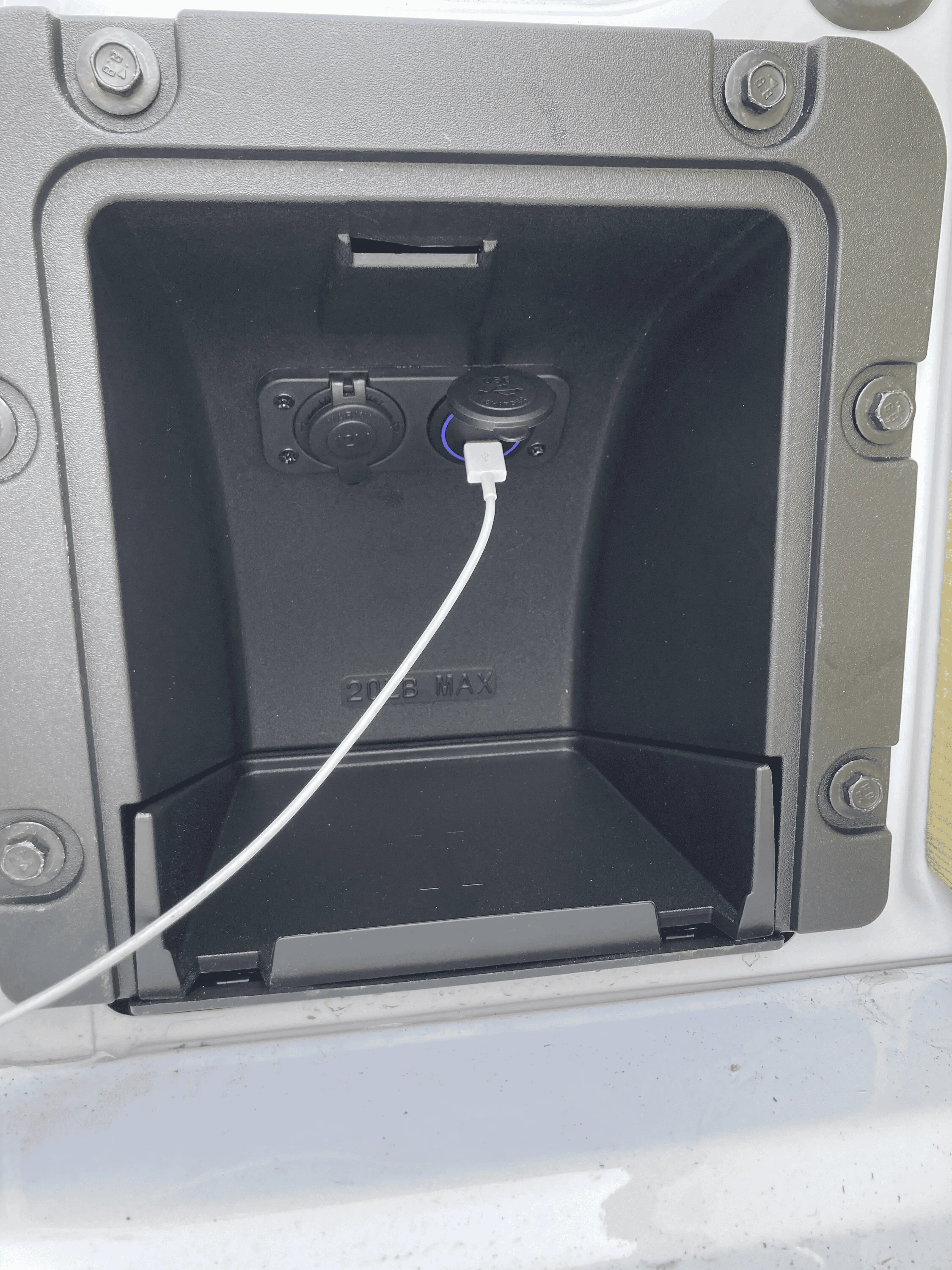

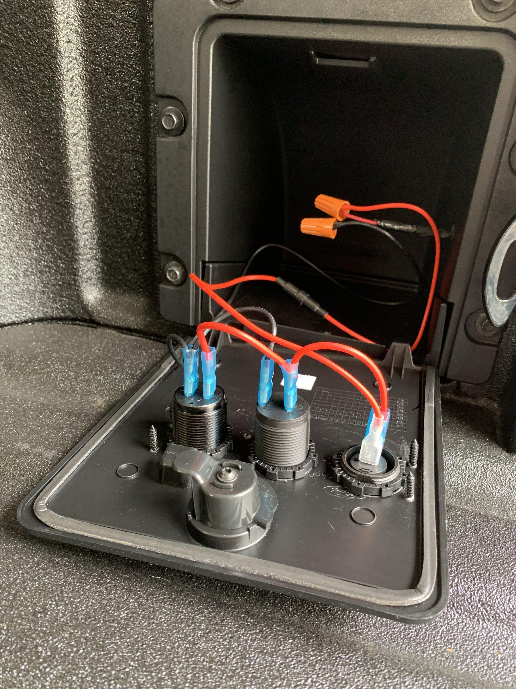

Marine 12v USB jacks and cigarette lighter.
Someone is aging them selves here. I too would call it that only to be told it is now considered a Power Point! Not if you grew up listening for the pop once the lighter got glowing red.
