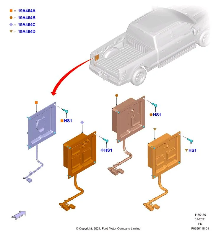

Does anyone know if it would be possible to use the F150 ProPower bed outlet panel in the Maverick?
I assume it is too big, without cutting?
EDIT:
Found the part numbers. Indeed, the F150 panel is significantly wider…

I did attach a handy diagram about the different F150 panels I found.

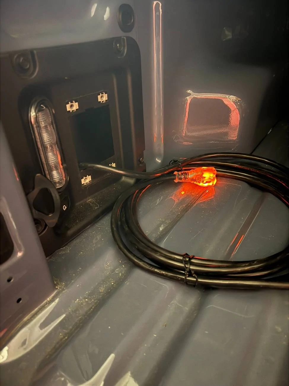

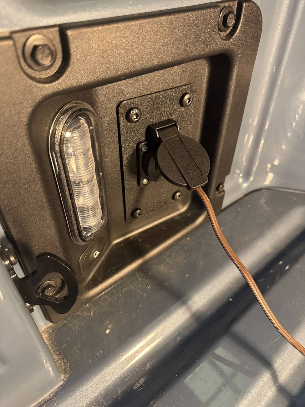

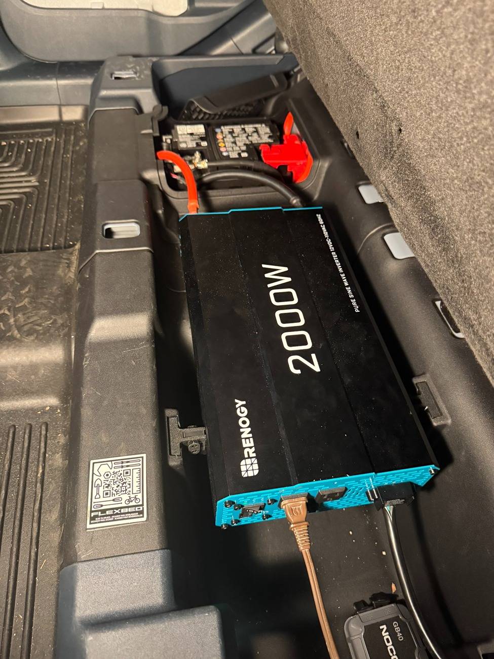

Here is the current iteration of my solution. Used a 3D printed mounting bracket in the FITS slot to hold up the inverter, and a 3D printed faceplate with a socket meant for a generator.
Used a 20amp extension cord with both ends cut off, routed to the bed.
I actually left the original bed outlet connected, just zip-tied up under there; otherwise the interior 400W outlet would not work.
Maybe I should have used a normal outdoor outlet, to get 2 sockets in the bed. But I wasn't sure if it would fit.
Thinking about how I could add a switch + status LEDs to the faceplate.

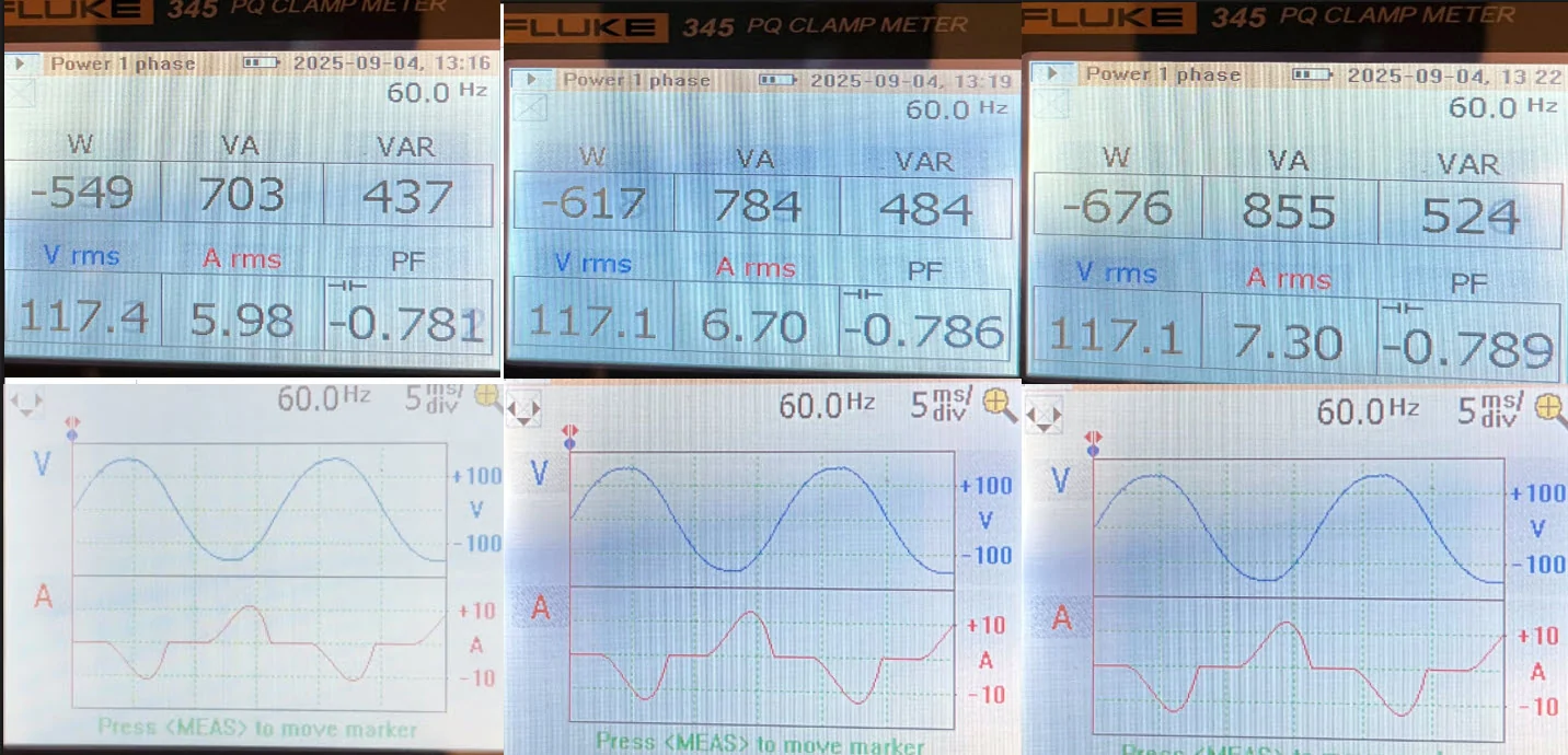

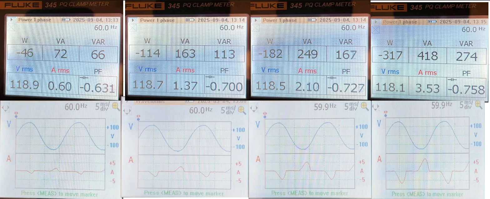

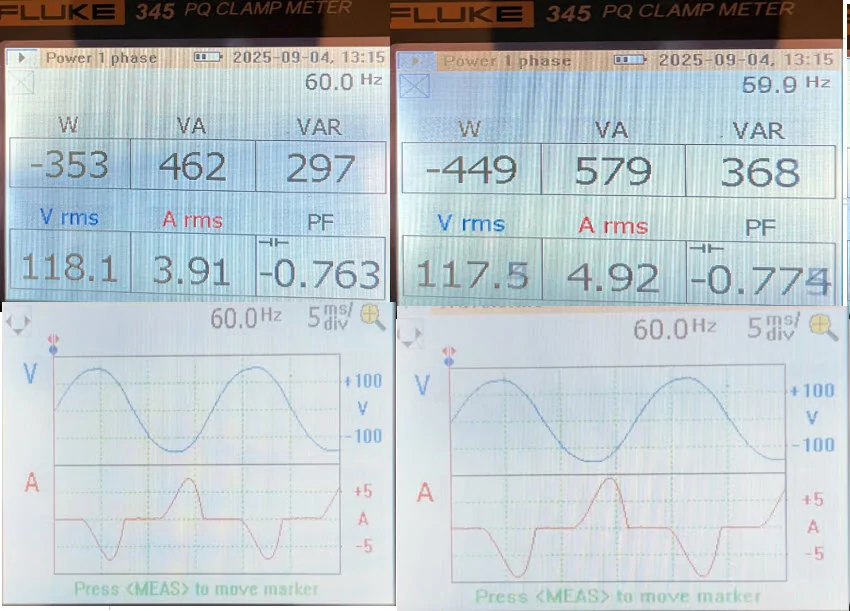

I've got a couple of inverter air conditioners.
LG is 8000 BTU Dual Inverter Air Conditioner. Nameplate Label is 115V, 8.9Amps.
I watched the amps draw after setting to Cool, Fan speed F3.
It starts with fan at .60 Amps for about 2-1/2 minutes then starts compressor and ramps to 7.3 Amps in about 10 minutes.
Ford Maverick 2000 Watt Removable Inverter Installation LG 8K BTU Dual Inverter Cooling Amps Ramp Up -1 2025-09-04
Ford Maverick 2000 Watt Removable Inverter Installation LG 8K BTU Dual Inverter Cooling Amps Ramp Up -2 2025-09-04
Ford Maverick 2000 Watt Removable Inverter Installation LG 8K BTU Dual Inverter Cooling Amps Ramp Up -3 2025-09-04

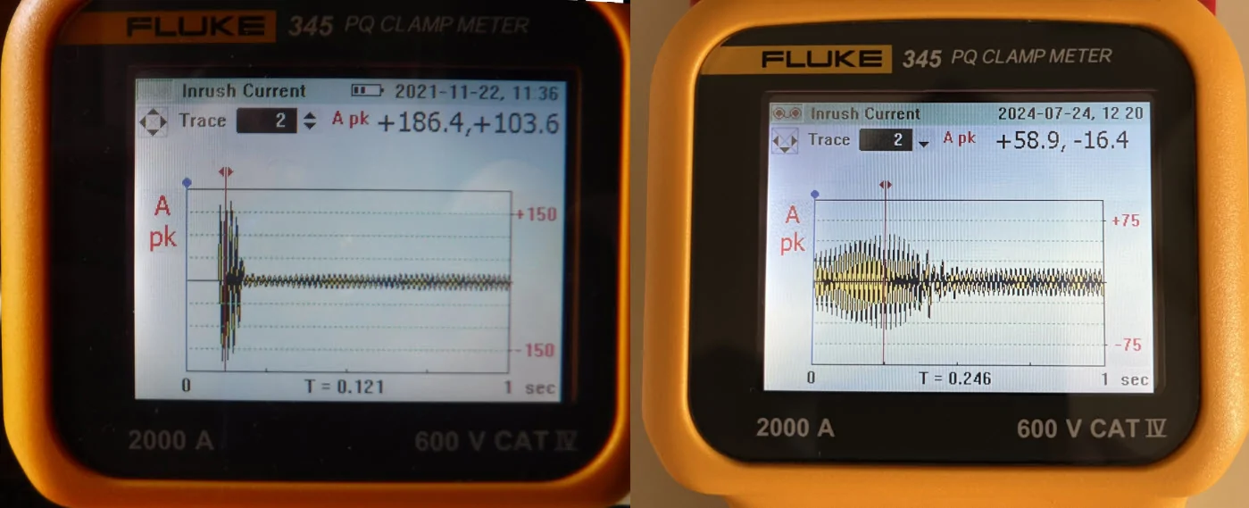

My house 3.5 Ton before and with a softstarter. Inrush Amps in 1st second after compressor start.
Ford Maverick 2000 Watt Removable Inverter Installation Carrier 3.5 Ton Scroll - Inrush Amps Without & With Soft Starter (EasyStart)

I found out my older Xantrex PROwatt 600W inverter I've used in other trucks wouldn't work in my hybrid Maverick. The PROwatt had an Over Voltage Error when the Maverick was Running.
The inverter would only work with the truck Off.
Measured 15.17 volts at the inverter input with the Maverick running.
PROWatt 600 apparently less tolerant than the specs say.
Ford Maverick 2000 Watt Removable Inverter Installation 1769468893376-rj
Renogy 2000W:
Ford Maverick 2000 Watt Removable Inverter Installation 1769468986921-8m
Hooked up the Renogy 2000W used in this thread and it worked fine.
