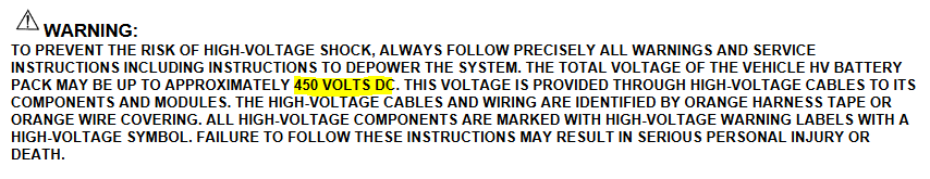

jerrisn I have looked For a AGM Charge controller I only can find MPPT and PMW Both will if set up properly will charge a AGM Battery. I believe the 12 Battery in the Mav is Lead acid so I think I am OK. Since the PMW CC shuts down once 12v is reached. I see no issue. I guess I will find out. The Big Battery in the Mav is 48 Volt the 12 V PMW is way to low to charge it. I should be OK. I am in just the thought mode of this project. Baby Steps after that.
The Hybrid battery voltage is actually closer to 450 volts, as per the documentation for removing the Hybrid battery from the 2022 Maverick, not 48 volts.
